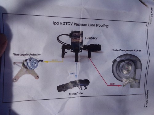

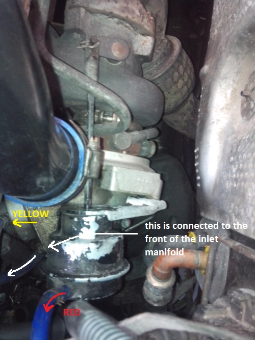

Today I tried to replace the old TCV/BCV with the IPD version. I'm feeling stuipd, but I need your help:
According to the IPD manual the TCV was not connected correctly, see this picture (old setup):
Red: Wastegate
Yellow: Bypass Valve
Blue: Intake
(what I marked as white comes from the bottom of the turbo)
That is wrong? According to the IPD manual and description on the tcv it should be:
Red: Turbo housing
Yellow: Wastegate
Blue: Intake
What I don't get is why is it connected to the bypass valve? shouldn't the red line go somewhere else?
I tried it both ways and it didn't seem to make a difference...
This is my first turbo car, any help is much appreciated!

hmm, according to this diagramm https://www.matthewsvolvosite.com/forums ... 22#p183722
the whole setup is wrong...
Where it the Bypass valve normally connected? In the above picture hose 20 should go to where?

Well I fixed it.
New vacuum hoses and connected them correctly. Set the wastegate. Car now boosts to ~1bar which is 14-15psi. :)
