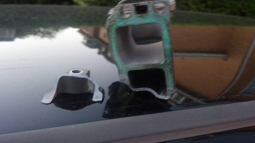

Well here a good reason to quit when your getting tired..
Some how the gasket slipped on the bottom and shifted.. I bolt it down and boom instant cracked thermostat housing..
Off to the pic a part in the am.
