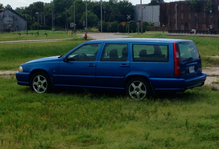

**Jason1102 wrote:You were all right. I went back and asked him if he was absolutely sure he had the timing correct and if he wanted to go back and double check only to get a response of...and I quote..."I don't know what to do."
When a mechanic says he does not know what to do it means he is either not telling the truth or he is telling the truth that he does not know how to fix cars. Timing belts are and should be a straight forward RR (Repair and Replace). The are too many part swappers and very few Technicians who can troubleshoot. In this case he may just be a complete RR guy without understanding the Combustion Cycles and each car he gets his hands on is his Training at a customers expense. Hopefully his time it won't be at yours. Don't get mad however just document every encounter with him as you may need to go to court with him.
Finally got my car back tonight. Wanted to thank everyone who offered me advice. Turns out the mechanic who had a garage (In his back yard) was never a mechanic for Volvo like he claimed, but a detailer for Volvo who watched the mechanics!!! Anyway, When he tried to start it, it turns over slowly like something is over tightened, but it does not make any funny sounds. So now I have a Beautiful Blue 2000 V70R sitting in my yard!!!
- photo (4).JPG (108.26 KiB) Viewed 514 times

She certainly does look like a nice wagon. Great color too.
So what actually was the final outcome anyway?
What had to be done to get her running properly and how did you get it all resolved?
We are all very interested.
