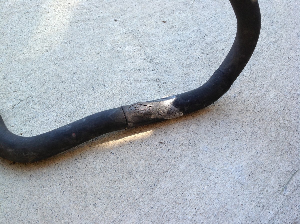

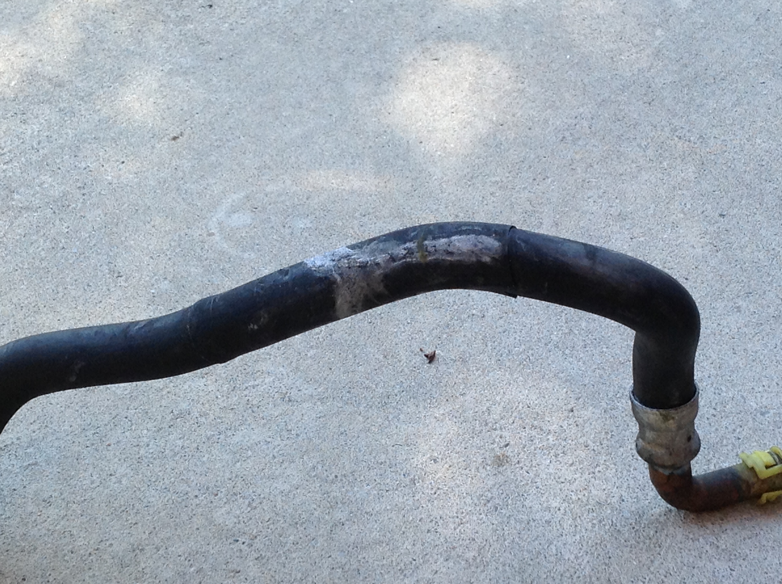

dghost wrote:Just looked at the coolant level again after driving for a bit. It seems to be a a tad low from where I filled it the other day. Not sure if there is air working its way out of the system or what is going on. Will update later on.
You should start fresh in the morning with a cold engine and correct the level before driving. I think "cn90" maybe right about a small leak in the system. My Heater Core hose has been leaking unknownst to me since Jan 2012 as it left several drips on the driveway after shutting down the car. Always thought it was the Turbo.
The Level in the Tank has been off in the last several months with a slight seepage at the cap after the car is driven. Found the following when I recently replace the Core and Core Hoses in the engine bay.
Never removed the Air Tube to Turbo but knew it was rubbing sometime ago. Did not see any seepage at the top at the time but the bottom is obvious.
Heater Core Hose Below Air Tube (w/PTC) To Turbo Inlet
