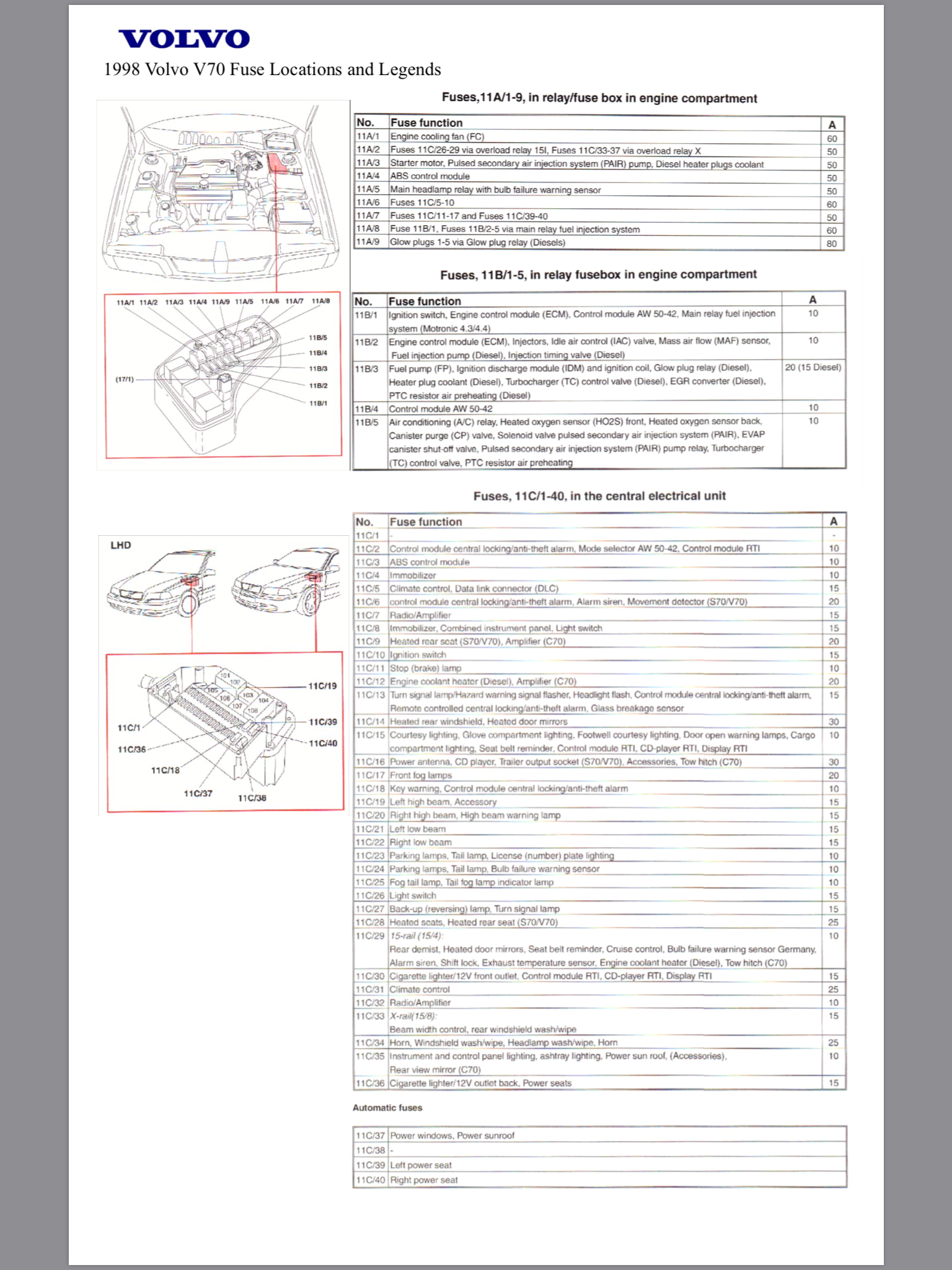

Just to keep things interesting - That fuse handles more than the directionals:

Which fuse?
I am counting at least three it could be.

It’s number 27 in the fuse box under the bonnet. Not the relays. It is the backup lamps and turn lamps

11C/27 Wiring, lamp sockets, Bulbs or Gear Position Sensor.stephansvolvo wrote: 07 May 2019, 20:56 It’s number 27 in the fuse box under the bonnet. Not the relays. It is the backup lamps and turn lamps

Does it blow immediately? When you turn on the key? When you use signals?
And - Just for grins, unplug the hazard light switch and see if you still blow fuse 27.
If it fails, you may have a backup light issue, if not, you're probably still chasing turn signals.
