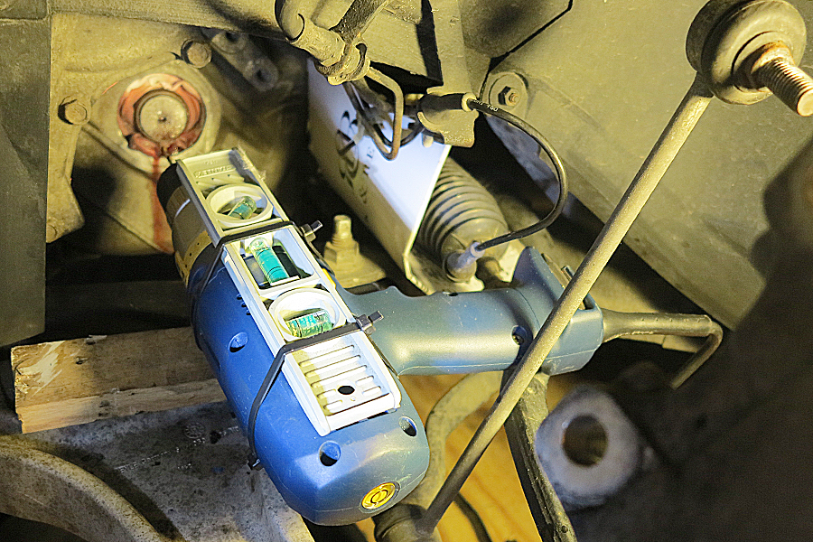

Just got back from shopping. Axle seal from Volvo parts, 60 piece tap and die set, T-handle tap ratchet wrench, and a large set high speed steel drill from HFT. Pictures shortly.
I could go up to 1/2-13 coarse or 1/2-20 fine, but can not figure out what size hole for final size. Should the final hole before tap be 3/8" or 7/16".
Location and hand-held position would make it difficult to get it all straight. Would starting with 1/8" and increasing by 1/64 till the final hole ensure some accuracy?

It doesn't matter where the hole ends up. Aim for the center. We are pulling on the bolt so as long as its 1/4 in from the edge of the shaft you are fine.
Remember to tape up before drilling and tapping to avoid metal slag going into transmission.
Are you sure you don't have a neighbor who can weld. That's a 5 minute job with a flux core mig or stick.

No neighbor with welding. A friend with slide hammer says he would lend hand SAT.JDS60R wrote:It doesn't matter where the hole ends up. Aim for the center. We are pulling on the bolt so as long as its 1/4 in from the edge of the shaft you are fine.
Local Azone shows slide hammer for loan... http://www.autozone.com/autozone/accessories/Tools-Garage-and-Equipment/Slide-Hammer/_/N-25f1
The drilling is slow, cutting first hole with 5/32 to 1" deep.
