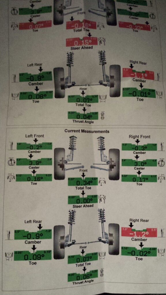

Here is the printout from the most recent alignment.

Post by MoVolvos »
_
Front left Castor and Rear left Toe are causing the pull to the right.

Oh, that's right, it was the castor that he said couldn't be adjusted, not the camber as I stated in my first post. So if that's what's causing the problems, and it's not adjustable as he stated, what do I do? And how is the rear toe adjusted?
