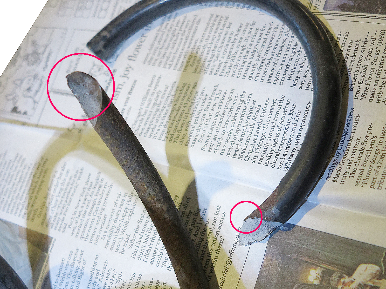

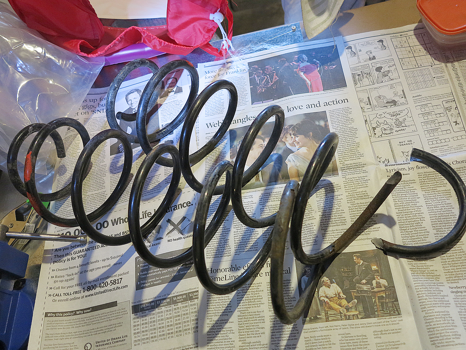

Few photos of old spring.
There was a crack where rust had taken hold.
Enamel paint coat over the last ring is peeled off. This ring sits in the rubber cushion where water and salt accumulate and does it magic.

That crack looks more like A defect in casting than a rust failure.
