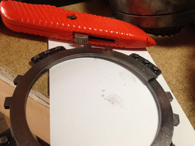

This is the plate inside the pump assembly that was cracked. Its the last one of the smaller clutch package. As far as I can see this plate and also all of the plates in the clutch that burned up is the only hard parts I will need.

That is the C2 pressure plate. That clutch is carried by the pump but is not the pump.
Make sure the piston behind it is OK and the housing isn't damaged in some way to make the piston hang.
Usually there is a cause for a part like that to crack.

Oh ok thanks for the tip. I will look closely at all the parts I will take apart. This is my first auto transmission job I've done so I really appreciate all the help I can getjimmy57 wrote:That is the C2 pressure plate. That clutch is carried by the pump but is not the pump.
