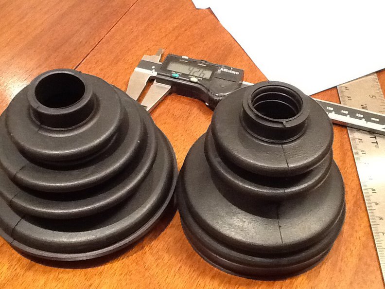

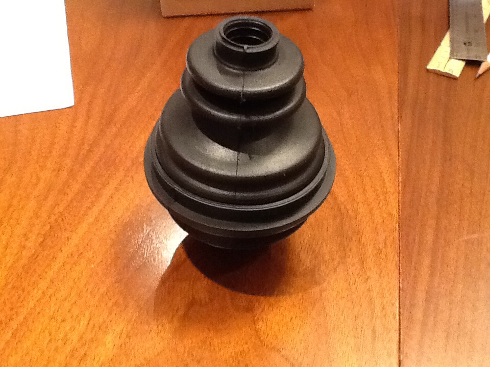

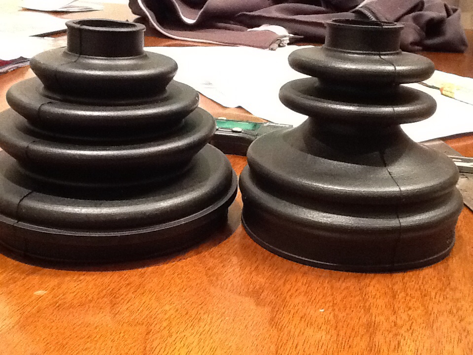

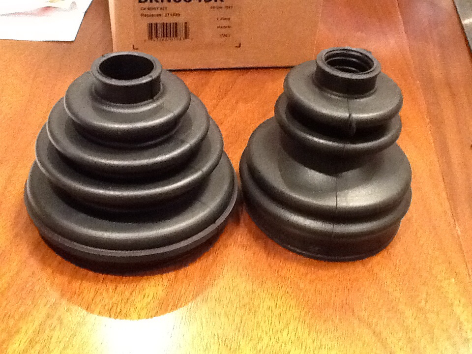

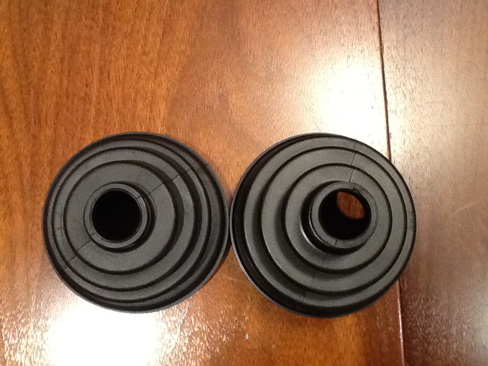

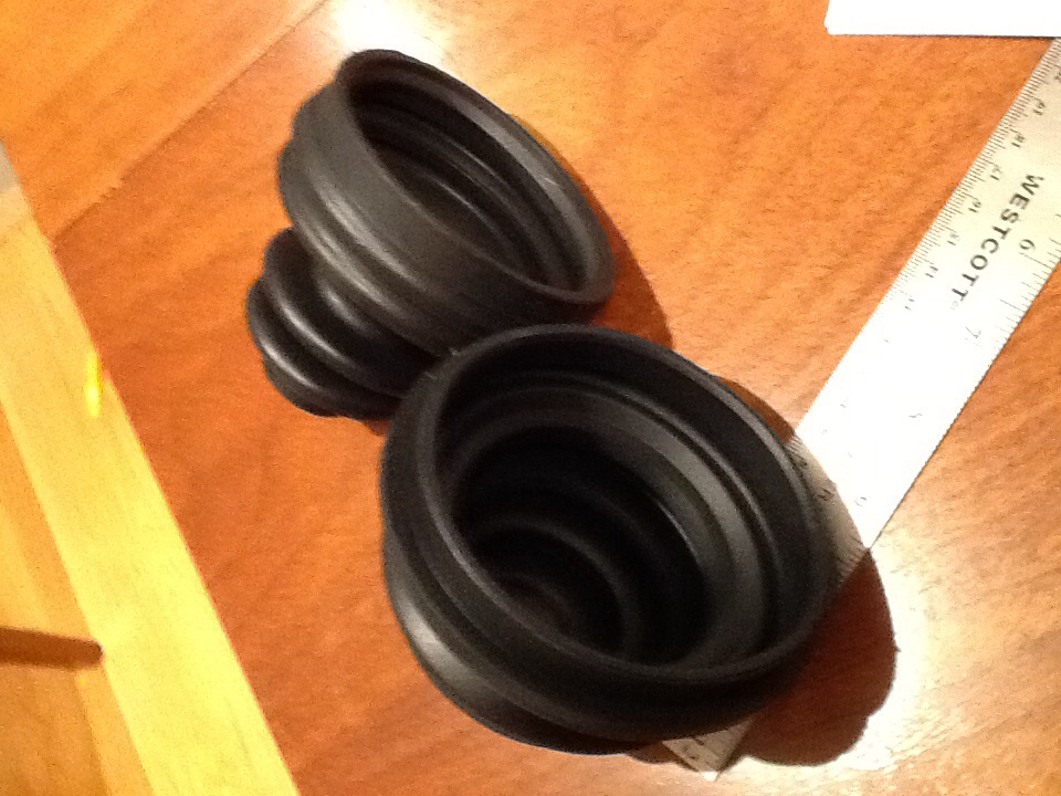

Pics
- Guess which one is GKN ?
- image.jpg (247.48 KiB) Viewed 2223 times
- Comparo of rein to GKN, note thickness diff
- image.jpg (254.68 KiB) Viewed 2223 times
- Outer and inner Rein: different large diameters 10mm diff
- image.jpg (262.9 KiB) Viewed 2223 times
- Inner rein fitting inside outer Rein
- image.jpg (237.04 KiB) Viewed 2223 times

Excellent found it, finally! I think what I mentioned above using the NA boot for inner will work but upon close inspection I'd rather use an inner boot for the inner like your solution. There are major differences in the design besides the size. See picsnorthernlights wrote:Hey sorry I missed this one. I am not familiar with the 300516 pn.mecheng wrote:Northernlights: The part supplier said the GKN number is 300516 for a 1994 Audi 100s.

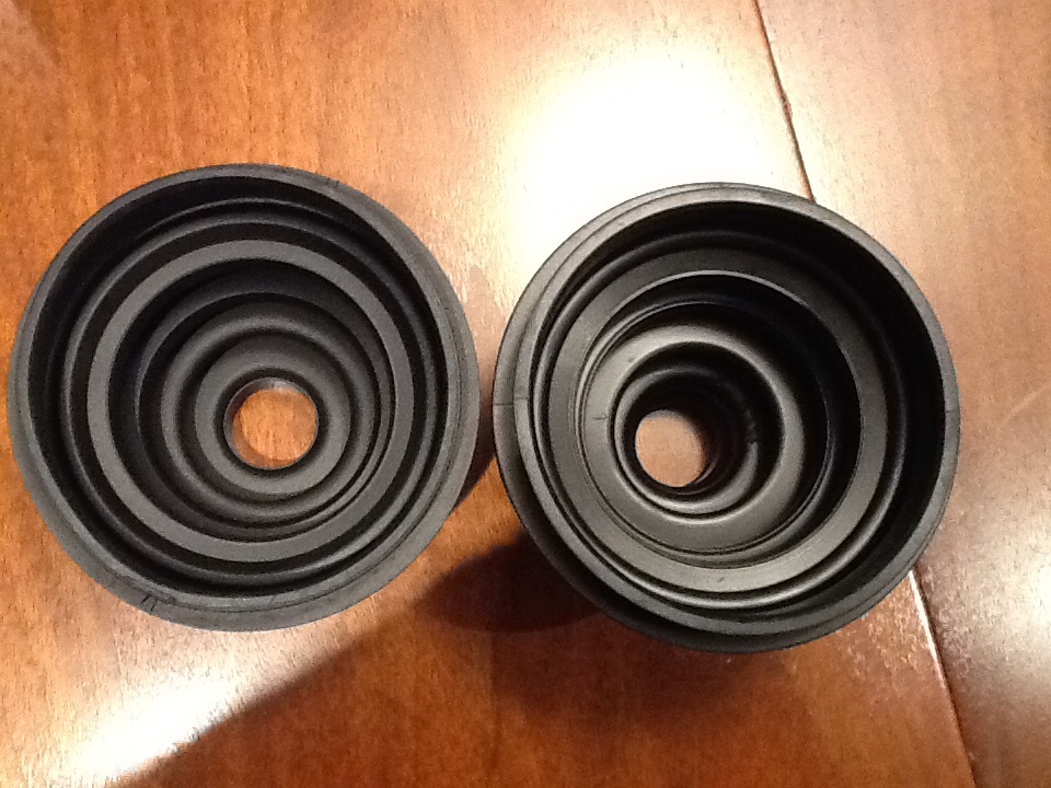

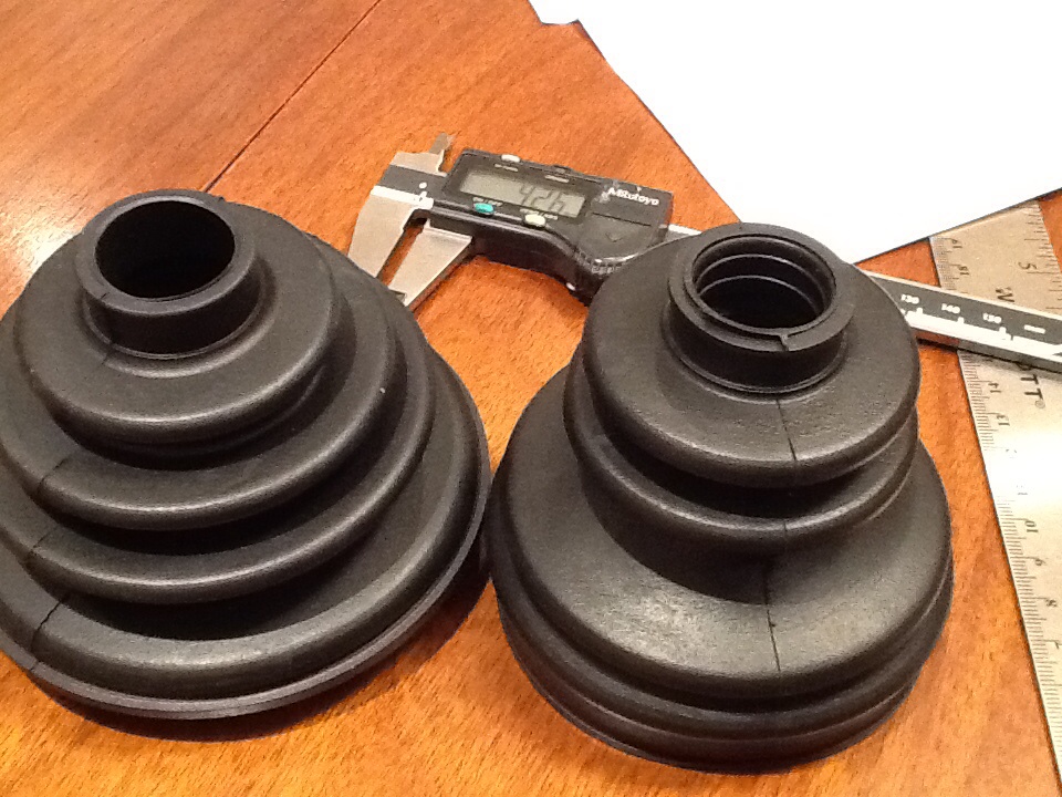

- Inner differences
- image.jpg (224.75 KiB) Viewed 2220 times
- Look inside
- image.jpg (245.79 KiB) Viewed 2220 times
- image.jpg (252.99 KiB) Viewed 2220 times

There is definitely a difference between the GKN/Lobro parts and the generic aftermarket. That's why I took some time to try and figure out how to make the GKN parts work! I hope Pelican ships to Canada, as I think you will like the parts. If not use the part number for an Ebay search and you should find something. I suspect the part number I provided is the OEM Audi number or something similar.
The aftermarket stuff does seem less substantial, plus there are visual differences in the internal features where the boots clamp over the shaft and CV joint. It's one of these things where they look mostly the same, but because they are copies the small details are different.
Same thing with respect to materials. Who knows how appropriate the choice of the boot elastomer is with the generic stuff, if the grease they provide is fully compatible with it and lubricates a CV joint as it should, etc. You will notice that the GKN boots come with GKN grease, not some random wagon-wheel stuff!
Those details are the things that GKN/Lobro probably spent a bunch of time and money engineering, and I have to believe that they know more about it than the companies trying to clone their products in the same factory that might also make toasters.
