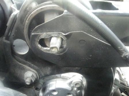

I replaced all of mine (front, rear, side, trans link, top and firewall) with OEM (Hutchinson, etc.) parts over a period of about 2-3 weeks. It wasn't cheap as you have observed, and the rear especially was a huge pain in the ass. But, I hate doing jobs more than once, so I'll spend money on good parts with the hope of not having to redo the job any time soon. Most came from Pelican Parts as they have good selection and prices for OEM.
I think the hydraulic mounts aren't replaced often enough because
As I worked through my mounts, I did the rear last, and front second to last. After I did the front, I had to grind out the slot in the top bracket. The motor now sat high enough that it didn't line up right to the point where the bolt would not go through the slot without forcing things. To me that means the original mounts had sagged a bunch. That probably means they put a twisting load on the rest of the mounts even when the car isn't running, and maybe that's why they wear out fast.
After I replaced the rear, the bolt went closer to the front, but even then the longer slot probably keeps some strain off of the top mount. Whatever the case, both of the hydraulic mounts looked fine visually, and had probably been in the car since it was new, but definitely sat different than the new ones.
This picture shows how far the bolt moved in it's time with old worn out mounts to new mounts. I believe I snapped this picture after all mounts were replaced. Note the big ugly slot extension needed for the new front mount. The front-most position was where it started with the old mounts.
