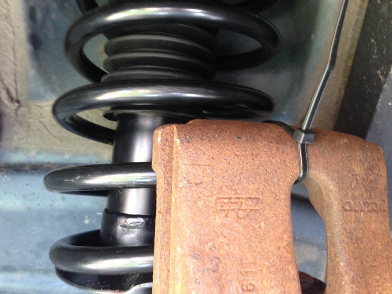

Another great use for zip ties - holding up the caliper

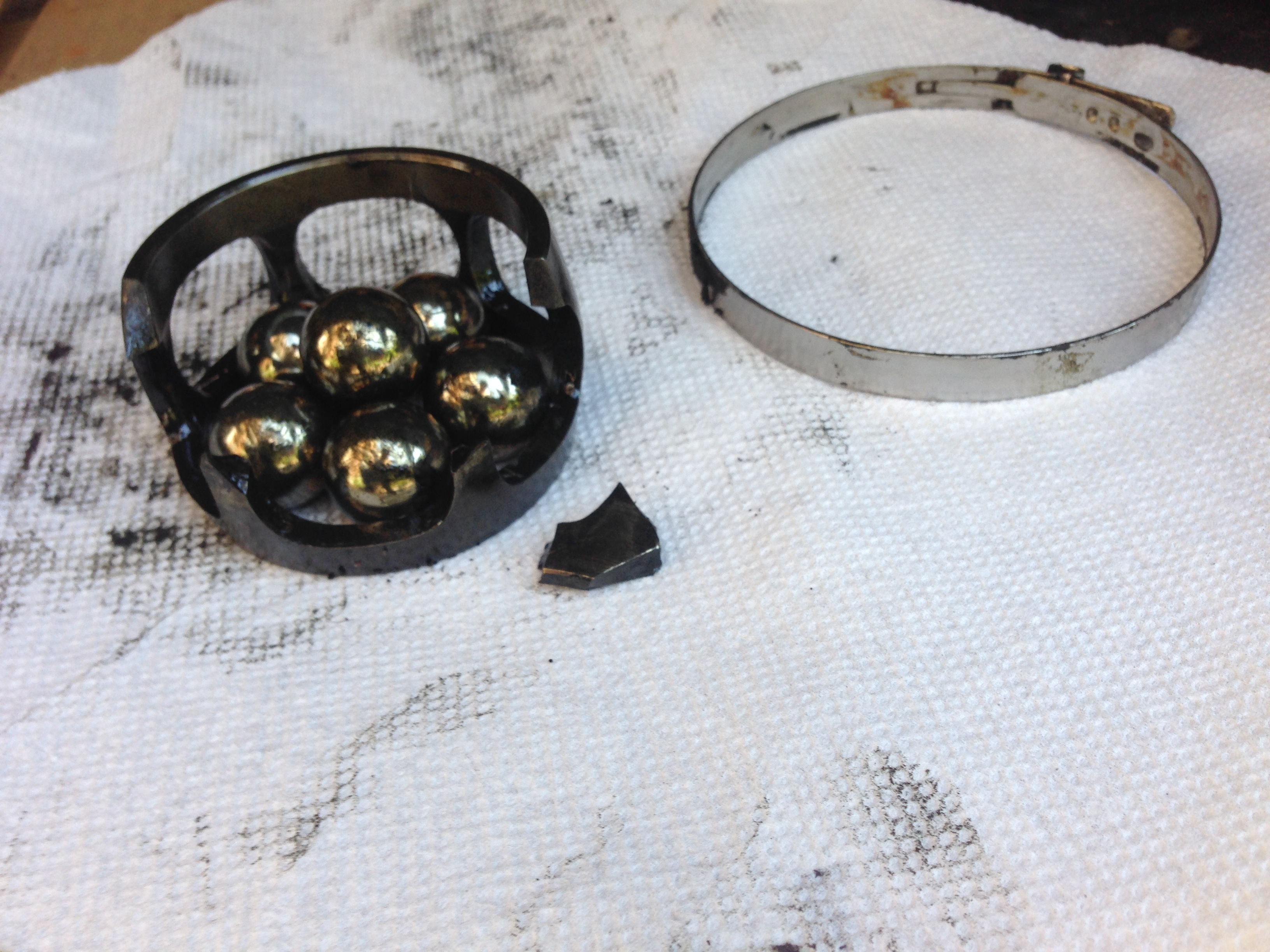

Side view - Ugh - broken cage

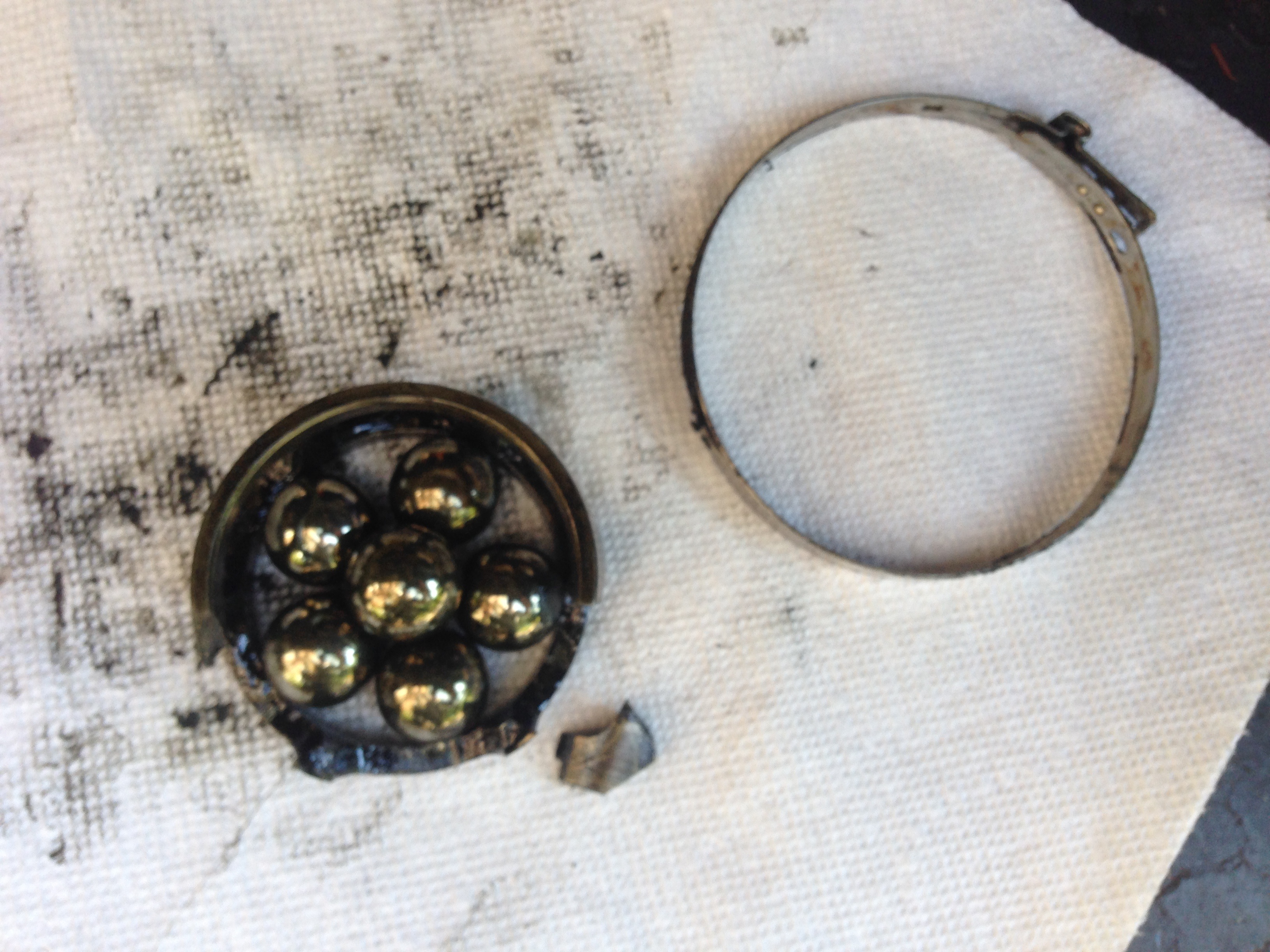

Almost passable from above  :-)

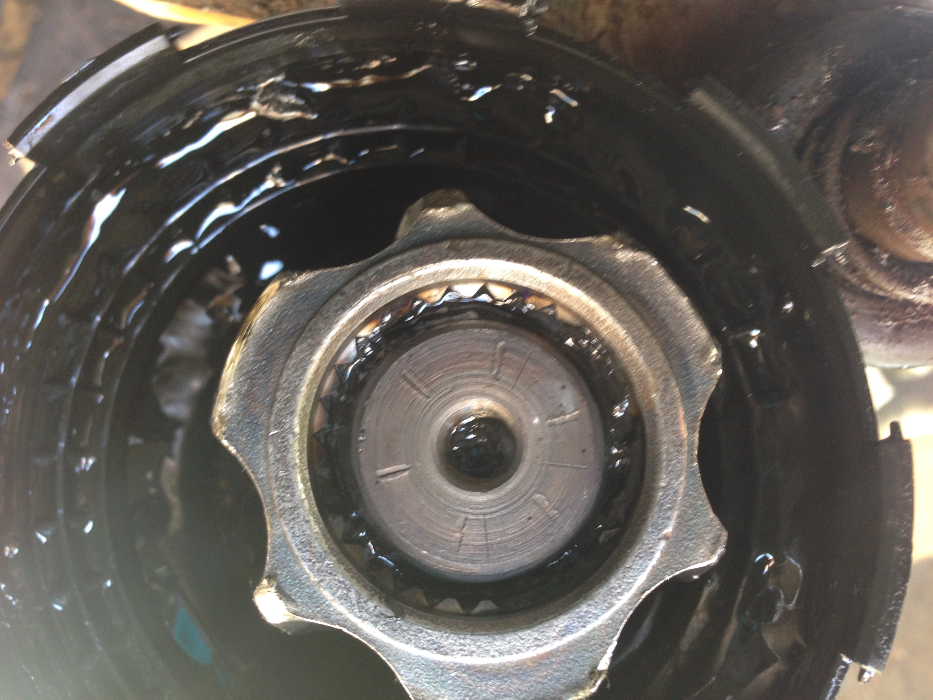

Inner joint on shaft ok - no circlip

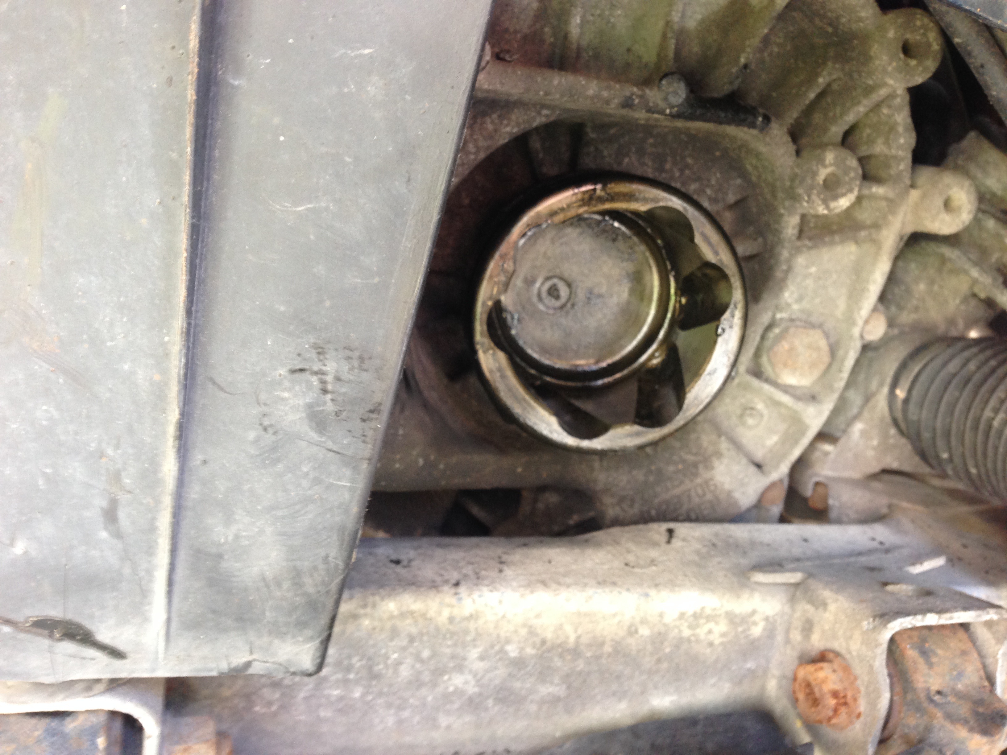

Inner joint race on transmission - ok

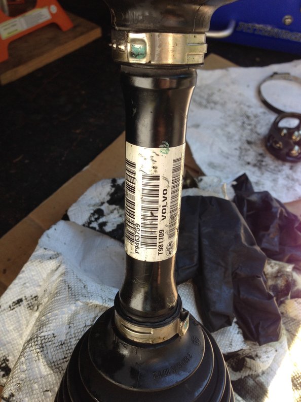

After 16 years, can still read part number on driveshaft!

looks ugly. any idea which part of the job ate the cage?
Posts: 35273
Has thanked: 1498 times
Been thanked: 3810 times
I did it pounding on the end of the driveshaft to knock it out of the knuckle. No way anything else would break that cage.
