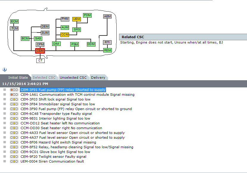

Back to issues . Here are the CEM codes (pic attached). They indicate a faulty fuel pump relay in the CEM.
The current to the pump is around 8A. I can get the car to run by disconnecting the white and white/black wires at the pump connector and run it from a small 12v battery.

Use the Delivery tab to assess the health of the electrical system. The Initial State tab is what has happened since the last code clear with Vida.

3F90 can set due to resistance in relay contacts or if the load is too high. It effectively is an excess voltge drop code. Fauty fuel pump could set this one in addtion to bad relay in CEM.
3F91 is set if the output of the relay circuit is detected with voltage when relay is not commanded on. This could result from testing where the transfer pump was powered by external power.
There is a note in VIDA that seems to apply here. It states there is a risk of a ground conductor on CEM can fail and it leads to this code and to front seat heater codes and the BCM comm code. The BCM code may not have returned becuase the BCM code is not set without engine having started and run.
Hopefully if this is the case it is a failure in an accessible place in CEM where a jumper of copper wire can be soldered over the burned spot.

Thanks Jimmy
I have replaced the fuel pump so I know that is not it. I couldn't determine it was actually bad but I wanted to eliminate it as a root cause the fried the PEM in first place.

An Update
I returned the CEM to Xemodex and sure enough the fuel pump relay was bad. Re-installed the CEM tonight and car started right up.
