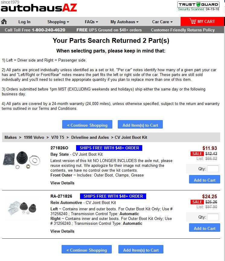

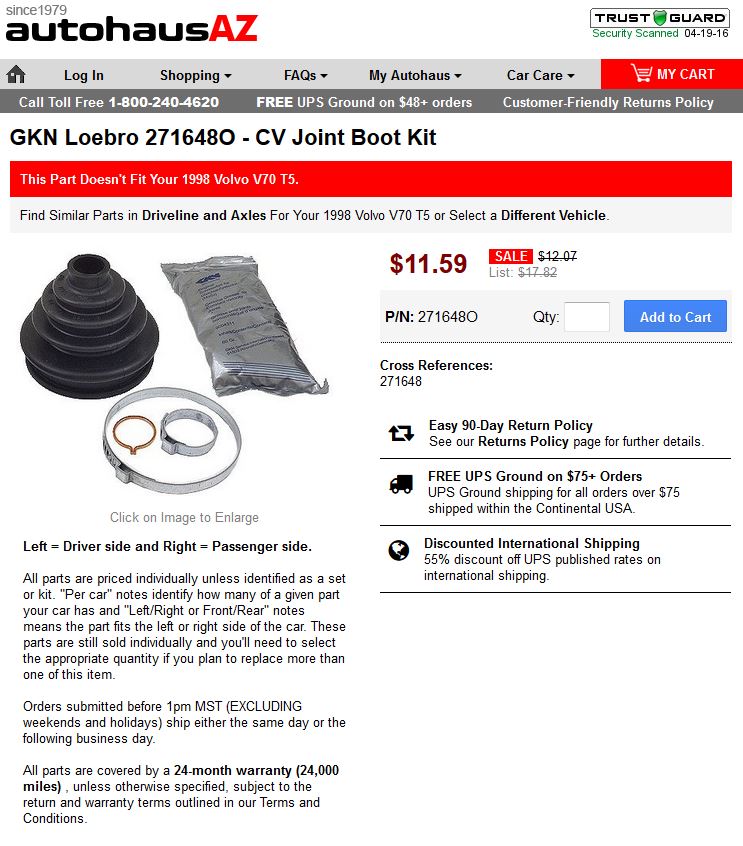

No. According to AutohausAZ, the GKN part you linked won't fit on my 98 V70 T5:erikv11 wrote:CV boot options were covered ad nauseum about a year ago, including and part numbers some vendors. Check this thread, https://www.matthewsvolvosite.com/forums ... hp?t=64252
I have been buying the GKN boots from AutuhausAZ for a few years, maybe you hit them at an unlucky time.
I now understand why they didn't appear when I typed in my vehicle info. This is what I saw:
Now if Autohaus is wrong, OK. I called, but they're already closed. I'll follow up later. If you say they WILL fit, then I'll take your word. If I'd known this when I ordered, of course I'd of gone with GKN....why not?
I'll read the link to the earlier thread and update my CV boot notes for future reference. Glad to have cleared up this confusion. Hopefully it'll help some other owners as well.

My mistake - I gave the wrong AutuHausAZ link, it was for the CV boot for non-turbo axle (93-98). You are correct sleddriver, the turbo axle takes a different boot, it has a larger outer CV.
Good news is, you can still get the GKN outer CV boot for the turbo at AutoHausAZ: http://www.autohausaz.com/pn/31256240.
Their catalog will tell you it doesn't fit a FWD T5 but it will. See the thread I linked, lots of good info there, many people have used that part number for that axle.

To: Erikv11. OK. Thanks. That same boot ID was on the very page I posted "For outer boot kit only, use #31256240". Completely missed it! Rechecking my order, I did get the Rein kit as it had both inner & outer. The former were fine when I pulled the axle, so I still have them.

Ordered a GKN/Loebro boot as ref'd above. It is indeed molded well and made of thick neoprene rubber. Very pleased to now know these are available. With that said, I'm not at all looking forward to having to redo this on the pass. side outer boot. Perhaps it won't take near as long as previously. I got stuck trying to open the circlip and hold it open while hammering off the end.
