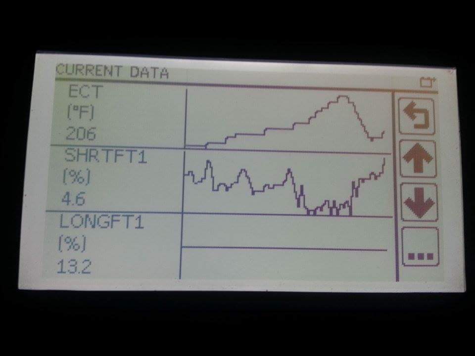

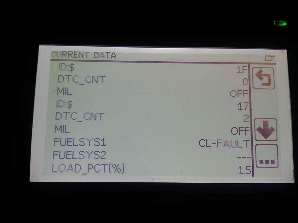

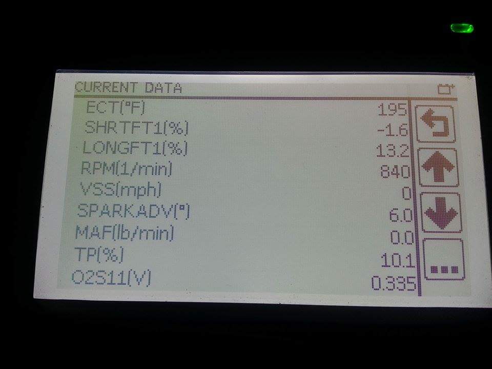

As far as live data stats. At idle today after start up from sitting for ten hrs was 16.8 and rose to 21 over a 20-30 min drive. The engine temp topped out at 210. I will post a pic of my stats in just a sec... thanks again for all your help.

Here you go. Hope this helps. The number style stat info was at idle. I broke the graph into 2 different stages per say. The beginning us idle, where it drastically declines about halfway through is where I gave it gas and revved to 2500rpm and held it. The long-term trim seems to stay 13% at idle then after a little bit of driving it goes to about 20%, give or take. The car as you can started about 190 degrees then went to 206 degrees. I see what you're saying about running lean and I agree but no code for that yet.

MAF reading zero at idle?

Yes I just double checked The MAF Readings. It reads lbs/min. At idle its reading 0.0, if I rev to 2k I get 0.1?? at 170 degrees fuel system1 is reading open loop then goes to closed loop fault at about 180 degrees. And still at idle the LTFT is at 13.2 & STFT alternating -0.8 to +4.6. But like I said; when I get to driving LTFT goes to 20+

If you look upstream you will see the classic drop in STFT when you rev up that confirms a vacuum leak as cause of problems
