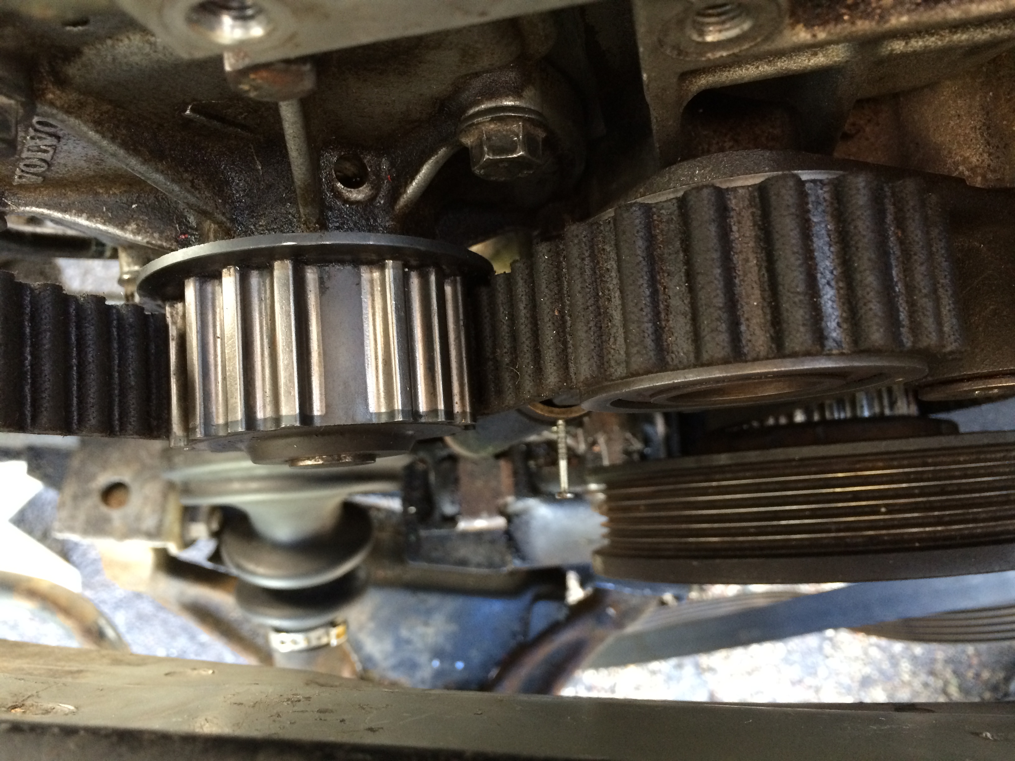

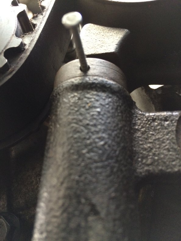

I have attached a couple of photos:
1. the installed tensioner with pin yet to be pulled
2. looking at timing belt from above after it was installed/routed around/between pulleys/gears
3. and for what it's worth, a pic of the bottom of the crankshaft pulley/gear with timing belt properly installed!!

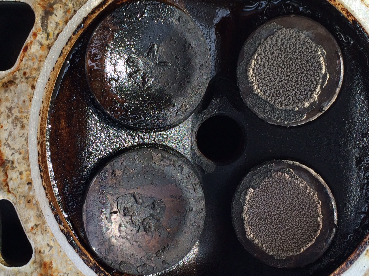

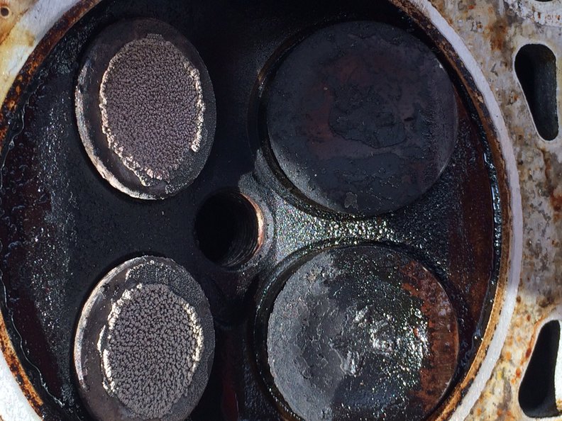

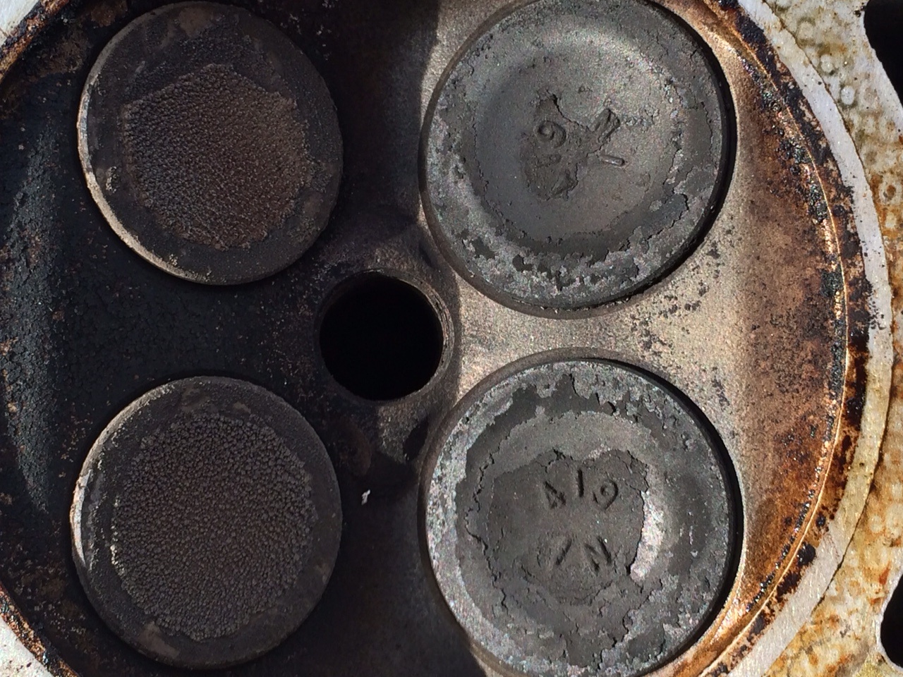

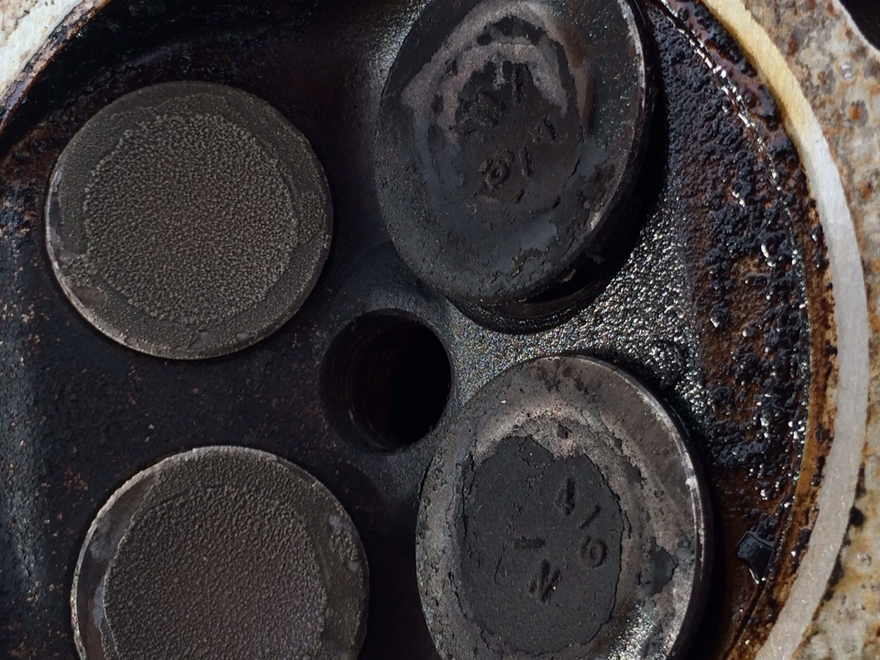

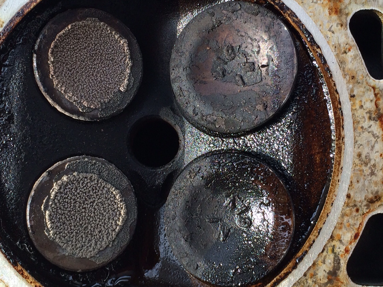

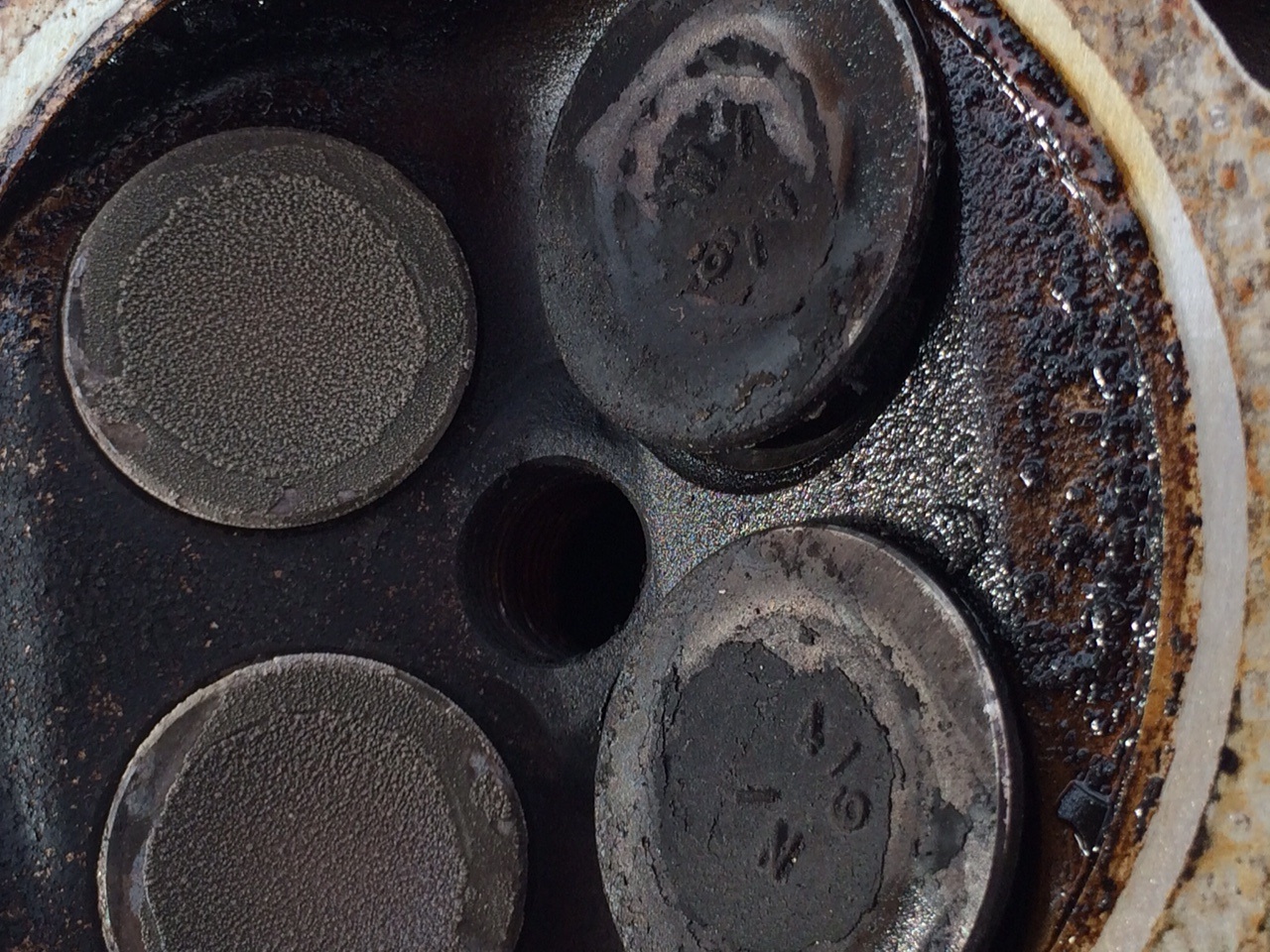

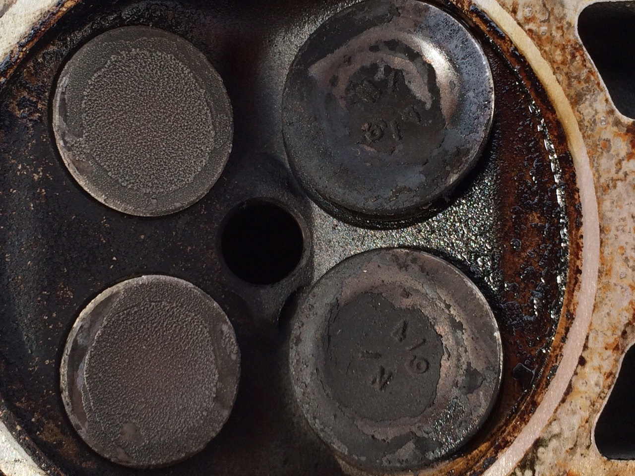

Here are a few pics of the valve seats:

The valves are definitely bent. It may just be the lighting and some oil reflecting but the first picture looks strange, like the top of the head between the intake and exhaust valve is melted or something. If it is really like that then I don't think the head can be salvaged.

I will take a closer look at in the morning, take another pic, and repost.
