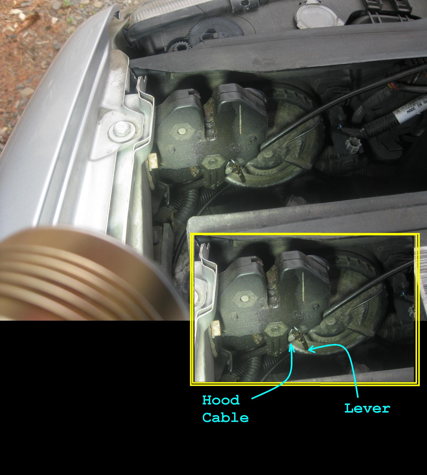

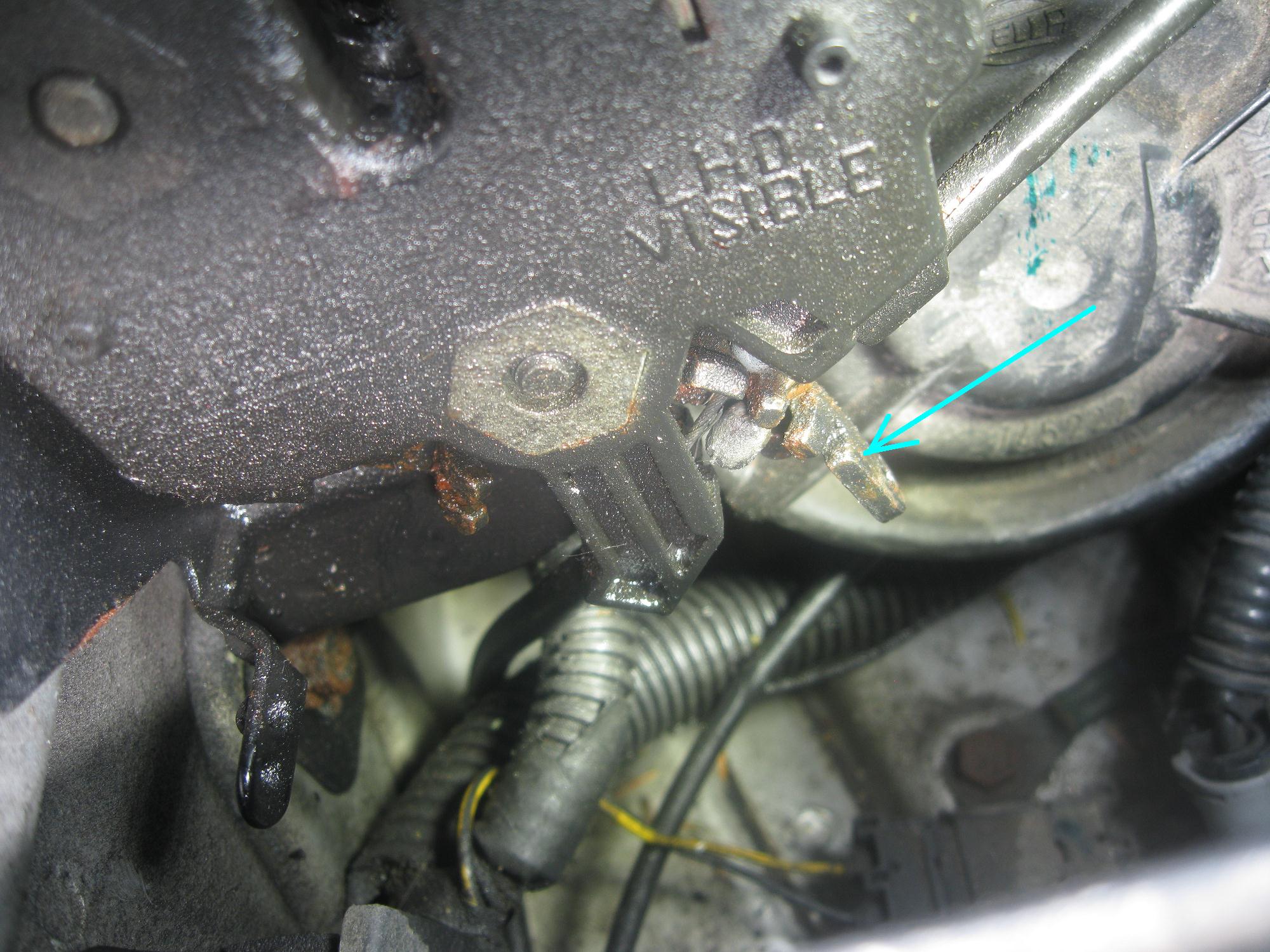

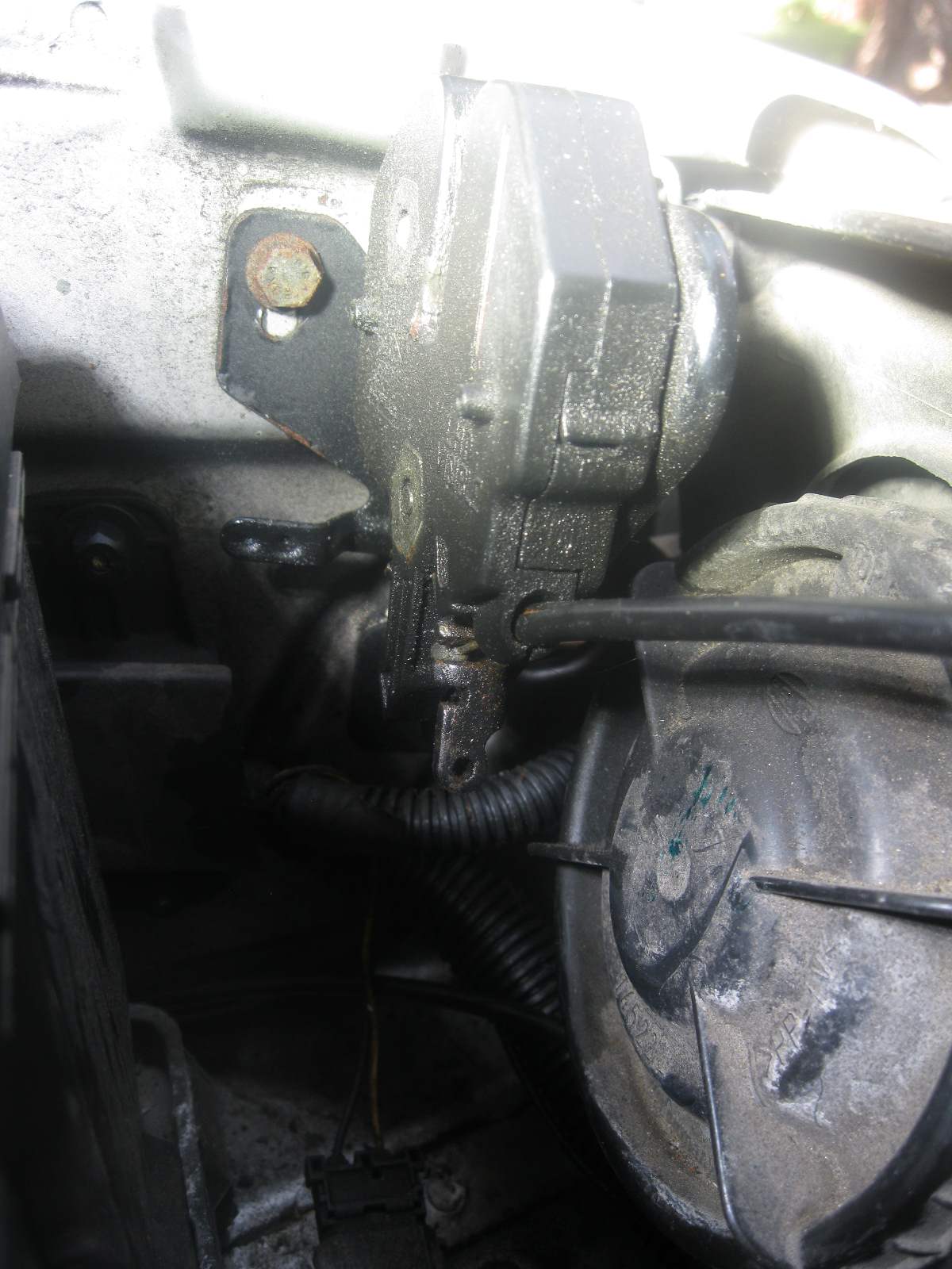

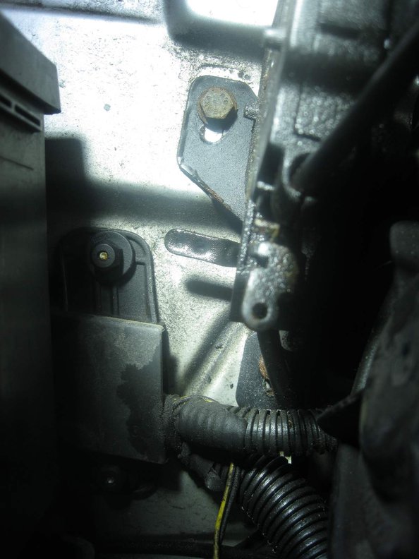

Hi,
I posted another reply to a different post before this one.
[See also high res photos of the latch and lever far below added later to this post]
You "might" be able to reach up from the bottom if you take off the splash guard. It depends if your car has the secondary air pump mounted or not. If you can get your hand to the little lever, you tilt that (might be hard to tilt by hand though) and the hood latches should let go because that's exactly what the hood cable does, it pulls that lever, and that unleashes both sides.
If you cant get your hand up there, maybe a coat hanger like you said, but if you can pull that level you got it made. I havent tried this yet either.
The lever has to be held or caught from the bottom, the part that sticks downward, and it has to be tilted from left to right not top to bottom so you cant really pull on it i dont think, you have to push it. By "left to right" i mean in the direction of the drivers side side panel, not toward the passenger side. It only has to move about 3/8 of an inch or so and that releases the dang hood latches.
The normal hood cable ties into that latch but up a little farther on that metal lever. When the cable handle is pulled, it pulls that lever from left to right, so you'll be doing the same thing, if you can get to it some how.
I will probably try this myself too. I didnt try it yet because when i went out to examine the latching mechanism (again) i only took better pictures so i could come inside where it's cooler and examine them and figure out what is what. I will post a picture in a minute or two after i dig it out.
Here are the pics.
Pic1 inset points to the area where the cable is although you cant see it in that pic, and on the right points to the lever in the direction of travel (arrow pointing from right to left, which points toward the drivers side side panel).
Pic 2 shows the lever from slightly different angle, and direction to push lever.
Pics3 and 4 show close ups of the lever from the point of view of the passenger side with camera pointed toward the drivers side. The lever is the thing with the hole in it at the bottom of it and a square notch up a little more, and it is near the center of the pictures.
