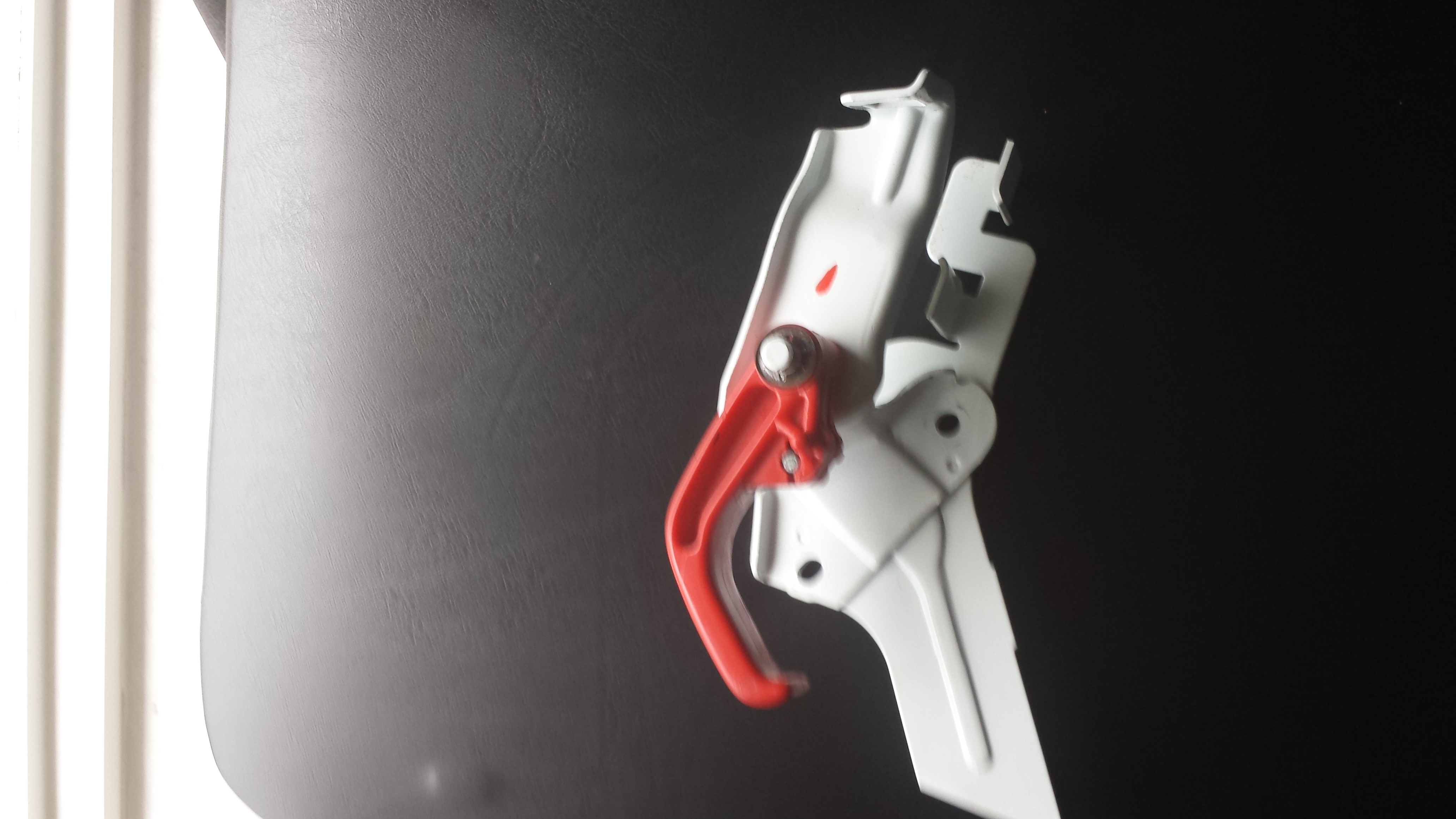

OMG! I'm having the hardest time finding this part for my hood. i order a release cable 912-010 and it was the wrong part. I do have the red and white bracket and it works fine(I think lol) but i need the cable cord. Can some one PLEASE tell me how to find what i need instead of buying both parts I just need the cable the goes to the bracket so i can open my hood......Thanks in Advance!!!

There is a cable from the inside of the car to the latch (http://www.eeuroparts.com/Parts/51563/H ... e-9444027/), I think that is the one you want?
and one under the hood, from one side to the other (http://www.eeuroparts.com/Parts/35669/H ... e-9152942/)
Those links have Volvo part numbers if you want to use those to shop around. Oh, this is even better for part numbers: http://www.jimellisvolvoparts.com/showA ... ly=1061241
