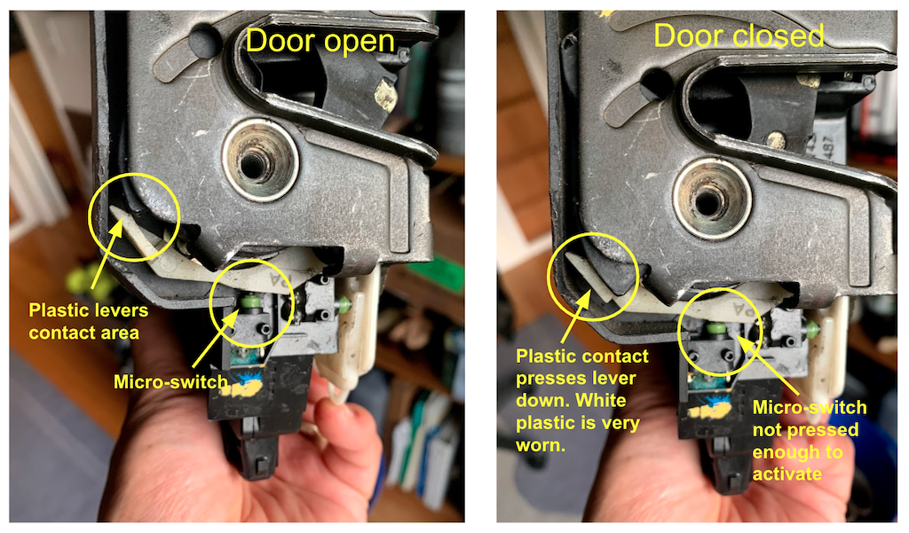

The issue is that there is excessive wear on plastic parts, limiting movement of a lever that activates a microswitch. I'm not sure why Volvo made it so complicated! Here's a complete explanation accompanies with the picture below.
On the left you see a door assembly when the door is open, i.e. the latch is open. In the upper circle, you see the contact area for 2 plastic levers. The upper black one rotates with the door latch. The lower white one is the lever that activates the microswitch. When the door closes, the black lever pushes the white lever down, which presses the microswitch. Clear as mud?
When the door is closed (picture on the right), the black lever pushes the white lever down, which presses the microswitch. The issue arises in the are where the black and white levers contact. The plastic wears down and the lever action is minimized. In the picture below, the lever did NOT move down enough to activate the switch. This switch is how the car "knows" when the door is open or closed. If it thinks the door is open, the chime continues and the courtesy lights remain on.
Why the door chime remains on. It's the microswitch.
So is there a fix? If you can somehow restore the worn white plastic part where it contacts the black plastic part, it could work. Basically you need to restore the lever action to get more movement.

Ozark Lee wrote: 15 Jan 2013, 20:54
weroll wrote:I am havig this problem on my 850 but it only does it when it is cold outside. Chime will ring when I open and then stop when I close the door, but then a few min later will start to chime again. Im thinking I need to pull the door apart and check or lube the switch. I hear this door switch is more complicated than most door push button types. Any advice?
There is a micro-switch on the door latch assembly that tells they system that the door is closed. Something in the actuator arm that depresses the switch is getting hung up in the cold. I would lubricate the lever that depresses the micro-switch but not the switch itself.
...Lee
I'm pretty sure the problem is a lever that activates a microswitch.
I have posted a completed explanation here, complete with a picture:
posting.php?mode=reply&f=1&t=7133#review
Unfortunately, I am not sure it's an easy fix.
Song Huang

Might be able to get away with gluing in a small wooden shim.
RickHaleParker
Posts: 7203
Joined: 25 May 2015, 14:30
Location: Kansas
Has thanked: 8 times
Been thanked: 979 times
Post by RickHaleParker »
songzunhuang wrote: 21 Mar 2020, 20:44 If you can somehow restore the worn white plastic part where it contacts the black plastic part, it could work. Basically you need to restore the lever action to get more movement.
Build it back up with JB PlasticWeld. When fully cured, level it off.
A quick and easy fix maybe to find a cap that fits on top of the micro switch, raising its height slightly.
