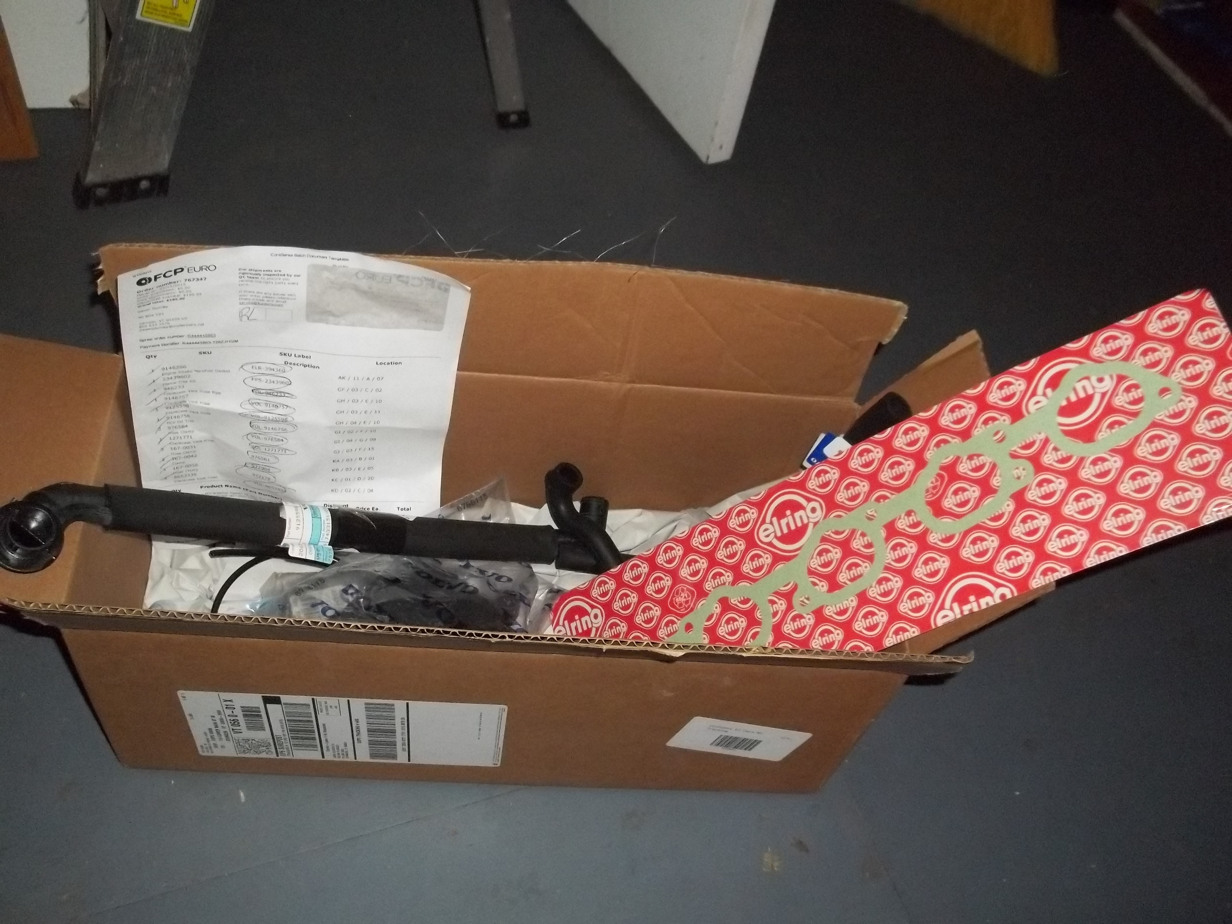

Hey, Should I order a swivel Socket set for 30 Bucks and a 1/4 extension set?
Or can I make due with a 3/8 Socket, U-Joint, and a reducer or not... and a regular 3/8 or 1/4 10mm socket?
P.S. I ordered one of these:
It's a tight fit to get at the manifold bolts near the thermostat...go to Lowes and get a 10mm 1/4" drive swivel socket, 10" extension and ratchet. You'll thank me later
Your hose clamp tool is very nice. I use end cutting pliers gently. Still need a set of dykes/side cutting pliers to remove the clamps that are on there
'00 S70, '04 S60 and the never ending quest for Stage Zero
Also, I used the FCP Euro kit on my 850 Turbo and the vacuum line that connects to the nipple by the PTC fitting was too large, the hose fit really, really loosely on the nipple, even with a clip. I was able to a use vacuum line angle connector from a kit I'd purchased to step down the PCV line to fit. Using the angle vacuum line connector made the 180 degree turn to the nipple more managable, less tight of turn if you will.

Pretty close to what I need and of course kit is sitting right here:
