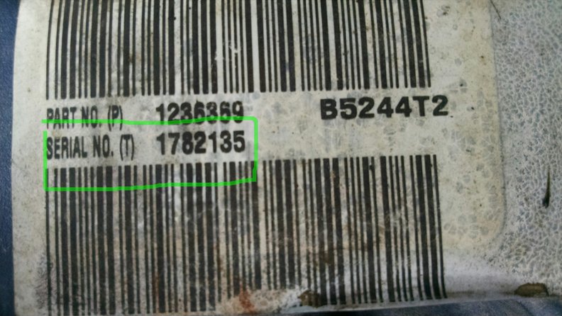

Rockauto refers to an 'engine number' of 3188688 and before for the belt. I found a serial number on the timing cover, is this what it is referring to?
Thank you for the replies! Are the Conti water pumps any good? I see a lot of you go for the Aisin (or Asian lol).
Spenser
Spenser

I think Rock Auto sells old inventory often. Especially problematic with rubber belts and hoses. Happens that's where my famous Goodyear belt was from. Use the MVS vendors and dealerships as they understand our community best.
