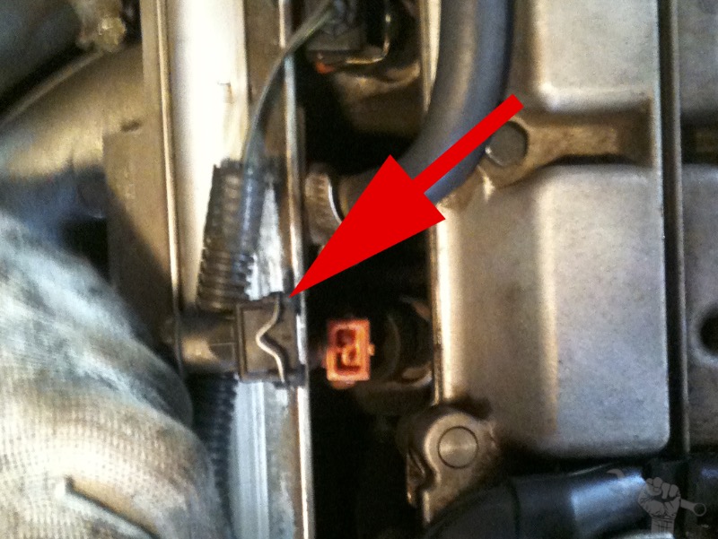

The injectors have an electrical connector that sends the spark inject signal. You want to unclip the connector.

matthew1 wrote:The injectors have an electrical connector that sends the spark inject signal. You want to unclip the connector.
This pics are magnificent. Thank you!
