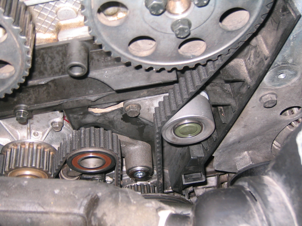

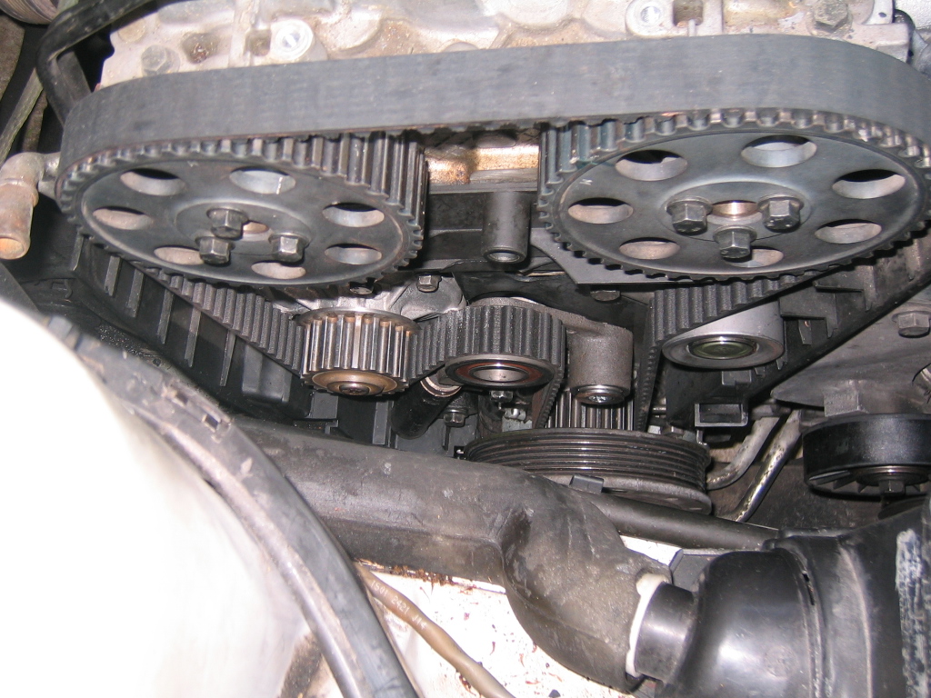

I discovered why the WP was leaking: It was loose! Didn't take much effort at all to remove the bolts. Then discovered there wasn't any thread locker on them at all. What WAS on there resembled anti-seize. After removing it, a close inspection revealed the bearing was still tight & quiet, so I'll reuse it with a new gasket. Cleaning up the block face was quite a chore. Access is awkward when working from the ground, I have big hands, tried all manner of tools. Finally got it very clean. I used the clear red anerobic sealant (since I already had it & it works great at filling in micro pores in aluminum) to coat the face of the WP to stick the gasket down, then applied more to the other side. I soaked the bolts in carb cleaner, then brushed then cleaned them up with a wire wheel mounted in the drill press. Then I used blue threadlocker & torqued to spec. This phase of the project took FAR longer than I thought, but it was important to get it ALL clean first.
Both of the INA pulleys were silent when held to an ear and spun. Didn't want a repeat. Installation was straightforward. Again I cleaned the bolts and used BTL. I used too long of a pin to hold the HT cylinder closed which resulted in quite a struggle to remove it when the time came. That thing sure can apply A LOT of force.....
I cut the old belt off to save time & hassle. Installing the new one was frustrating having never done it before, but perseverence paid off. I slid a screwdriver between the bottom of the belt and the bumper to prevent the belt from sliding when pulling on it. Getting the new belt over the TP was quite an effort as it was TIGHT. A long 90° needle nose pliers was very helpful here to fit in the space and pull up on. I then discovered the exhaust cam had moved about too teeth towards the front. So off the belt came to do it again. BTW, the intake cam never moved and I wasn't able to move it with my bare hands. The exhaust cam is much easier to move, but still takes some force. I simple wrenched it back into alignment and restrung the belt. Check with the marks, then spun the crank over at least twice, and all was lined up. I still haven't fired it up though as I want to replace the easy-to-get-to coolant hoses.
Hasn't been started yet, but note where the TB is tracking now after turning over the crank several times by hand vs. the previous photos. A side note here: I'm one of those unfortunate ones who have experienced a TB off-one-tooth when done by a shop. It was quite subtle, gas mileage went down, so did power. Unfortunately I didn't connect the dots until years later. FUBAR. Never even suspected the shop. I didn't even know it was possible to have the engine work with a tooth off. I finally verified it by going out and checking it myself. You can bet that when the same shop did the next belt I advised them of this and checked it myself as soon as possible.
