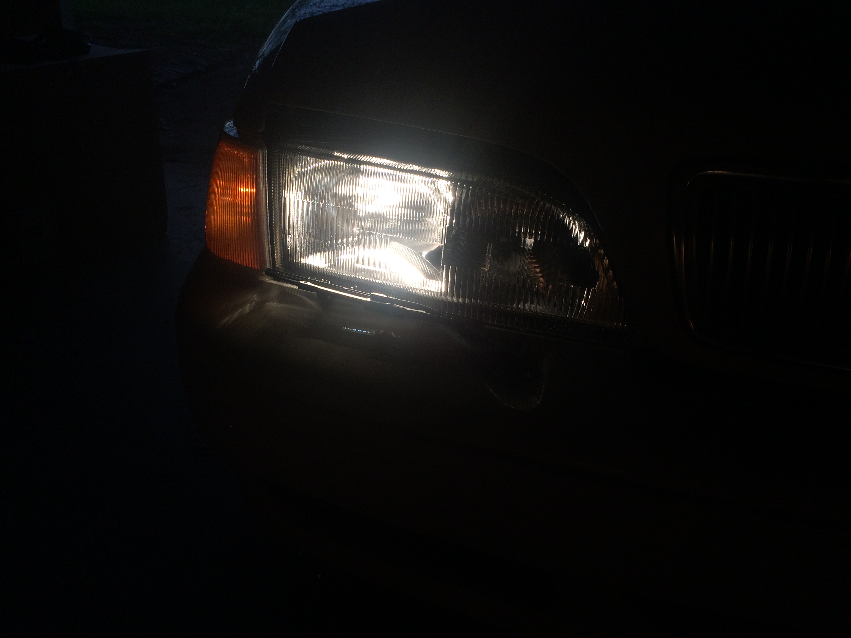

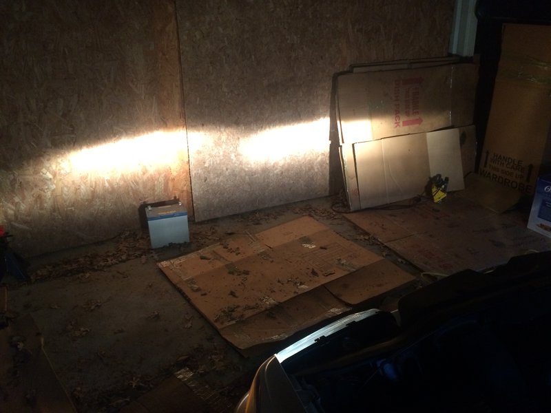

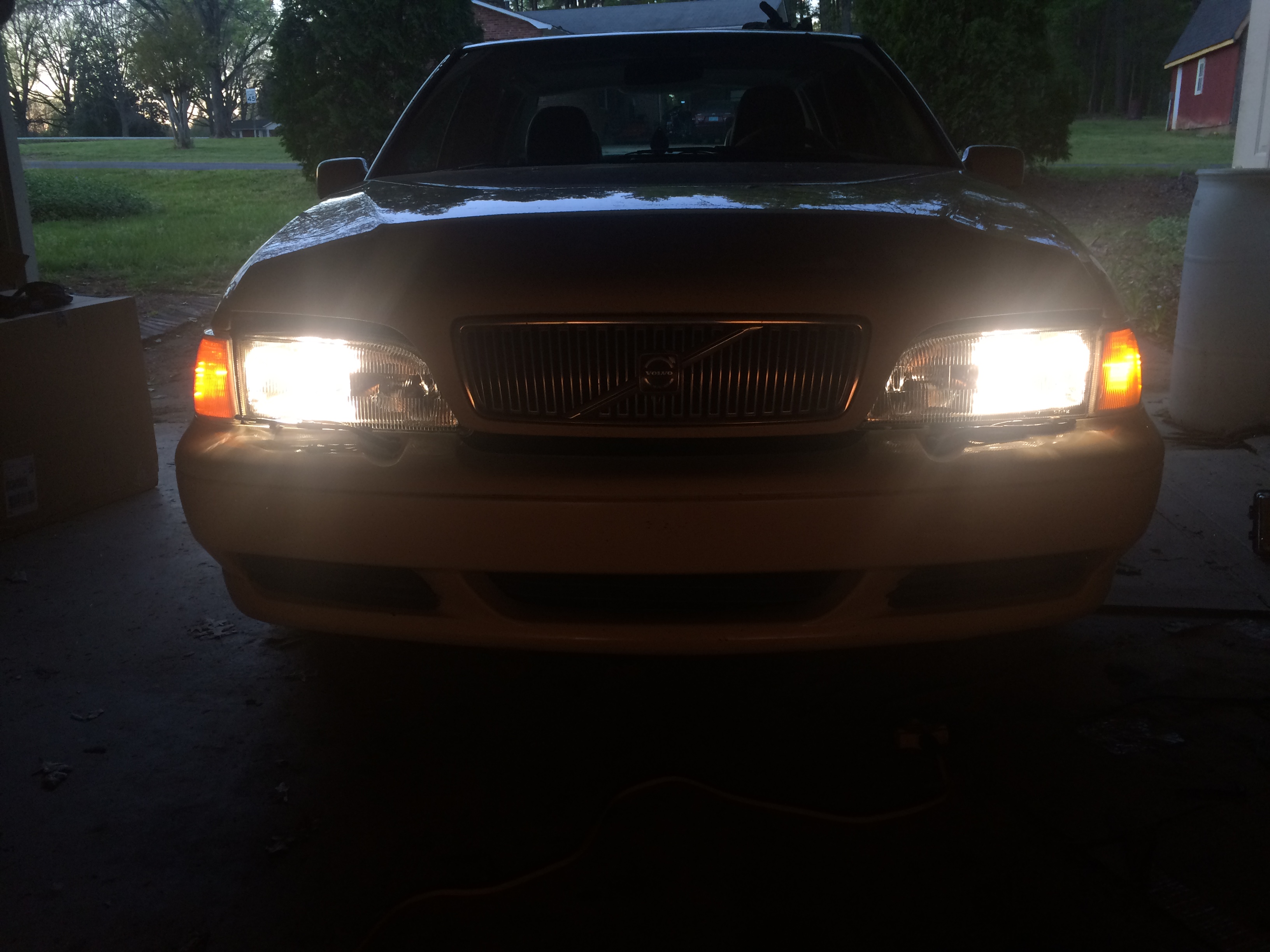

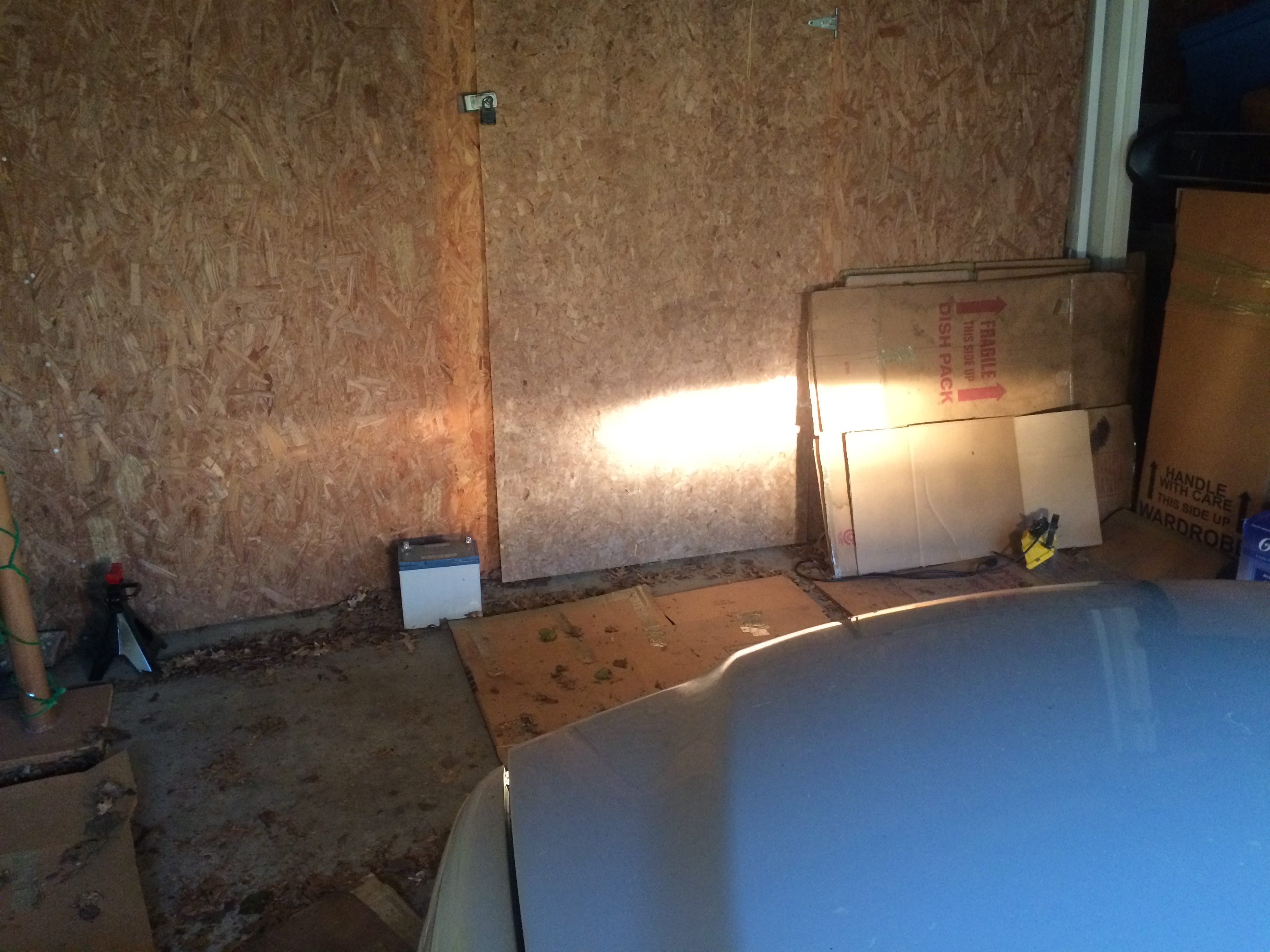

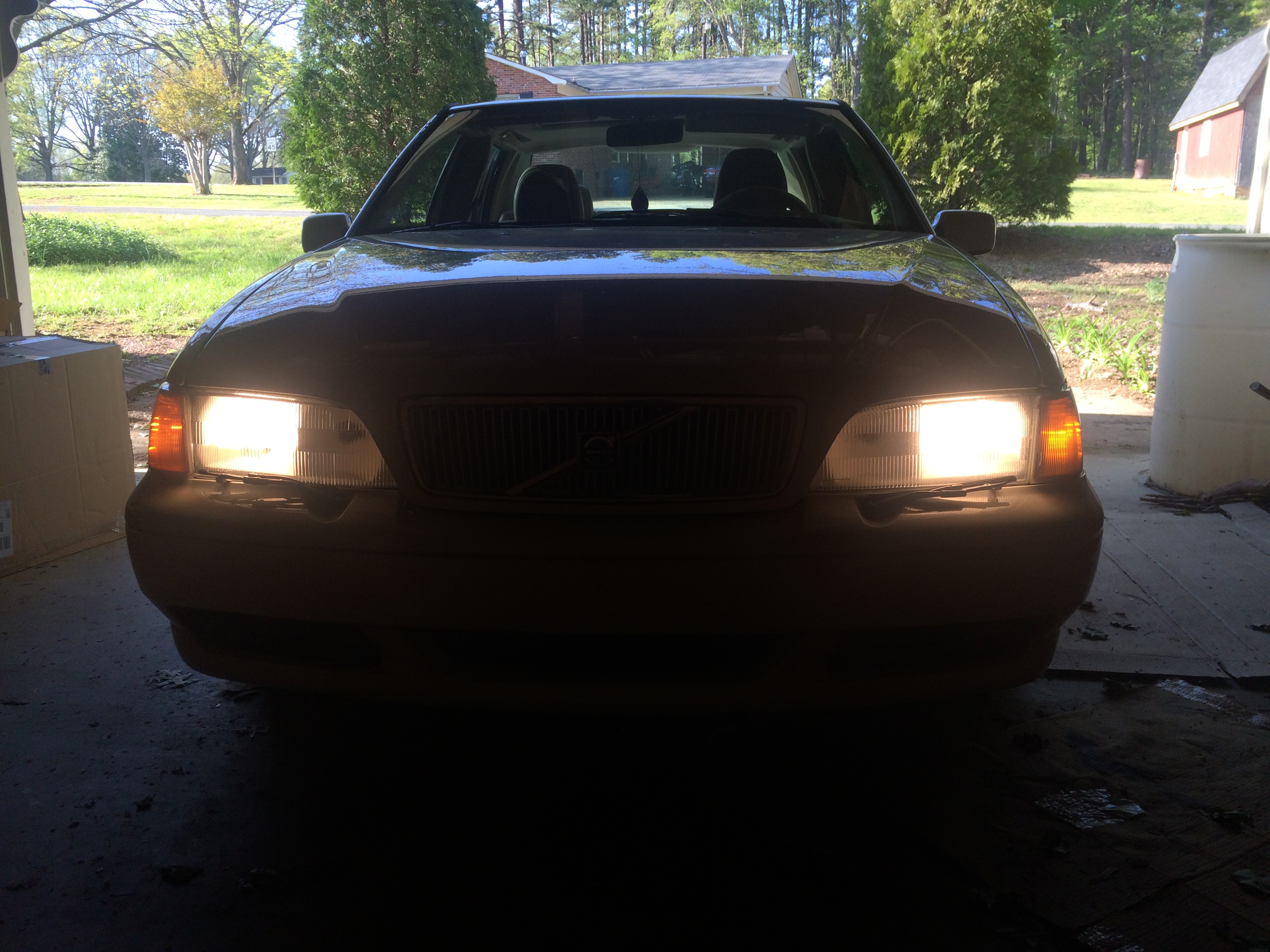

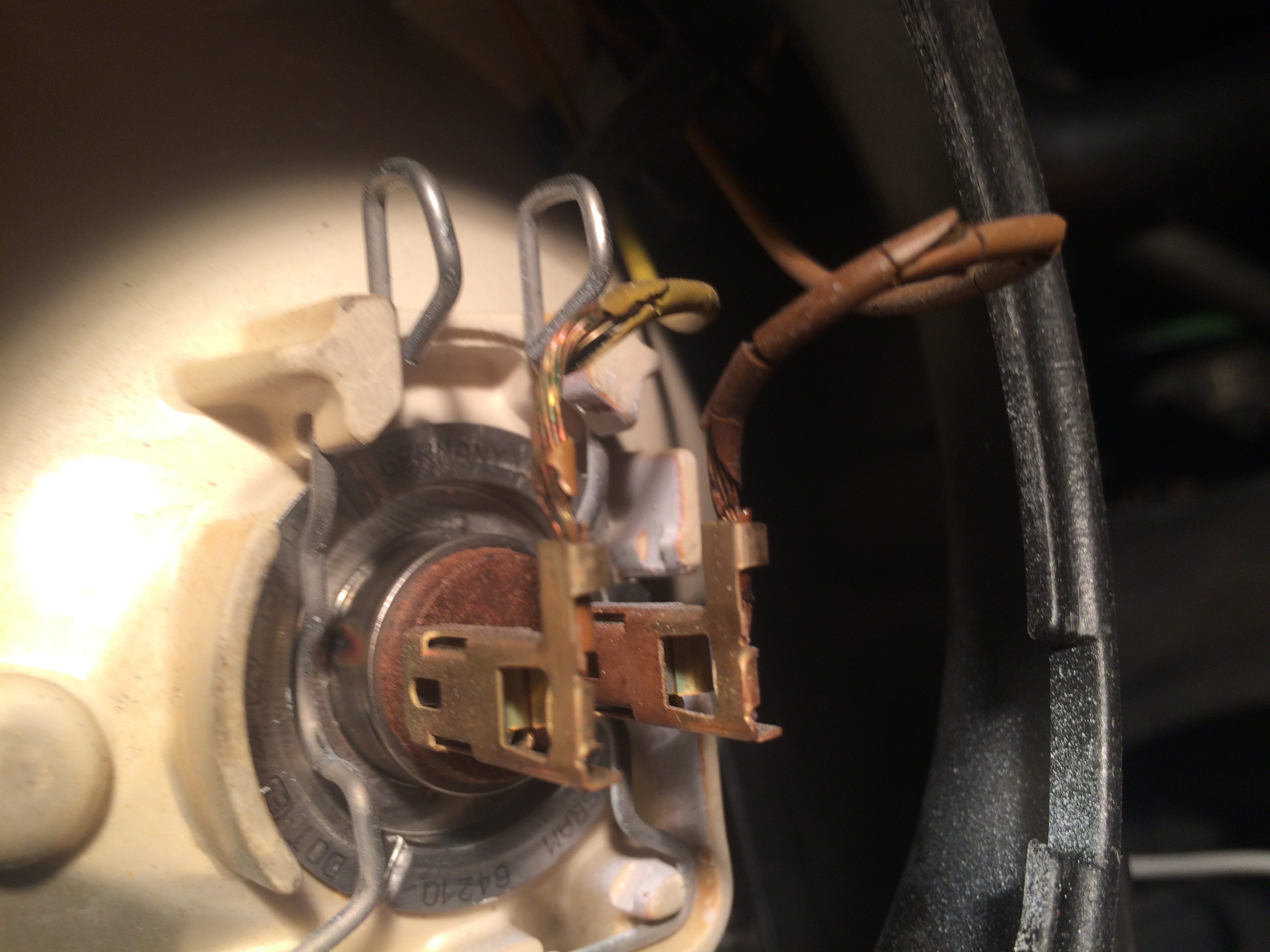

Update with new TYC headlamps...
Old wiring: Comparing old bulbs to new (both in new lamp assemblies)
(New bulbs are Philips 12972) These are the new bulbs in the old (painted white) reflectors - not really much of difference...
Huge difference:

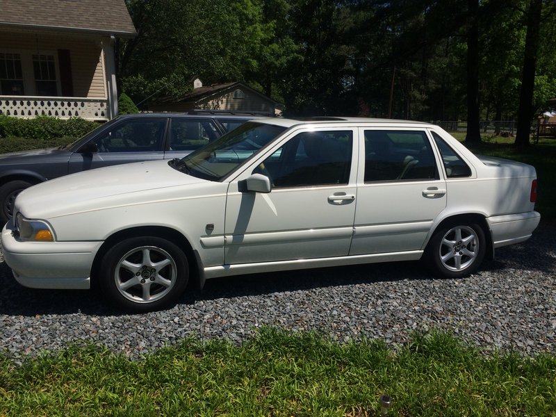

Thought I'd get some pics up since my wife just washed the S70.
