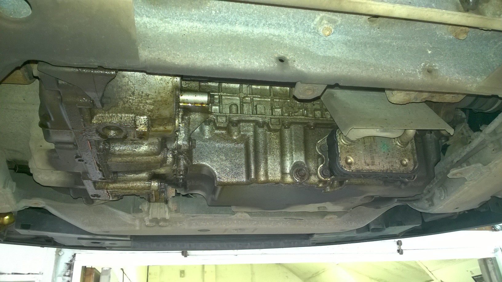

Still need to sort my oil leak

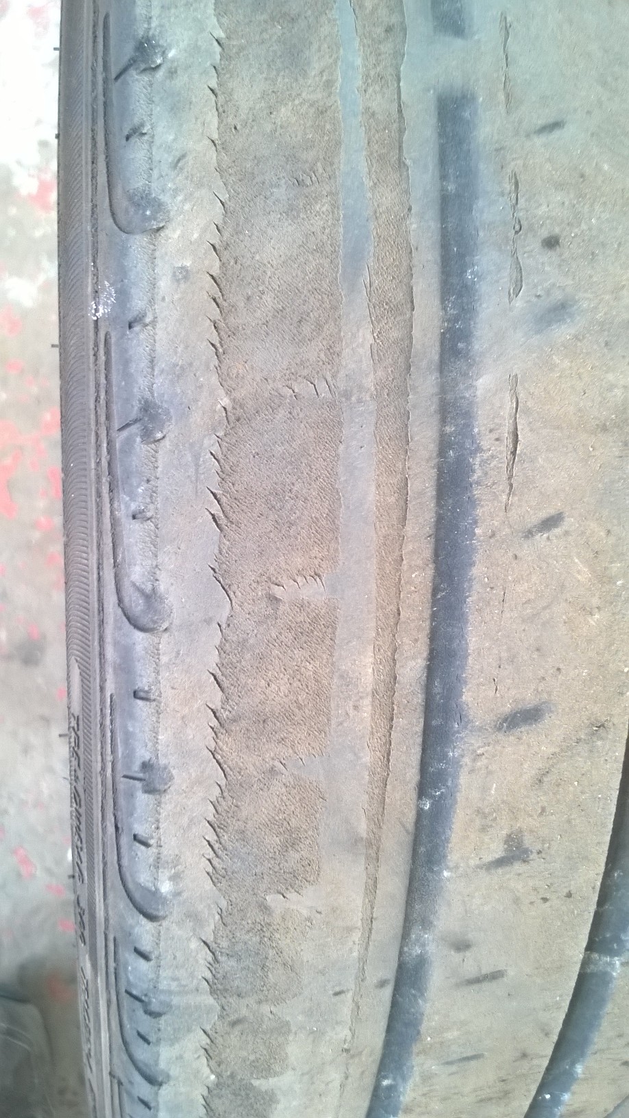

Old tyres look worse than I thought they were once they’re off the rims!

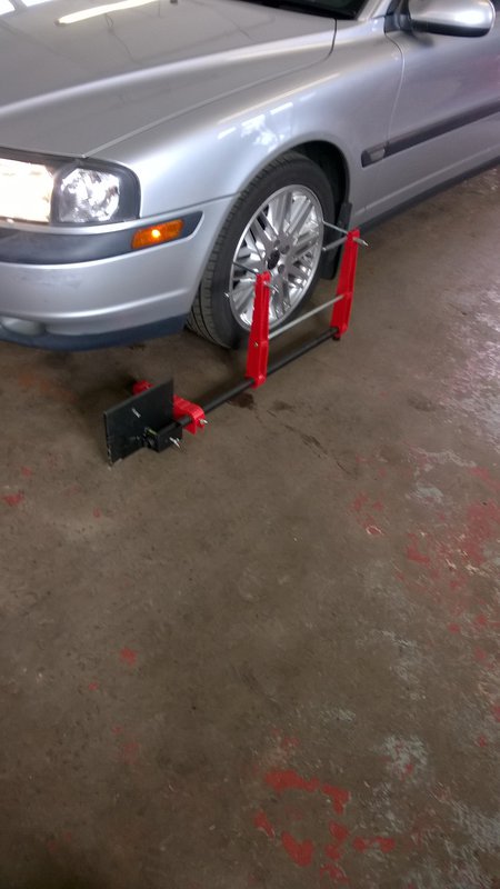

Tracking checked, came out ok, it looks like it was wrong and someone had it sorted but not before it had taken the outside edge off of each tyre
The most amazing thing though after driving to work this morning is I noticed my vibration has now gone!!!!!!!!!!!!!!
It must have been caused by the tyres, why it only happened during acceleration I still don’t know, but the main thing is it’s gone. This has been really good news for me as I was getting progressively more annoyed at the car as the vibration was making driving it an ordeal rather than relaxing.
