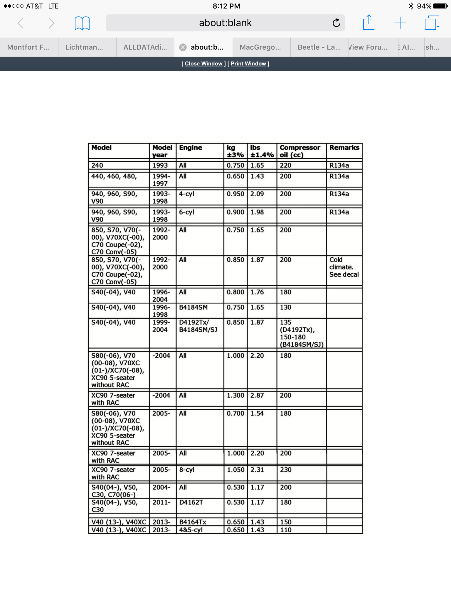

Capacities for refrigerant and PAG
Two cans R134 will fill any Volvo

That's good but the trick is to estimate how much oil you lost during vacuum. I believe the chart above is what you would add to a compressor when you replace it (where most of the oil is). So, I don't think I want to add 200cc of PAG oil the the whole system through the shrader valve- that's 6 3/4 oz. What would you think- most of it, or quite a bit of the oil stays in the compressor and dryer? How much of that was evacuated?

One of my refrigerant recovery machines has an oil separator that will show how much oil gets drawn out during evacuation and, based on experience, it is pretty insignificant. The recovery container is about the diameter of a half dollar and the residual oil that gets drawn out of my Volvo 850s/70s has never even covered the bottom of the container. The amount of oil that is pulled out during evacuation can change based on the port location on other makes of cars so it isn't a good blanket statement that it never draws out oil during evacuation but on the P80s that is essentially the case. Less than 1 cc.
I wouldn't hurt anything to add a bit of oil but I wouldn't get carried away with it.
