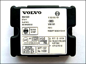

It's under steering column and looks exactly like this:
Only cars with chipped keys have it.

I've never seen it before, so would assume I don't has. Which just leaves me even more screwed. It ran fine the day that I lost my key. I came home, 2 hours later a mate picked me up and I lost it some time after that. Then the day after I started trying to get it going. Everything was perfectly fine running wise when I left. So I have no clue

Immobiliser problem.Logan360 wrote:The fact it fires then dies almost straight away, what does that mean to you guys?
I don't see your country flag....where are you from?
If you're from europe...you MUST have chipped keys.That immobiliser ecu is burried deep inside the dash and you will not see it if you don't search for it.

You MUST stop generalizing so much. I've never seen an 850 with chipped keys in Europe. They were an option, and the immobilizer for the 850s were something else than the later ones also, disabling the ignition and could only be disarmed by a special transponder key being inserted in the control unit.misha wrote:Immobiliser problem.
The control unit would be relatively easy to find, and have an LED light on it.
