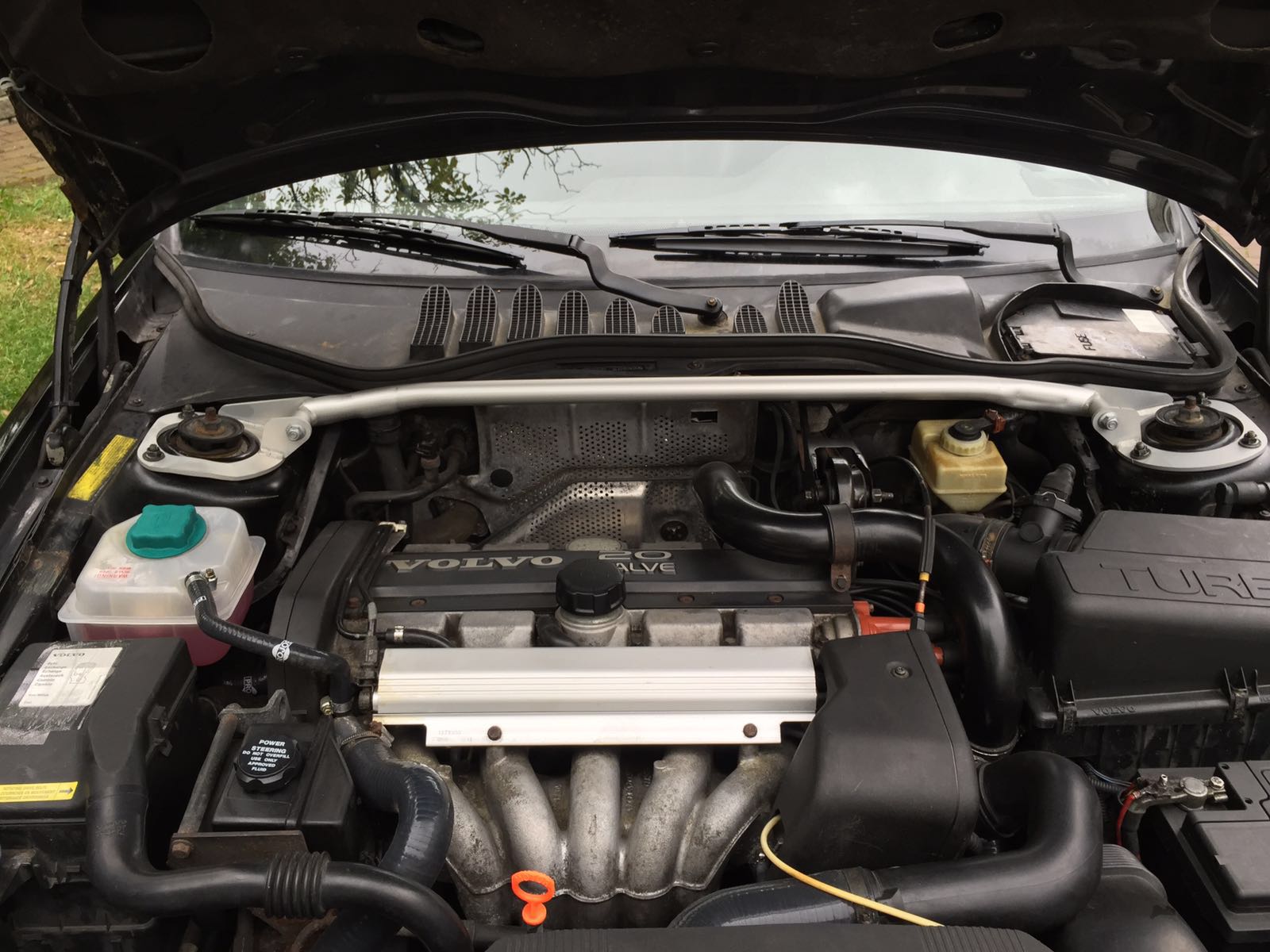

Jep, I replaced the sparkplugs and ignition cables. Rotor looks fine. (Almost brand new)
I'm thinking of replacing my ignition coil. (Should I contact the Renault dealership? I guess it's much cheaper to get a ignition coil there. The Bosch numbers are the same. :) )
Also, the turbo valve is from a newer volvo. Is that normal? I've had it connected the wrong way. I've had so much boost. The TCM disconnected the fuelpump. So I connected it right way. Now it's sloooooow. The turbo is only 40.000 KM's old. Also all the air hoses are new silicons.

If you've put new plugs in it, what kind are they, and where are the gaps set? Bosch and Autolite Platinums and these engines do NOT get along - like I said, this was when I felt that my transmission was going as well.
This is the correct routing for the turbo control valve. Either the circular or square design will work; hooking the vacuum lines up backwards will overboost and lead to a forced fuel cut by the computer.
Also check/replace your turbo air hoses themselves. It is possible to have a hole in these, leaking lots of boost, and a check engine light not come on.

I bought original Volvo spark-plugs and checked the gaps. They were ok.
Jep, that's the fuel cut I talked about. Also an TCM error code is enabled afterwards. And I used this picture to set it up. :) I replaced all the turbo air hoses already with silicon ones.
The only thing that I did not change are the spark plug rotor, distributor and ignition coil. Could these be the problem? I'm going to check that out tomorrow.
