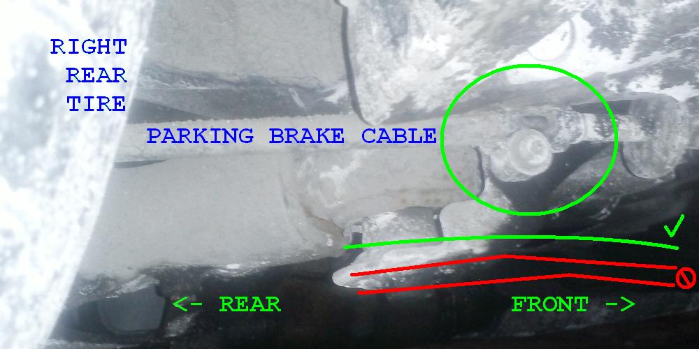

Before you embark on your parking brake job. Make sure you check out your parking brake cable. Check out this part of the parking brake system.
It sometimes brakes here and will necessitate a parking brake cable job. Cheap in terms of parts (approx $35 for two cables), but a whole lotta grunting and swearing! I still haven't gotten to it but the cables are sitting on top of my toolboxes, beckoning me!
Here's the tutorial:
https://www.matthewsvolvosite.com/forums ... =1&t=61043
Also, I don't think this qualifies as a stage 0 kind of thing, but you gotta swap out those old crusty shifter bushings. It makes the gearbox feel so much smoother!! https://www.matthewsvolvosite.com/forums ... hp?t=76272 Also, don't be afraid to dump out the old gearbox oil out and refresh it...
