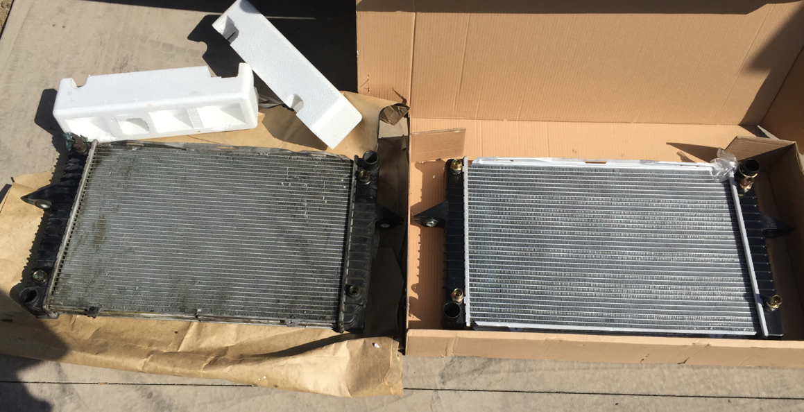

So last week my 2nd Volvo OEM radiator gave way. What's up with that? The aluminum part was fine, but the plastic neck connected to the upper radiator hose cracked clean through. This left my daughter (who drives the car now) stranded. My wife picked her up and I had to go tend to the car after work.
So in the dark, I was able to get it reconnected to the little bit of plastic that was there and drive the 20 minutes home. It was leaking a bit, but it worked long enough.
It took some poking about to get the proper radiator. I ordered it from the local auto store over the phone and when they were not sure which one to get, I had them order both of them. The multiple ones I ordered didn't have the oil and and transmission coolers. I started to compare the different radiators and one store had one that was for an XC, but it had the right coolers so I ended up getting one made in China! It had a lifetime warranty and I guess Volvo is owned by the Chinese now. :wink:

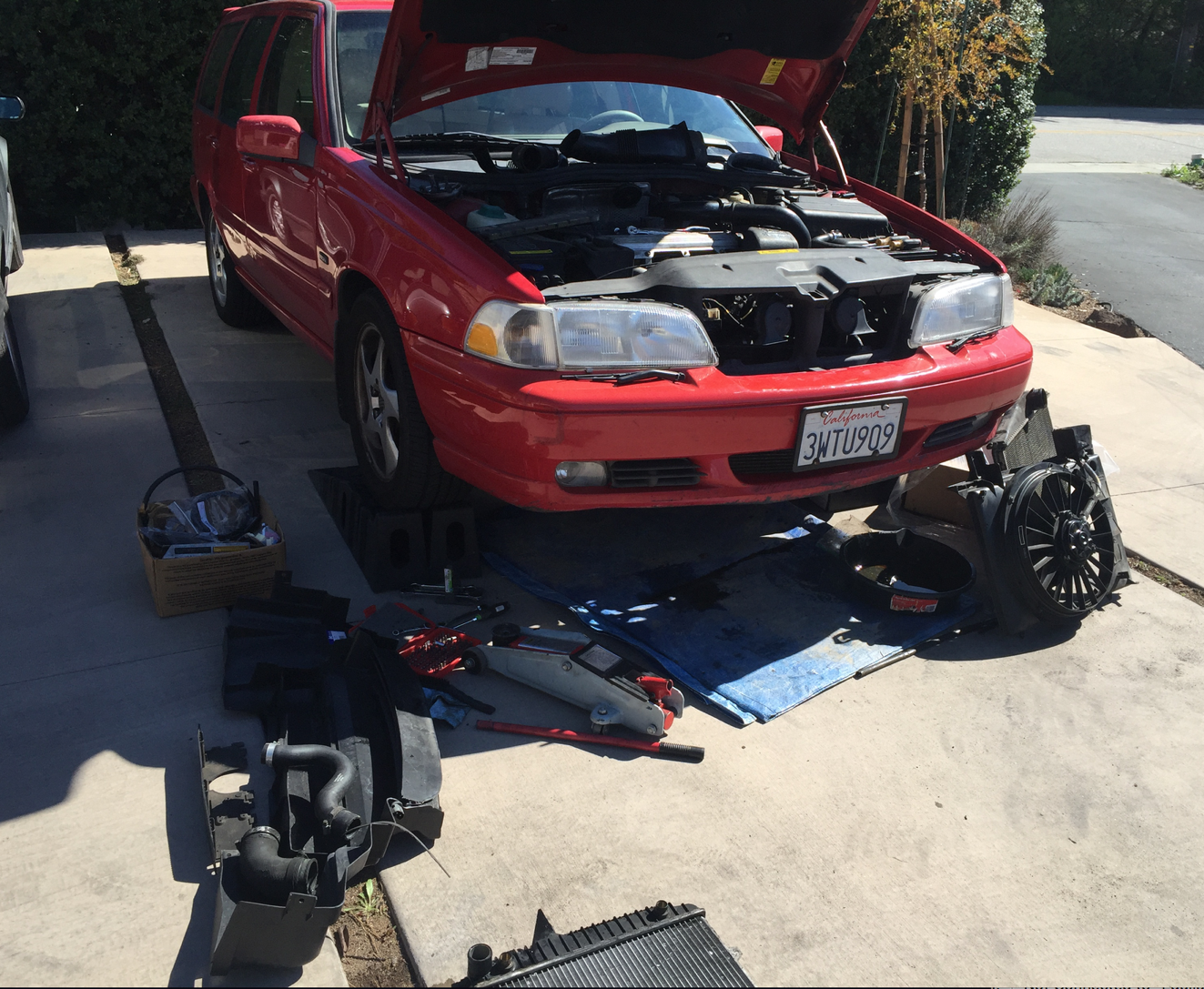

It takes a bit of doing to get the radiator off of the car. Here's what it looks like in process, a bit of a mess.
The radiator, turbo intercooler, A/C condenser and the electric fan are all connected to the radiator.
This is the scene in my driveway as I replaced the radiator in my V70 T5.
Here's hoping this radiator lasts the rest of the life of the car.
Old one had the plastic upper connector broken off. There was a metal insert,but it broke right at the end of the metal. The new radiator (made in China) is on the right.

erikv11 wrote:How long did the Volvo (2nd) one last?
1st radiator lasted until 88K, when it was replaced. So the second radiator lasted pretty long at 152K miles. Still, I'm a little surprised as the car has been in Northern California all it's life and the weather is not what I'd call "harsh". :P
Now the car has 240K miles and it's got a non-oem radiator (3rd one). It's got a lifetime warranty so we'll see what that means...

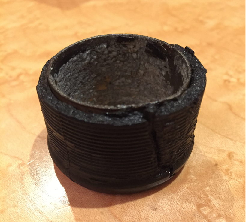

benpineapple wrote:When/how did the connector break, causing the problem described?
It broke right at the connection for the upper radiator hose. It looks like the plastic just fatigued. It was backed by a metal part, and the break was right where the metal ended.
Here's a picture of the part that came off.
Upper radiator connection where the break occured.
Rad Break.png (1.01 MiB) Viewed 1743 times

Wow - look at the corrosion on the metal part - What are you using for antifreeze??
If the corrosion got through , or on the backside of that metal ring it would fracture the plastic easily.
