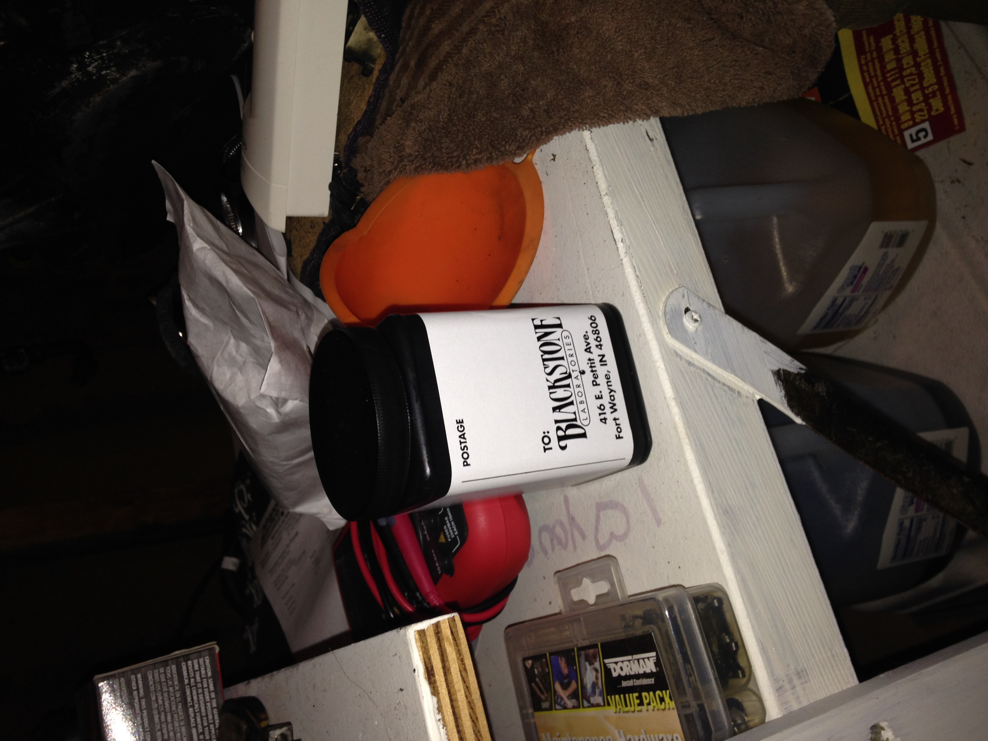

Sorry, I should have been more clear. I've already gotten to that point, I have the plastic container filled up and everything.
I just need to know how to mail this:
Will the post office let me slap a stamp on that and mail it?
