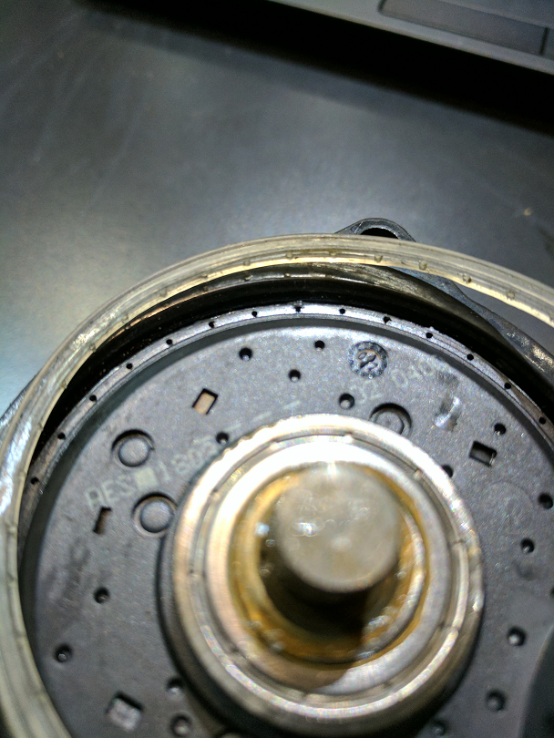

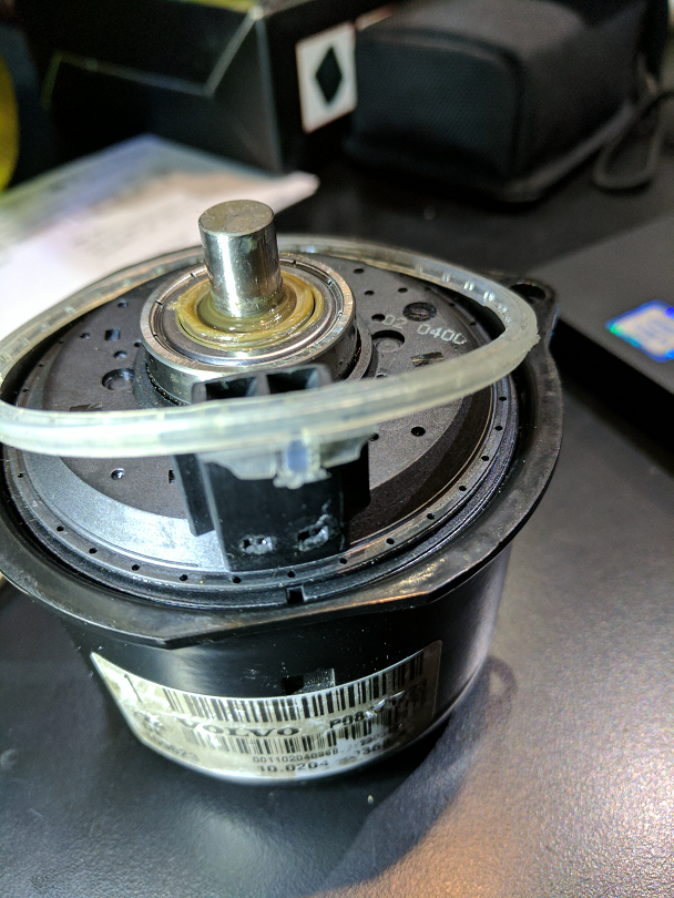

I finally figured out how to add attachments here. top to bottom in the photos is the motor, with the seal, and the pump with the seal still attached to it after i initially removed the motor.
Does anyone know how to get the seal back on the motor? There are a few dozen little nodules in the inside of the upper part of the seal that somehow go into the corresponding holes on the motor. Major PITA to get reinstalled, hence my big leg Emma dilemma.
Posts: 36142
Joined: 17 Feb 2013, 17:54
Has thanked: 1609 times
Been thanked: 4065 times
Is it possible you are overthinking it? That seal isnt a hydraulic seal, just a dust seal. I think I would just position it on the motor and then bolt it back to the pump head
