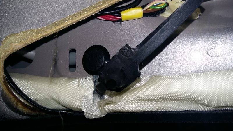

I went to have a look and here's what I've found. Side note, all my drains seem to be clear and work properly.

Front 2 corner sunroof drains are fine. Although front left runs slower. By the way I took off the plastic but i can't get to the tube anyway, it's behind metal... You can see it in the top left here before it goes behind the metal frame.
How do I test the back ones? Wherever I pour water into the sunroof drain just all goes forwards. I also cannot see the rear corner drain holes as the glass is in the way

Mines too pass through the A pillar, not accessible. I'd just plug a tube where the drains holes are on the sunroof frame, and blow or pour water
