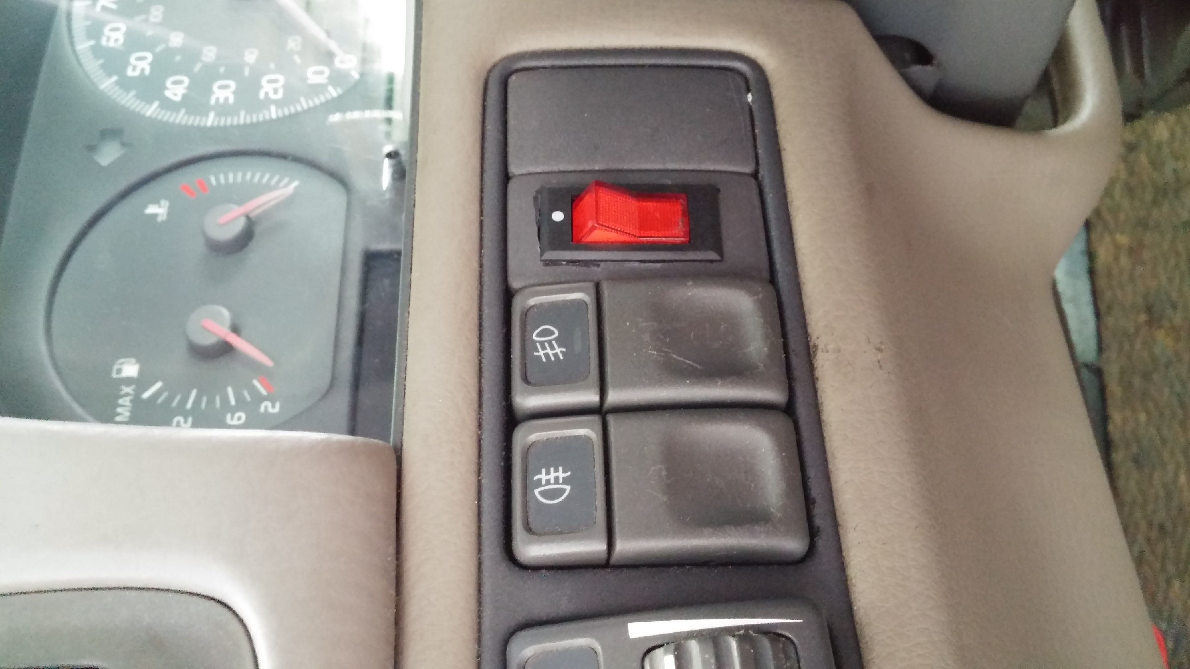

sleddriver wrote: In a sedan, you could add a button to one of the blank panels next to TRIP, SUNROOF, etc. Could also use a 555-timer IC so one brief touch would equal the pump running for however long you wished. Beats having to hold it down.
Pretty easy to fit a custom switch. It could be cleaned up a bit, but I put this in my cousin's car for some separate LED fog lights. Fitment is perfect, but there are still some cutting marks on the panel.
