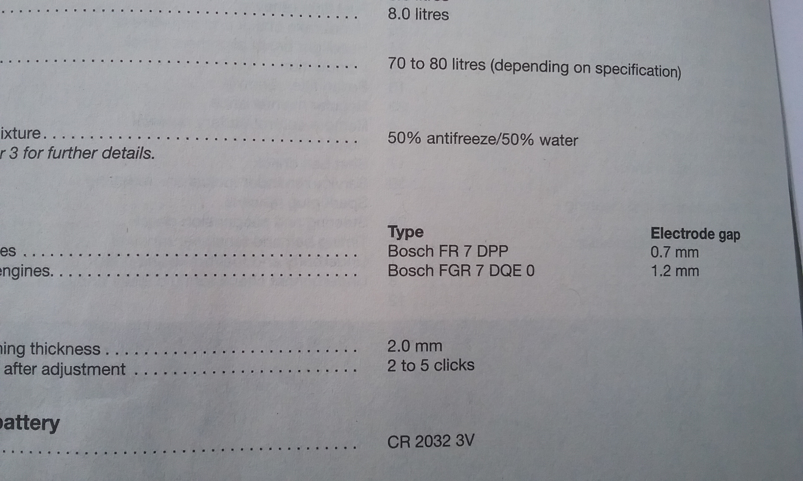

Glad to hear it's all better now. Were you running NGK copper cores?
I'm curious, what book calls out Bosch dbl platinum iridium plugs? I've never seen that specified.
- shiloh51933
- Posts: 1005
- Joined: 5 March 2010
- Year and Model: 04 XC70/'98 V70XC
- Location: New York
- Has thanked: 28 times
- Been thanked: 17 times
The NGK-BKR6EGP is the plugs I had in her. I installed them after replacing all the coil packs, TB,TB tensioner, TB idler pulley, WP, Coolant, TB cover clips and variable cam sprocket hub plug.chrism wrote:Glad to hear it's all better now. Were you running NGK copper cores?
I was getting spark but I'm thinking there was too much resistance at the plugs. Here's a pic of spec plugs from my repair manual for V70 2000-2007 & S80 1998-2006.
