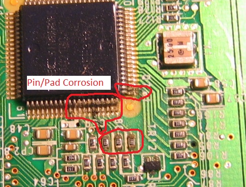

I decided to pull the ECC, remove the top and have a look inside. Found this:
Note the 6th pad to the left of the lower right hand IC corner looks like it overheated. MOF, it looks like the Cu trace burned all the way to the left-most resistor! Also, that bottom row of IC pins that are circled appear to have some sort of dust/fuzz/smutz combo in between them. Very odd that.
PO also had the dimmer setting on MAX: The board needs a good wash.

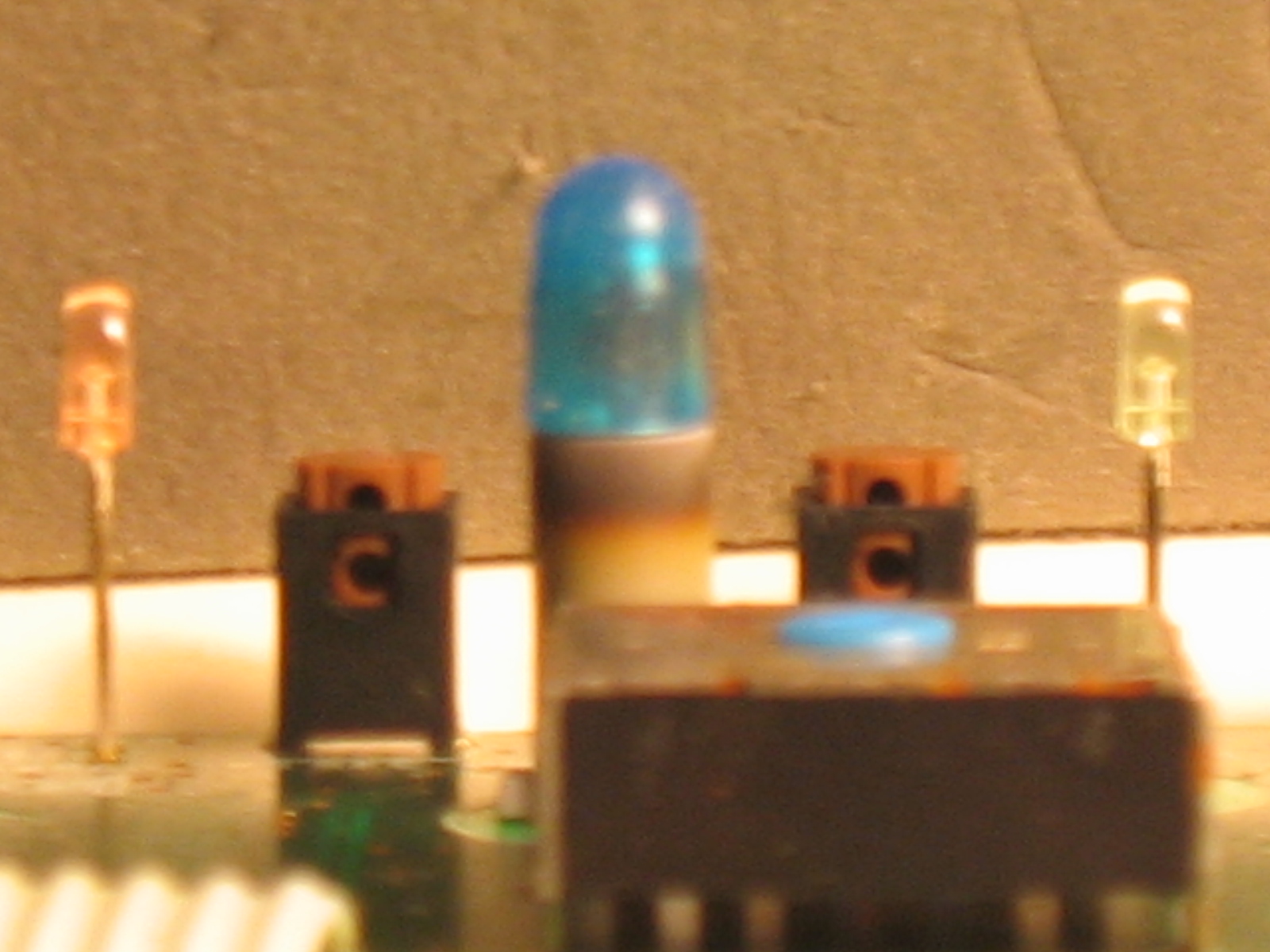

BTW, the ECC I pulled from the JY has ORANGE backlights instead of GREEN. Odd that. Even odder, is that as shown above the bulbs were covered in BLUE vinyl covers!! Removing those had increased the brightness.
