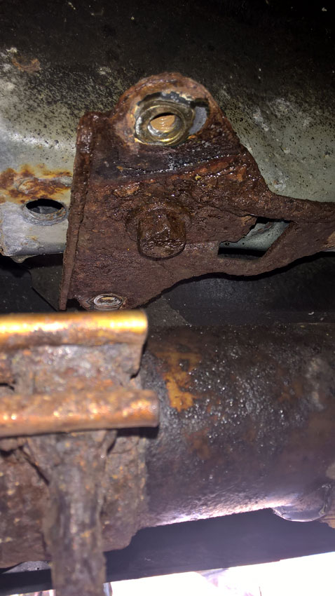

I am thinking the little hook on the new bracket will go into some hole (right by my question mark) and will be supported by this bolt. The bolt, according to the parts diagram is the same on ALTER 1 and ALTER 2. And after looking at it closely and inspecting it alongside the other bracket, that certainly seems to be the case. There is no way (that I can see) of using both rear bracket pieces...
I wish the bracket were flat, but if you look closely at the hook end of the bracket, there's an angle to it. Will it fit, who knows!! :lol:

Final update:
Finally had some time to get this done today. Was able to remove the two brackets without much difficulty. The 12mm head bolts holding 3547625 came out pretty easily. I did soak them in PB Blaster for over twenty-four hours. I don't think it's in too bad of shape, especially for 18 years.
Volvo 9434431 came out without much of a problem. I couldn't really lower the muffler too much so if I didn't have flex-head sockets, this probably wouldn't have come out so easily. I was surprised that the bolt head was an 18mm. Especially since the new OE is 16mm and the aftermarket version is 15mm... It broke loose pretty easy. Again, this had gotten some sprays of PB Blaster twenty four hours earlier.
So the real issue here was whether or not Volvo 9470686 would fit into ALTER 1 and ALTER 2. As far as I can see, it will. The little hook in this piece enters a hole that exists for mounting 9434431. For a minute I didn't think it would fit, but them after jiggling around, it went in.
This is what it looks like installed:
And this is what it looks like with a new hanger installed:
Whew... Of course, installing new pieces of rubber onto old pieces of steel took longer than removing all the old stuff. Just make sure to use plenty of silicone spray. Wipe down and brush off as much rust as you can. Spray some more silicone in there. And if you need to stretch the rubber hangers, try sticking a three inch 3/8 extension into the middle of the rubber hangers. Doing that gave me just enough clearance to slip them on. While under the car I noticed that the muffler was hanging from one about-to-break rubber hanger. Luckily I bought all four when I placed my order. So I replaced them all. They're good to go another 18 years!
One thing that happened: our car no longer makes that incredibly loud sound at 3k RPMS! I was going to replace the exhaust with something aftermarket just until I could do it the right way in the Spring. (I figured the noise was coming from that...) I am going to hold off on that. I wonder how many of us think exhaust noises are coming from broken mufflers and cats and not broken rubber hangers...
