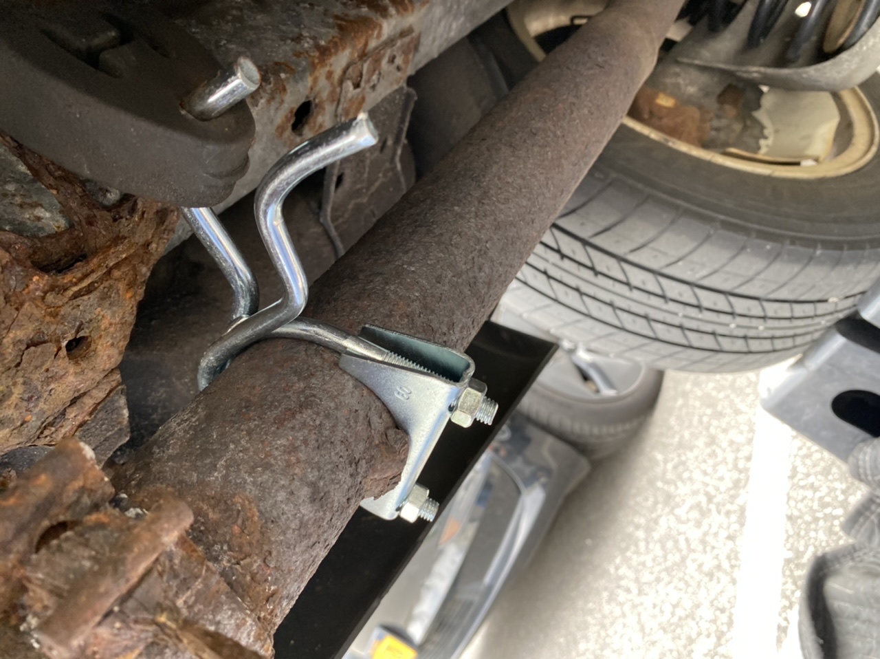

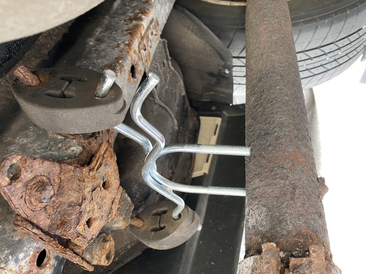

Replaced the zip tie fix on Evita with a pro part Sweden from FCP
Will,see how this holds up
1999 S70 rear exhaust bracket PPS

Wow that is crusty back there! I ended up replacing both parts with Volvo items. However, the Volvo hanger is the wrong size for an NA muffler system. I had to wrap the muffler with a piece of metal to pad it out as their bracket cannot be shrunk below a certain diameter. Have to say this is one case where maybe the PPS part is a better part! Never thought I'd ever say that!
What was wrong with the sturdy looking Zip ties? At least they don't rust!!
