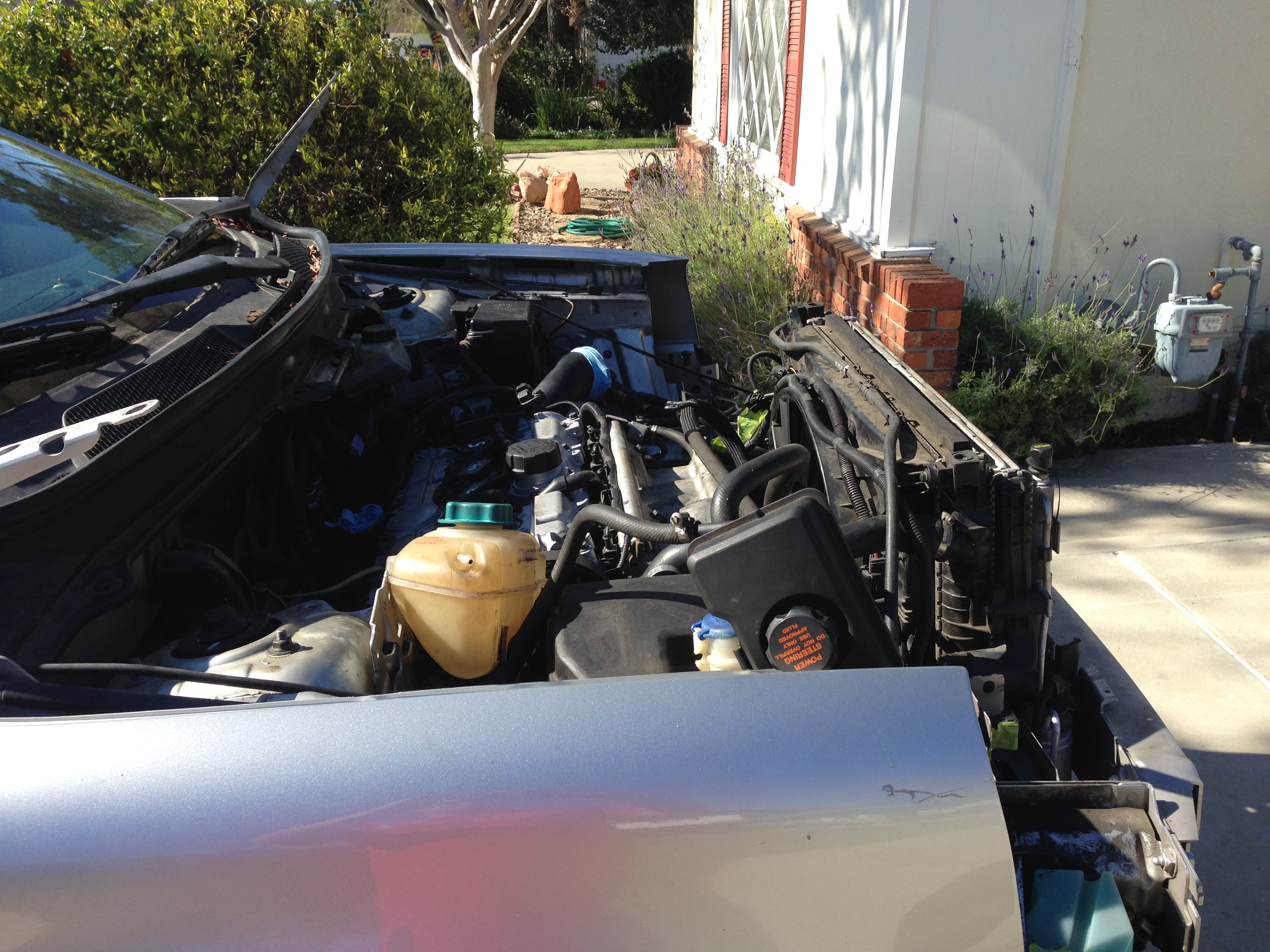

Started putting the car back together...

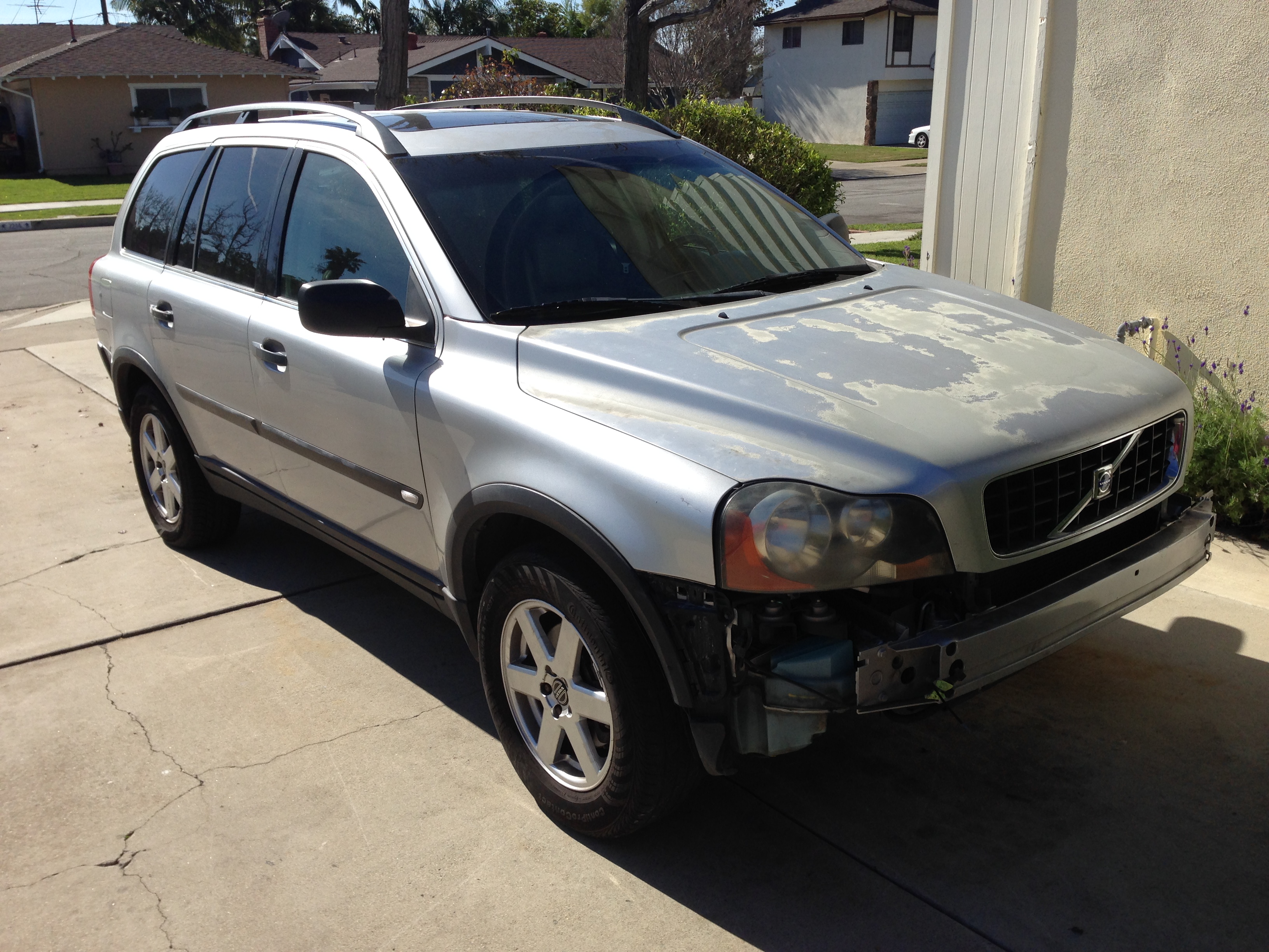

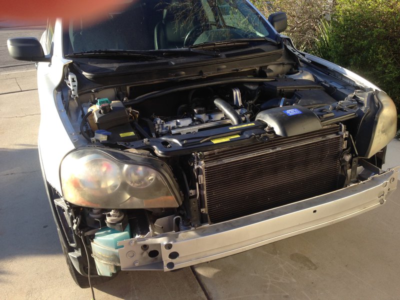

Starting to look like a car again. Left to do is mount hood, bumper and add fluids.

Great job Kallekula !! Did all that stuff have to come out? Could the motor have been pulled from the top without trans?

It is easier to remove the engine with the tranny attached. Once the radiator, intercooler etc has been removed there is plenty of room. I know Vida says to drop everything downwards but I thought it was easier to pull it out from the top.

Mounted the hood today. Have to replace the windshield washer pump so haven't fitted the bumper yet. Yes the hood looks like crap I know. Gonna get a cheapo Maaco paint.

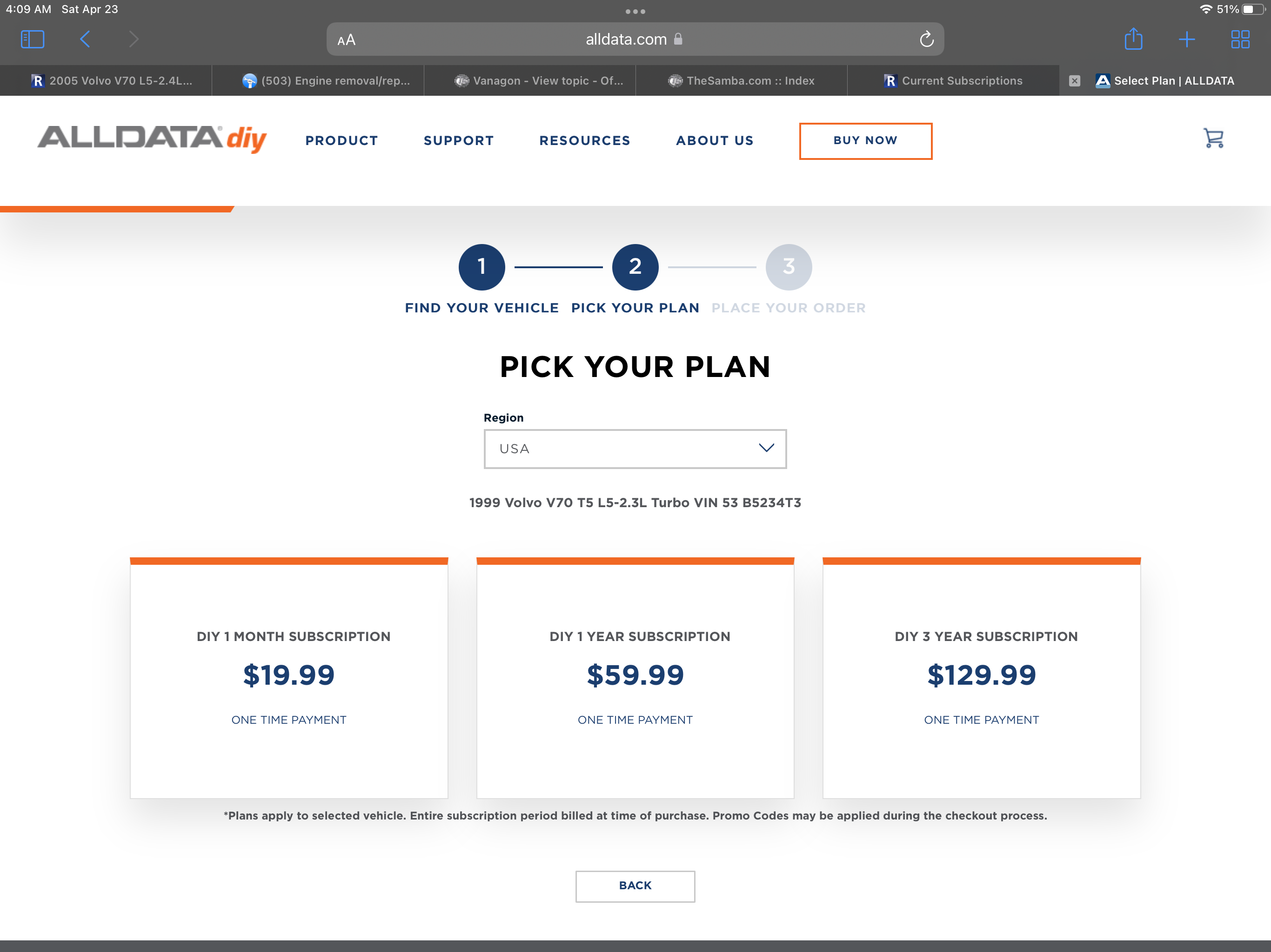

Alldata will sell you a 30 day subscription to complete factory procedures for about $20 us
For a big job like this that would be worth it

Hi thanks but I needed to be a company to proceed for help off that site…
