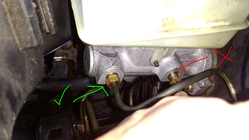

The holes that the brake lines screw into on the remanufactured master cylinder were different sizes!!! See picture below. I thought this was me.
I ran to local autoparts stores, no master cylinders in stock...
I didn't get to put my order into FCP till after 4PM so we'll see if they'll come through. What absolute bull. :cry:
There's going to be some SERIOUS air in these brake lines now... :cry:
Is this my fault? Are there different sizes for the brake lines on some cars? Did I order the wrong master cylinder? I have an ABS module for TRACS. (I had a TRACs light on a long time ago... but I have no TRACS button inside the cabin... so I ordered a Master Cylinder for TRACS). Or was this a refurbishing error? I ordered both models to compare.... Figured it didn't matter since I'm sending them back anyhow.

I can't think of why you would use different threads on a master cylinder. I'm guessing remanufacturing mistake

Just received another rebuilt Master Cylinder (Cardone 11-2843/ Volvo 9140897) and it has the same issue: the threaded hole closest to the brake booster is significantly wider than the 11mm brass brake line fitting in the car. Can I get some confirmation fellas? Are these two parts messed up?
From what I can gather, there are two brake master cylinders on FCP, one for cars with TRACS and one for cars without TRACS. The two that haven't fit are for cars with TRACS, so maybe that's the issue? (Even though I have TRACS... No button on the dash, but had a TRACS light on the dash which was remedied with a MattyMoo (TRACS) ABS module...)
The piece I pulled from my car is Volvo 9140251. Which doesn't show up anywhere, not even at Tasca...
I also ordered a brake master cylinder for cars without TRACS and that's arriving later today... Maybe that's the piece I need? Will update later.

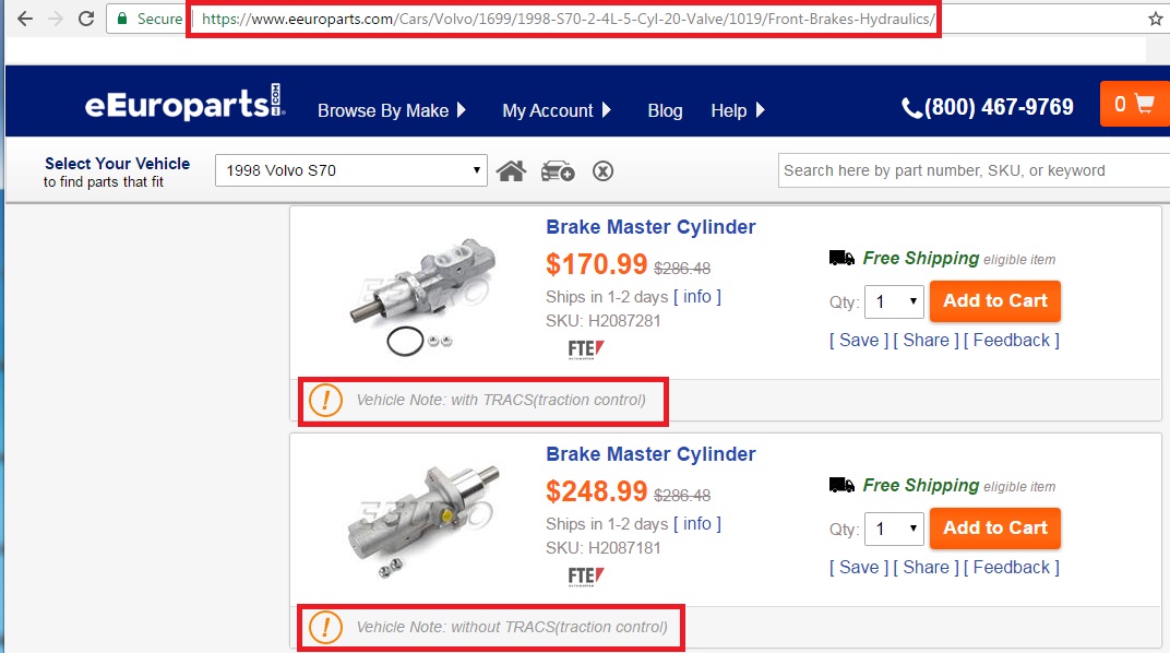

Master Cylinder is a critical item for obvious reasons: safety!
Eeuroparts lists 2 choices: with and without TRACS.
Your best bet is to call them, then ask them to open both boxes and email you the photos.
Find the photos that match your existing MC and order that one.
FTE (and ATE) is OEM mfg for the Master Cylinder.

If you do a generic search in that part number, several of the hits and say "without TRACS" so maybe you are honing in on it. Keep us posted.
Sorry I wasn't paying attention earlier ... let me know if there is any use in me pulling the one on my parts car - 97 auto with TRACS.
