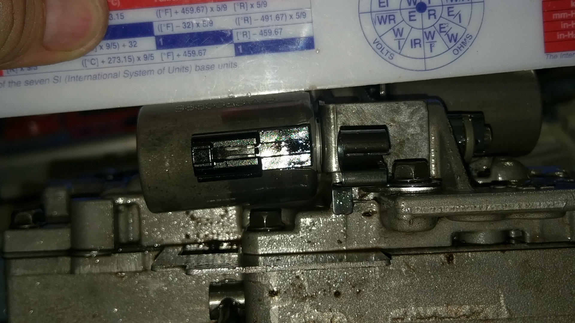

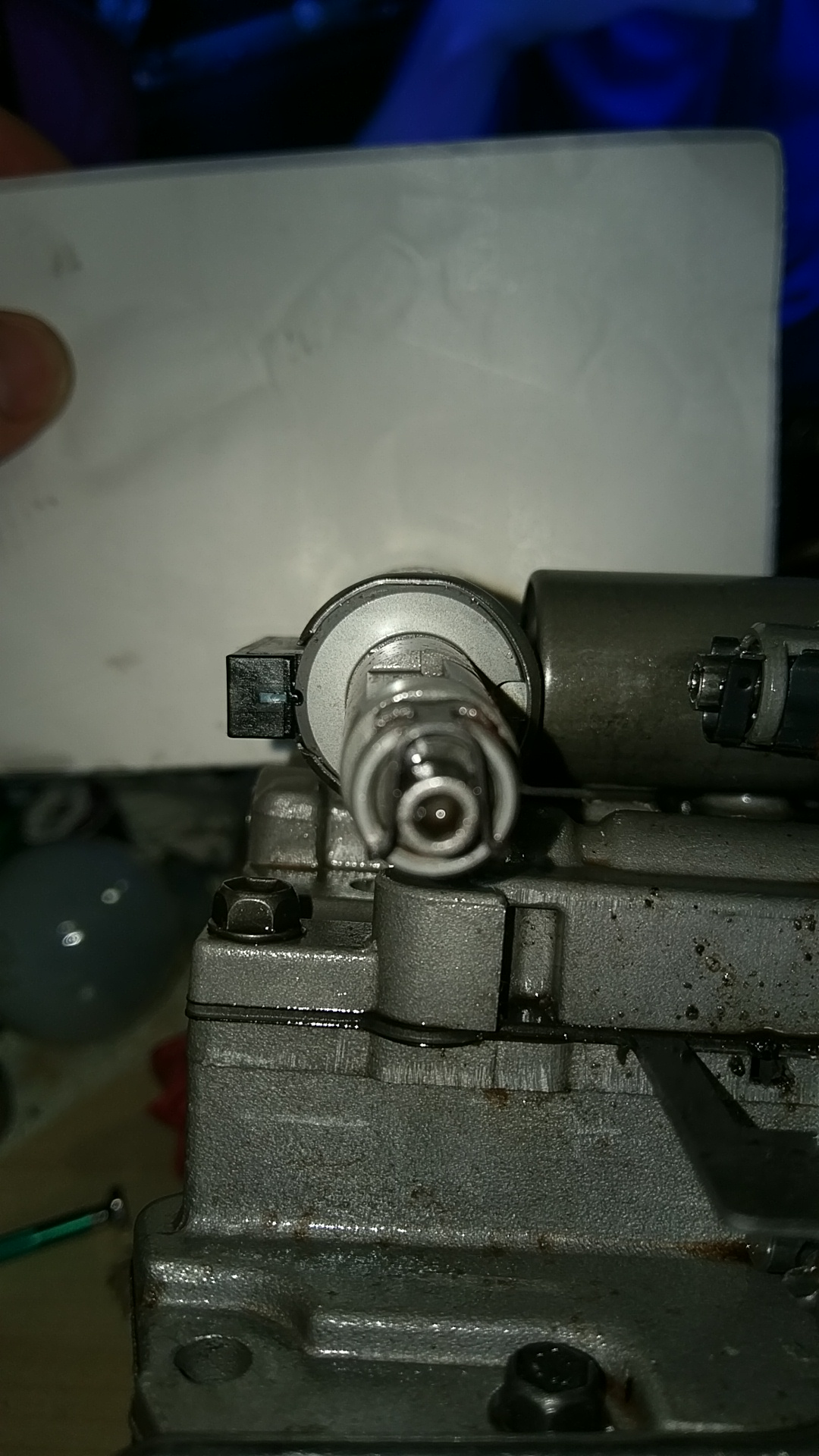

USPS strikes again. I think they have a mandate that any package that weighs more than 3oz must be treated like a football.
My Valve Body showed up and the box looked like they played soccer with it. I opened it with some trepidation.
It looked good... After all it's a Valve Body, right? Everything looked good until I looked at it in a particular way and noticed that all the SL Solenoids didn't line up quite right!
Turned out the SLU linear solenoid took a pretty solid hit and was partially separated. I contacted the seller and he's going to send me a replacement but it looks like the swap is going to be delayed for a few while I wait for it to show.

jimmy57 wrote: 19 Apr 2017, 06:59 So USPS turned a linear solenoid into a non-linear solenoid?
Well.... There's a interesting thought on that. I don't think they actually "damaged" it. Deformed maybe, but not damaged. Here's why.
The Seller is sending an exact replacement without issue (there are great sellers on eBay!!), So I figured I'd take a look and see just what the fuss is all about.
There are several tutorials on disassembly of these, so I grabbed a pair of my flush side cutters from my electronic kit and slowly peeled back the roll on the non-valve end. It unrolled easily and in a few minutes I had it apart.
I was surprised by what I found. The actual shuttle for the solenoid doesn't extend into the valve further than maybe 3/16th. There's a separate piston that does the work and the two meet at a rounded point. So where it was bent was actually between the joint and it was still capable of moving... Maybe not at 300hz it normally does, but it was still rattling back and forth. The actual work part of the solenoid was unharmed. So I straightened out all out. Gently rerolled the valve end of it and checked for accuracy. Perfectly straight. Proceed to clean it as many of the tutorials show and then rolled the far end back over. A gentle shake let's you know the actuator is free and moving that little bit.
Now.... I'm not using it since I have another coming, but if it was a ride or walk consideration, I'd have no issue reinstalling it and powering it up. They really are quite simple and I see exactly why they load up with particulates and fail. The only issue is their static adjustment and I have found several videos showing how to clone your original settings and another showing what the OEM (valve mfg) setting is which is where most all of them are set unless there's an issue from the build floor.

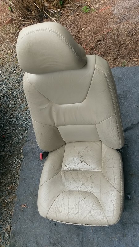

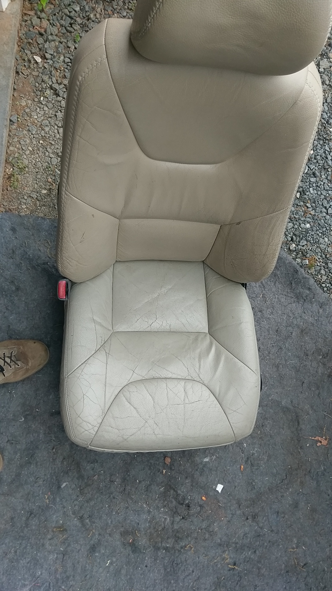

I figured while waiting for the valve to arrive I'd do a little bit of busy work on the T5.
I found a S60 in the yard with great seats that hasn't been messed with the other day, so during lunch I went down and grabbed the lower skins before someone wanted to see how well their knife cut!!
The color is a shade off, but I'll keep it for now and possibly get it dyed or just get a pad. You can't see it when you sit in it, so I'm not really worried. I'll keep the XC cover and see about getting it repaired (small 2" deep crack, but not torn through the backing) as I love the double stitching on them and it'll be nice to match the rest.
It only took about 30 minutes between both removing and installing them. The pad was in perfect shape (butt warmers still work!), so no additional repairs were required. Much easier than I thought it would be. There's a certain mysticism about interiors and I know my limits... hog rings isn't one of them though!!

abscate wrote: 21 Apr 2017, 08:03
Where did you find Green leather seats??
My father warned me to stop that or I would go blind - I told him "Im over here, Dad"
LOL!!!! :lol: :lol: :lol: You looking at your iPad on Night Colors again?
Yeah... they do look a bit peaked though, huh?
It was a very overcast day, so between the clouds and the blue/green of the 98 sitting right in front of them, I can see how that tinted them a bit.
I don't know my Volvo interior colors by heart yet, but the XC donor was a creamy light brown while the S60 donor had a darker tan interior. I'm sure there are official names for them, but this car is such a patchwork currently that I'm just going to get it done and then blend up a Cerakote color that matches good that I like. Thinking like a Desert Tan I've done for a couple of customers.
Something like this Desert Tan!
That will match the leather of the XC pretty close and then I'll get what ever remains dyed to match.
