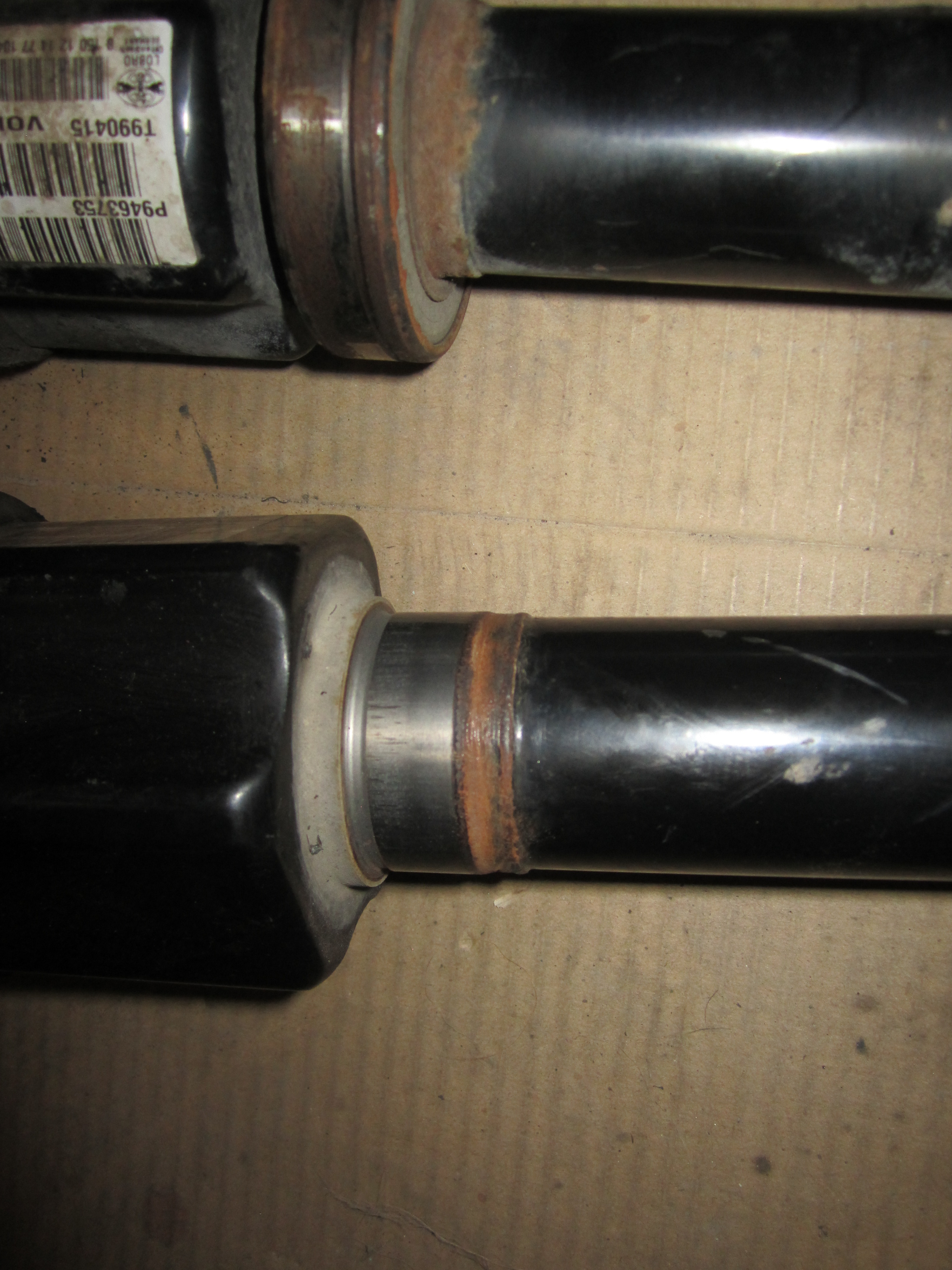

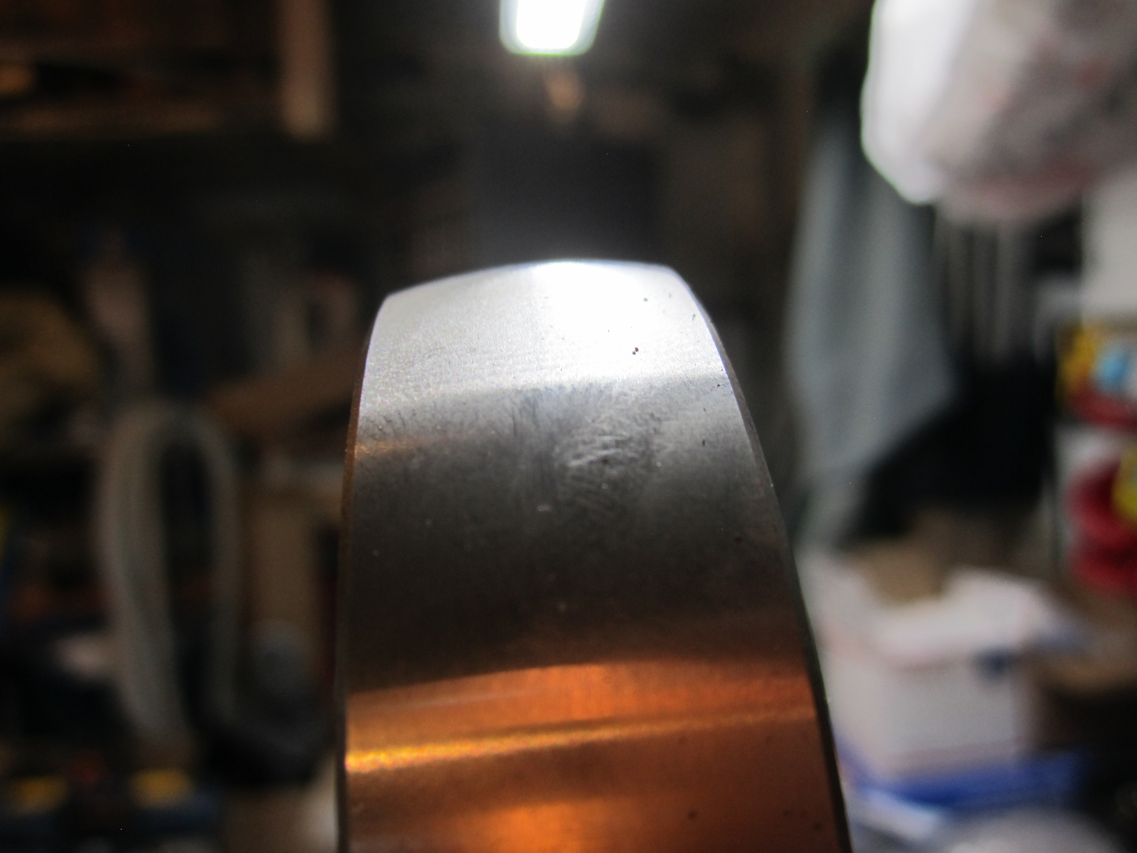

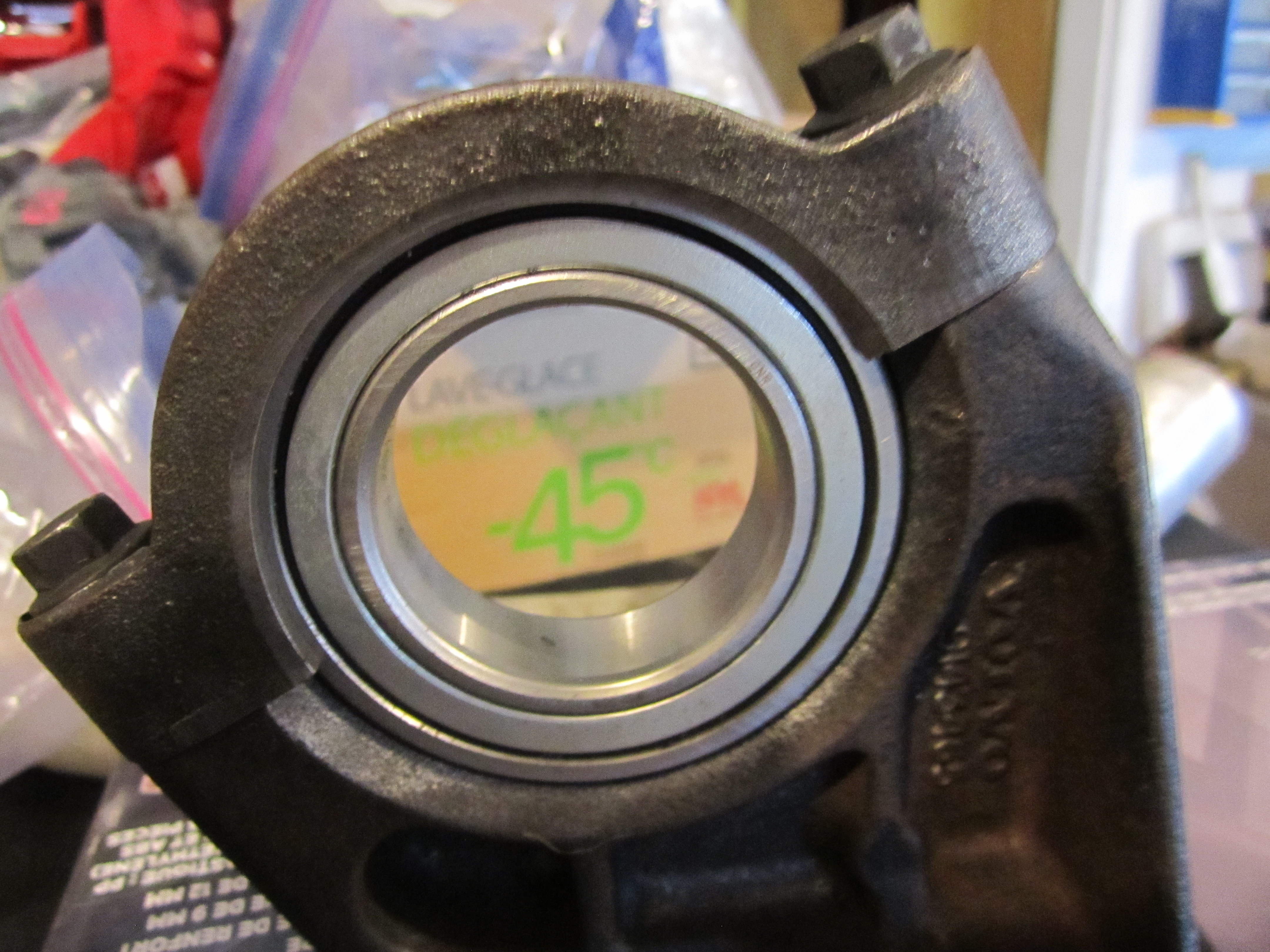

On my return from vacation, the dealer was quieter so the foreman told me to bring the axle down to see if they could pull the bearing for me. Good news was they were able to do it, but hit a snag with the new bearing. I had not opened the box and checked the bearing closely, but it turns out the outer race has a curvature and is not flat as per the original. So today I took a spare carrier bearing support down so we could see if that made a difference. Good news is that the carrier bearing support covers the outer sides of the bearing that is important to the sideways (length ways) motion of the axle (which should be minimal any way).
The dealer foreman had a young apprentice tackle the project of pulling the old bearing off. He carefully cleaned the old rust off the bearing area, and then using a puller fitted to the back of the outer race, pulled the bearing off fairly easily he said. That was the 'test' axle so now they will do the 'good' axle today and then I can fix the new bearing in place and keep the axle(s) for spares or sell them on. The guys at the dealer have been great on this as they now prove the carrier bearing can be removed from the later axles, and that we can find workable bearings a reasonable cost that work. Finally, they were great not to charge me as it gave the apprentice a challenge he would not normally see.

This and the picture below show the bearing is well supported and does not appear to move in the carrier support
Above you can see the slight curvature on the outside of the bearing outer race. These bearings were spec'd for a Ford Fiesta or a Ford Transit.
