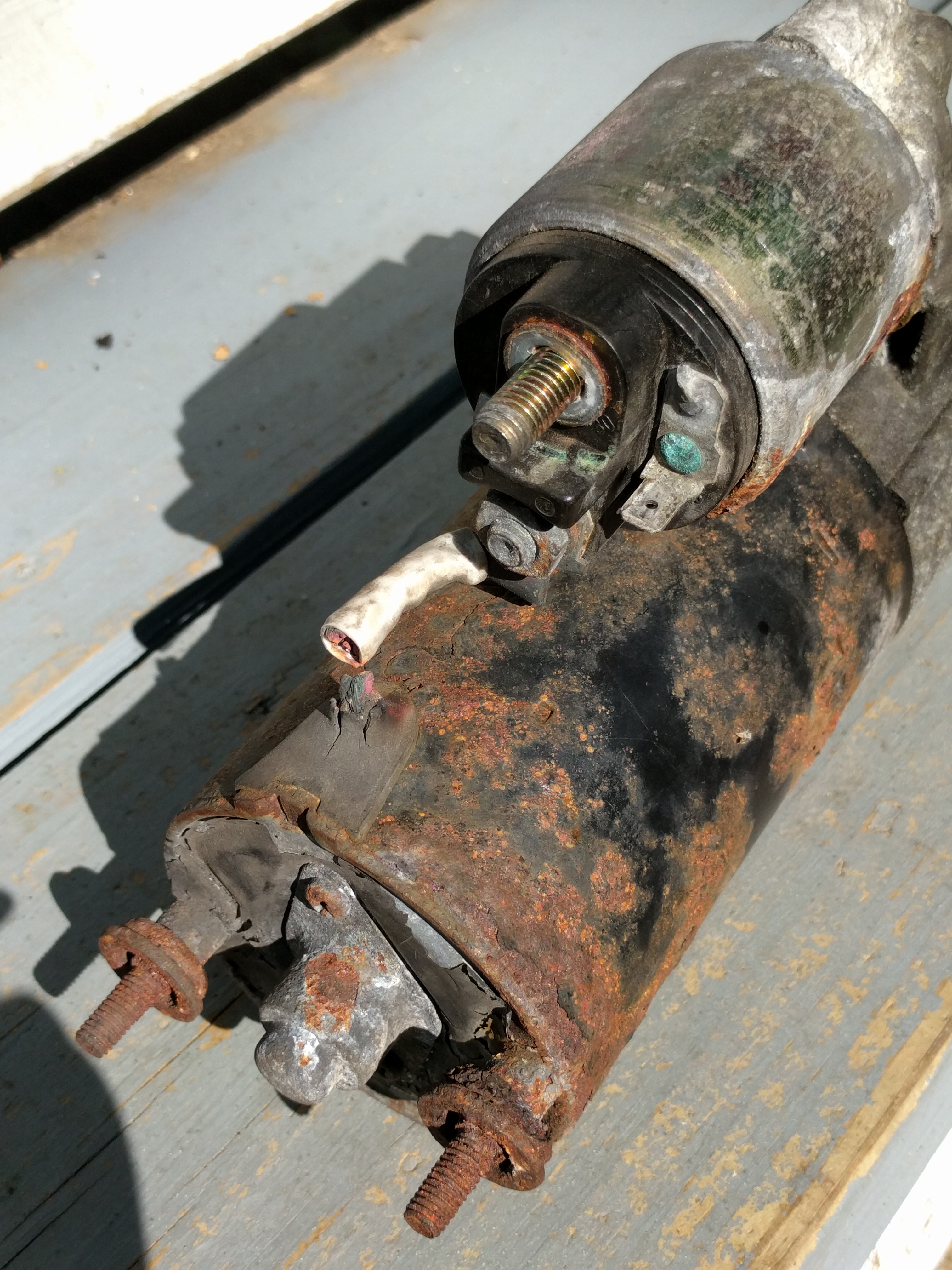

New starter installed. Car started right up. It even starts faster with this new part.
The old starter must have died from corrosion to the 2" cable between the solenoid and the motor. After removing the starter, I pressed on it and it crumbled. It must have been unable to deliver the electricity due to its corrosion.
How can we prevent this corrosion on our new starters, which are the exact same design as the old ones? Petroleum jelly or hot glue on the exposed ends of the wire? Thanks.

I've had a couple of cars have starters fail this way. One common symptom was a slight delay, about 1/2-1 second between turning the ignition switch to start/crank and the actual cranking action. It usually preceded failure by a few months
A starter bypass won't help you with this of course, since the current between battery and motor is interrupted by this failure. That was the useful diagnostic here, if course

You could spray the area with undercoating or yearly with ACF 50 as a preventative measure - but ultimately, it is going to fail eventually. I figure if I get 10 or more years on a starter, it owes me nothing.
