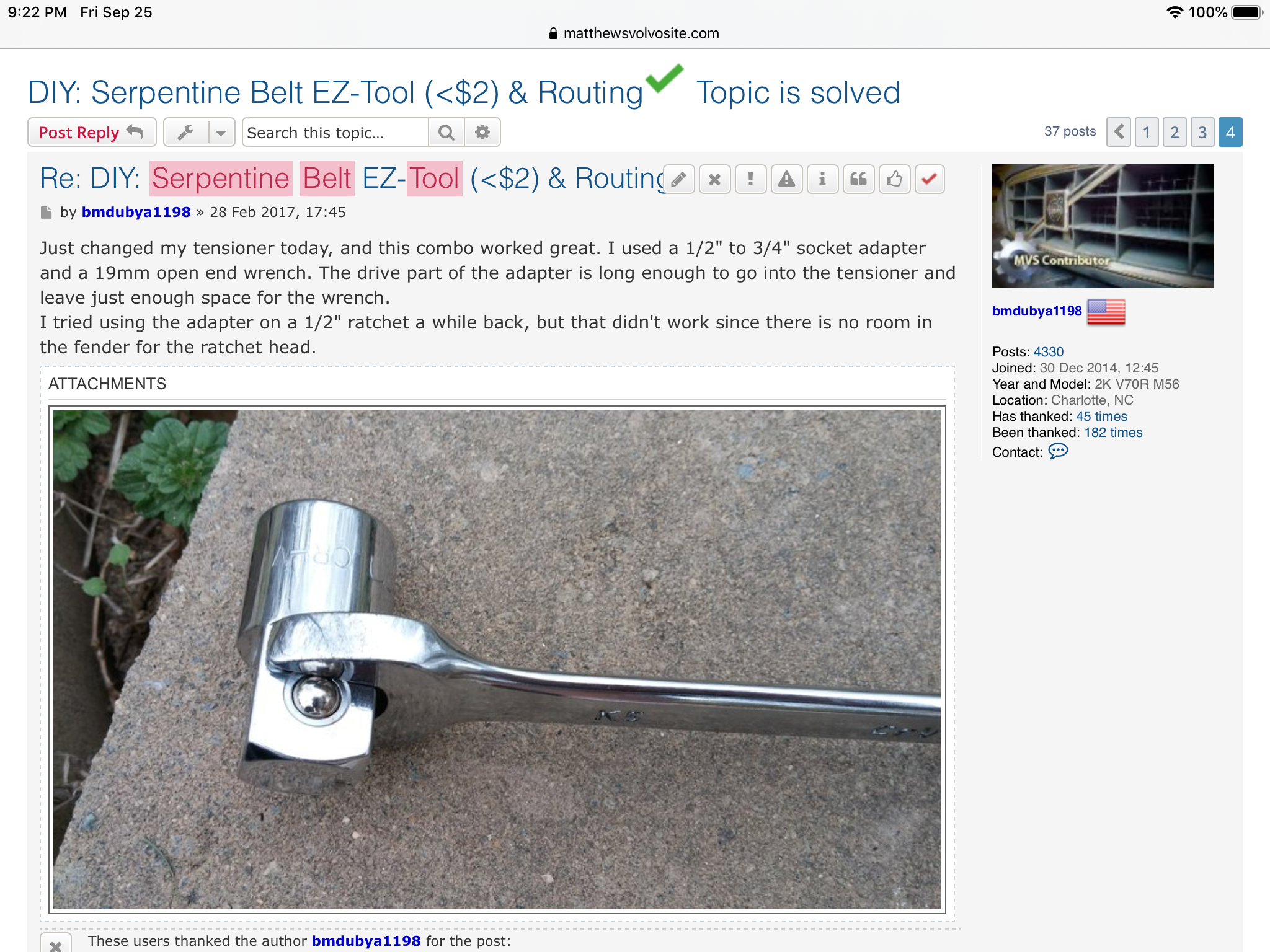

What I always do to release -'98 tensioners is use my 1/2" to 3/4" adapter with a 19mm wrench on the 3/4" portion. The key is to only seat it far enough into the tensioner to engage it, and leave space to grab onto it with the wrench.
A 19mm crowfoot could do the job of checking torque if clearance allows.

You took a grEat picture of this for clarity Earlier.bmdubya1198 wrote: 25 Sep 2020, 08:43 What I always do to release -'98 tensioners is use my 1/2" to 3/4" adapter with a 19mm wrench on the 3/4" portion. The key is to only seat it far enough into the tensioner to engage it, and leave space to grab onto it with the wrench.

I remember posting about it, just not what thread it's in. I think it was specifically about a tool for that.abscate wrote: 25 Sep 2020, 11:19
