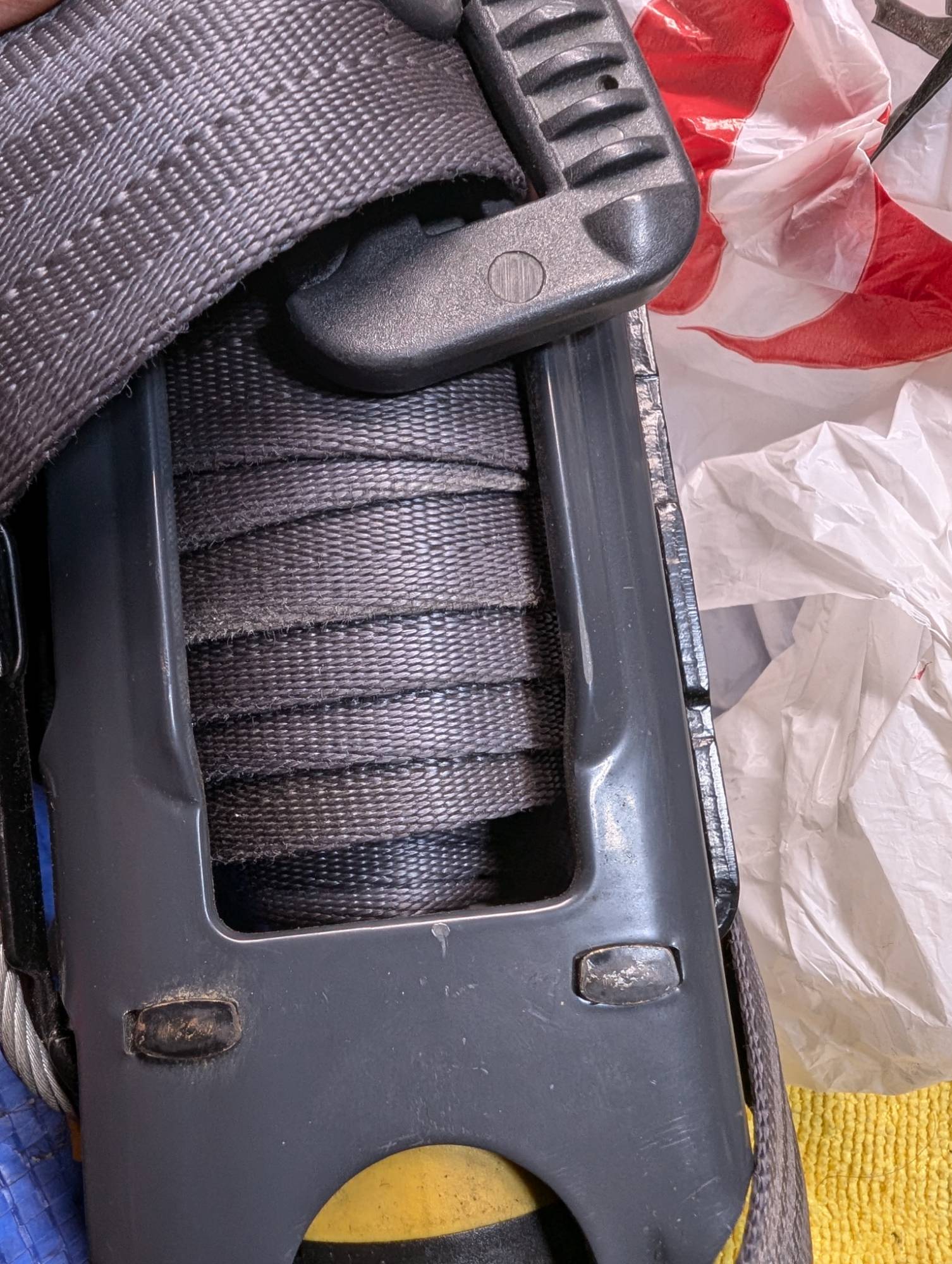

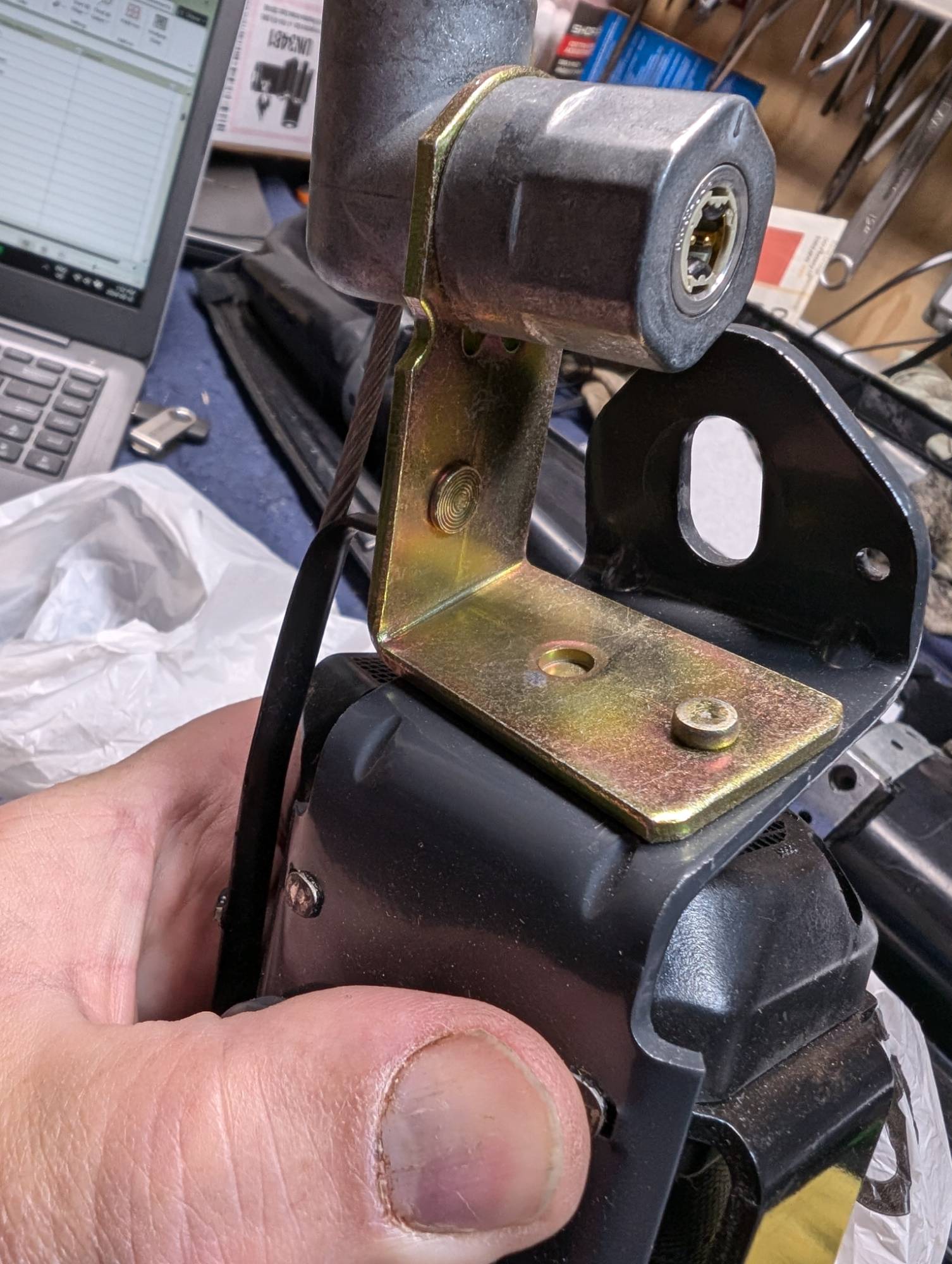

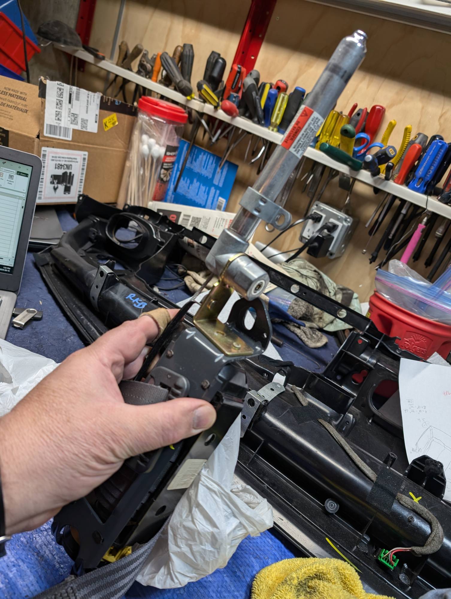

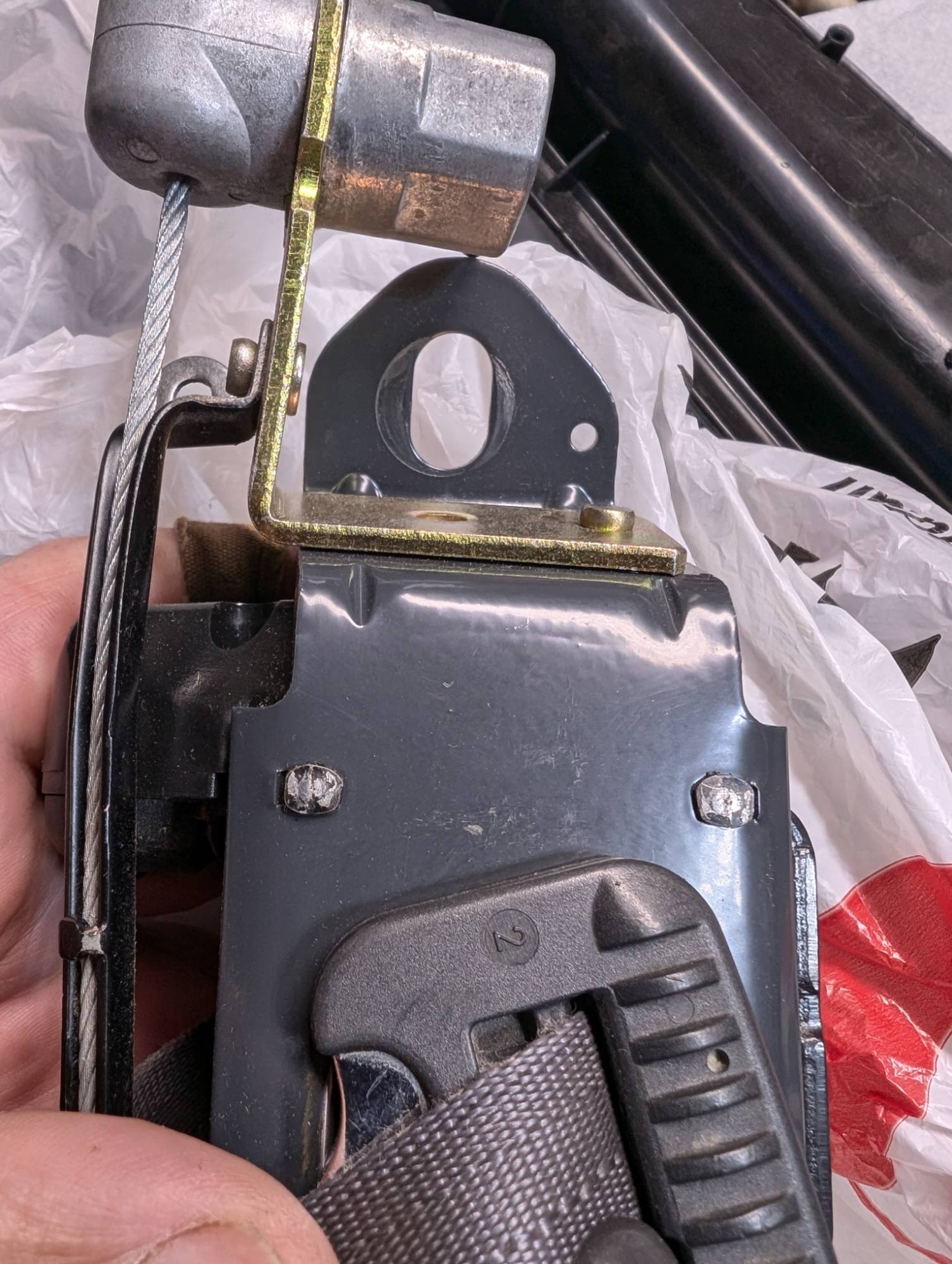

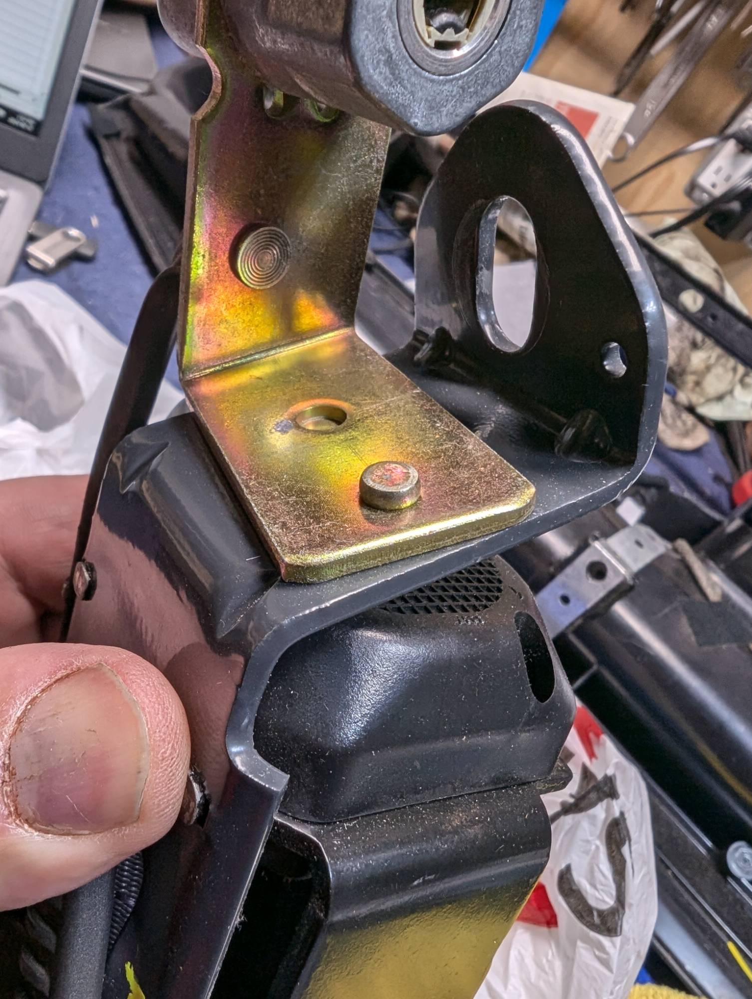

AS to your question on if it can be disassembled to swap a belt over from another, it would be very difficult and I would recommend against it. Here are a few pictures to show why:
You can see in the pictures that along with the rivets it is also swaged/peened on the frame holding the belt and firing connection.
Anyone know how to tell if the belt has been activated? Other than this won't un-furl, there is no obvious (to me) signs. Does the wire on the side to the bottom tighten when activated and should it be loose?
