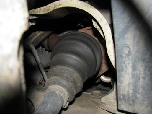

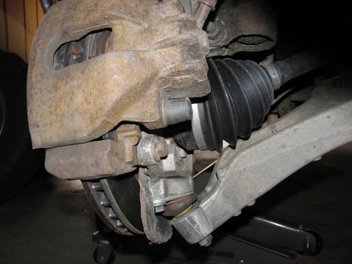

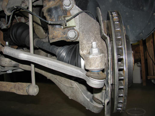

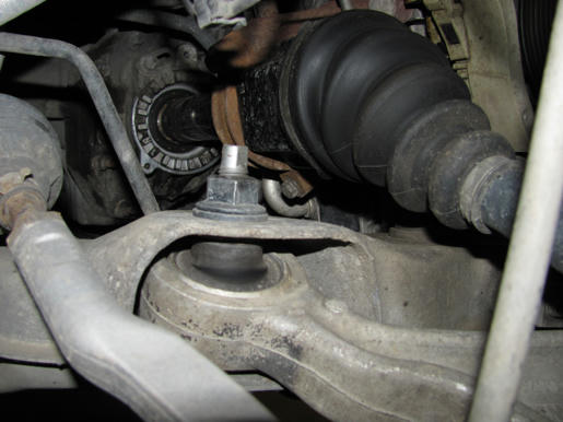

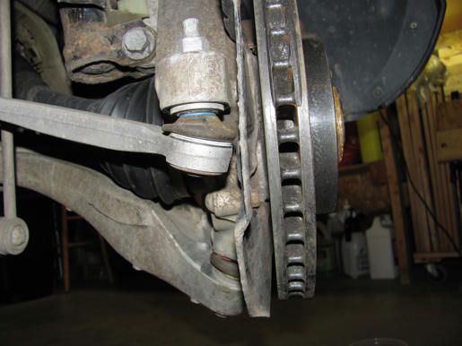

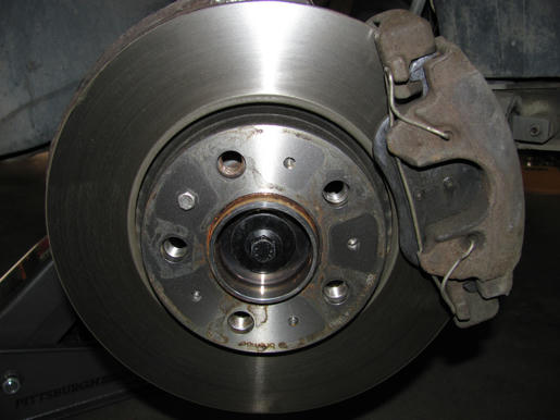

Some pictures of the suspension assembly I just took.
Alex
I cannot see anything that might be causing that squealing noise, however during the parking lot drive we did yesterday, afer having tried turning of the left to re-create the noise, we noticed that soon after it did it while turning on the right, but the noise still appeared to come from the right wheel.
Today I will go for another ride and see if I can get any additional hint.
Alex

While inspecting the rotor shields I noticed that the bottom part of both of them was about 3mm from the rotor, so with very little hope that they were the root cause of the problem due to them touching the rotor, I just bent them to make this distance as bigger as possible, about 6mm.Davezx6r wrote: 25 Oct 2017, 13:56 If I heard the sound from the video correctly it sounded more like almost a squeal. Stupid question maybe but did you check the rotor shields to make sure that they aren't rubbing against the rotor? I have had that happen before if they get bent during repairs just enough to almost touch the rotors. And then for whatever reason, they make contact when the wheel is turned. Other than just guessing I would say get the car up in the air and see if it makes the same noise. It should be a lot easier to pinpoint that way.
Guess what, squealing disappeared
Like Dave said in his first post above, for whatever reason, they make contact when the wheel is turned, but only when the car is moving because when I turned the steering wheel and the car was jacked up, the shields were not touching the rotors.
Anyways, all's well that ends well.

I notice the control arm bushing is starting to tear already. Was that bush OE or aftermarket?

I think it is the picture, they are the genuine Volvo ones, I did not notice anything wrong when I looked at them.mrbrian200 wrote: 06 Nov 2017, 00:38 I notice the control arm bushing is starting to tear already. Was that bush OE or aftermarket?
After two months I would be

by the shiny bolt at the top, I would say this looks to be a recent replacement control arm. the darker looking rubber area looks suspect to me as well. What is it stamped on the ca?mrbrian200 wrote: 06 Nov 2017, 00:38 I notice the control arm bushing is starting to tear already. Was that bush OE or aftermarket?
