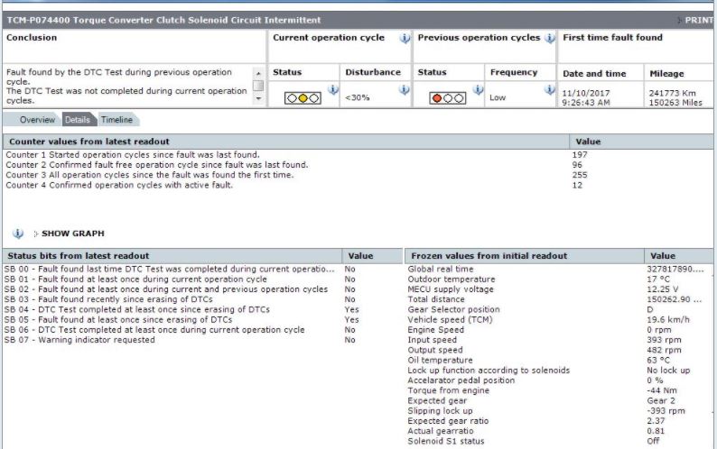

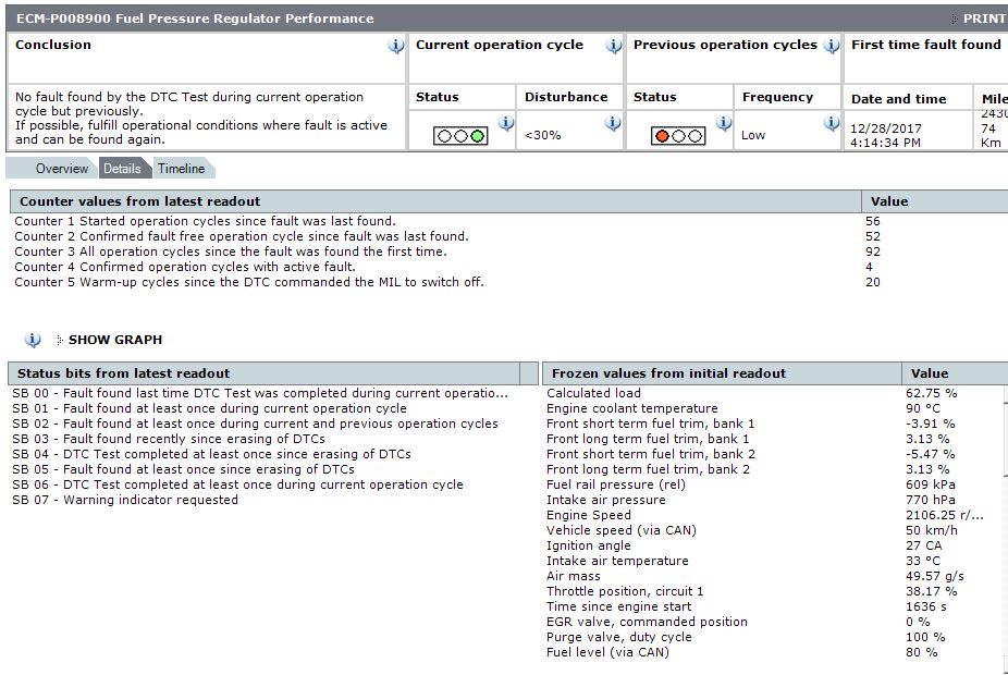

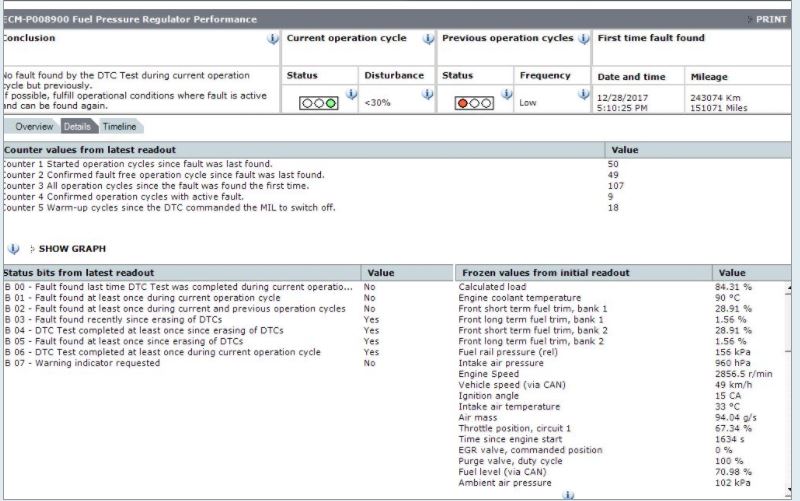

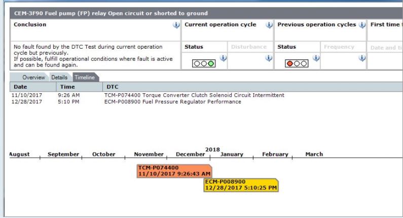

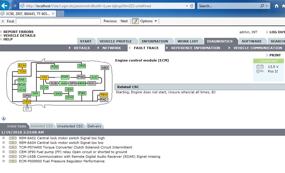

Ok, so it is my first time using the software, so I hope I got enough info to add to this diagnosis.
Please look over the screenshots and let me know what you think or if I should try to pull additional data.
NOTES:
-I've indexed the images with numbers so you can refer to them by the numbers.
-The torque converter code (00) I attribute to the first time the fuel cut out as it didn't recover until I pulled over and shut it off. IIRC no codes were thrown on this instance.
-The timeline only shows the last instance P08900 was thrown (12/28/17). I erased it using the OBD wifi unit. IIRC the code only popped up 2/5 times.
-I am not sure about the time on image 05. I was taking my son to the ER when it happened, and we were at the hospital <10minutes after (filled up with gas to "fix" the drivability issue). Image 04 time should be correct. Thank God that happened close to a gas station. I didn't start the car again until 1am or so.
-Very uneven capacities in the tank(s).
-No change (nominally) in fuel pump duty cycle under load.
-Fuel pressures: Patm= 101 kpa, 609kpa = 88 psi, 480 kpa = 70 psi, 413 kpa = 60 psi, 380 kpa = 55 psi, 156 kpa = 23 psi
-Fuel regulation reference: http://workshop-manuals.com/volvo/xc90_ ... operation/

- 00_FAULT-TRACE-INI-STATE.JPG (108.26 KiB) Viewed 7590 times
- 03_CFM-3F90_OPEN-FAULT_150542_MILES.JPG (88.45 KiB) Viewed 7590 times
- 04_P009800_609KPA_12-28-18_4-15pm.JPG (129.79 KiB) Viewed 7590 times
- 06_LIVE_DATA_STATIC_IDLE.JPG (54.24 KiB) Viewed 7590 times
- 07_LIVE_DATA_STATIC_2800RPM.JPG (59.02 KiB) Viewed 7590 times
- 08_LIVE_DATA_DYNAMIC_GRAPH.JPG (71.64 KiB) Viewed 7590 times
- 05_P009800_156KPA_12-28-18_5-10PM.JPG (77.14 KiB) Viewed 7583 times
- 02_DTC-TIMELINE.JPG (54.99 KiB) Viewed 7583 times
- 01_TCM-P074400_11-10-17.JPG (76.03 KiB) Viewed 7583 times
2007 XC90 V8 SPORT 151K

If you have the opportunity, go into the Delivery tab and erase all codes (follow instructions so they're actually erased) then see what pops up as legit.
For the difference between fuel tank senders, entirely possible the driver side sender has some wear on the rheostat, replaced mine on the '05 a few years back, after a DTC popped up from time to time. Makes no overt difference to driving, at least as far as I've been able to tell, just makes the level closer (and they'll never be exact). Could be something I'm missing but in reality were this to come up again, I might just have lived with it. Can see link for my story- http://forums.swedespeed.com/showthread ... Difference, since you're not getting a DTC on this, probably nothing to resolve.
Another description as to how the fuel system works in VIDA- Product Specifications/Design and Function- 284: Engine control module (ECM), B8444S.

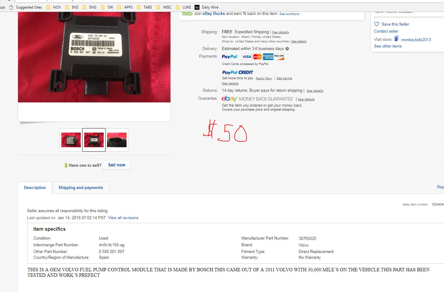

MINOR UPDATE...
- I received the controller (PEM). How was it tested...The ebay seller indicated they were fixing a problem on the host car and tried a new PEM which did not fix the problem. Since they installed the new one, they sold the old one.
I erased the codes in VIDA. - -TEST DRIVE- I haven't been driving the car much, but last night I warmed it up for 15 minutes and then drove for approximately 5 minutes @ 3k rpm in 2nd gear. No issues.
- I'm hesitant to put the replacement PEM as it would add an additional variable.
- I've posted the volvo functional description for reference.
