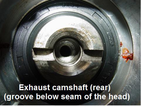

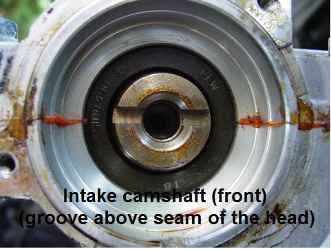

Absolutely go with the crank lined as a first measure. Make absolutely sure that crank is on the mark. If the marks provided by other bozos on the cams (usually in white-out) don't provide the results as in the pics provided then just turn the cams until they are where they should be.
The cams will free spin on these engines with no piston contact when crank is on mark regardless if the timing marks are made incorrectly or 180 degrees out of phase.
Didn't notate hydraulic lifters position

- Intake.JPG (35.15 KiB) Viewed 2160 times
- exhaust.JPG (34.68 KiB) Viewed 2160 times
