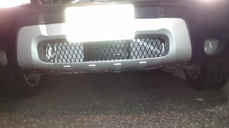

Transmission fluid gets over 110 C real easy in summer, 120+ in a hot day. Degrading properties of ATF is not a problem, the problem is a few places in transmission that get overheated or oil starved because of thin hot fluid. Slack in a differential, bearing noise, pressure loss is what usually happens at the end.
Hayden transmission cooler looks good and can be mounted without piercing the other radiators.

Thanks for the suggestion! I am still bouncing around the idea of an external tranny cooler. Quick question, did you have take off the front bumper in order install the tranny cooler.vtl wrote: 28 Feb 2018, 05:48 Transmission fluid gets over 110 C real easy in summer, 120+ in a hot day. Degrading properties of ATF is not a problem, the problem is a few places in transmission that get overheated or oil starved because of thin hot fluid. Slack in a differential, bearing noise, pressure loss is what usually happens at the end.
Though I do have say the car is running very smooth after the flush. Like I said before I thought it was running fine before the flush but after the flush there has been definite improvement.

Please describe the procedure. Are there plastic clips, mushrooms or expanding pin fasteners one should buy in advance?
The last part is because I live near a competent auto body supply house which has all the fasteners you could ever imagine mounted on the wall.....MUCH cheaper than going to the dealer or buying them in 4 packs.
