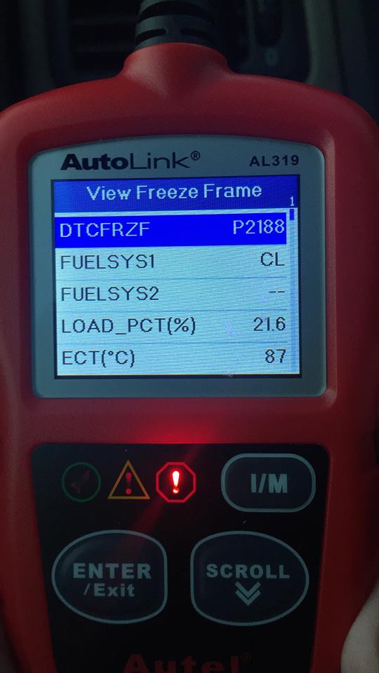

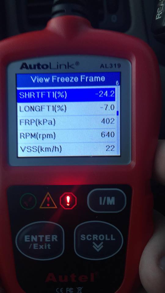

Can anyone make sense of this freeze frame data to help me pinpoint the problem?
Thanks!

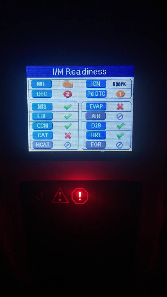

I am getting P2188 and P2178, and a pending p0442 code sometimes.
